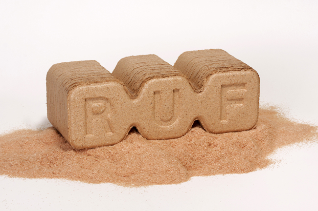

                    Yesterday got few wooden briquettes from a frined, fantastic thing.. it doesnt burnt with big fire, it fires loong with pretty stable temp. Will buy some packs today to continue curing.
                      #85
                      Re: 42" in Hungary by Slovak guy
                      G'day Alex
                      Those things sound like a good thing, a lot like burning charcoal, little flame but good steady heat over a long time .
