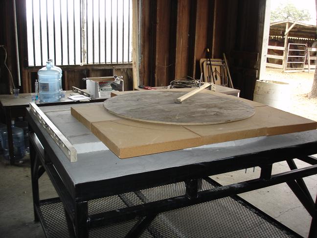

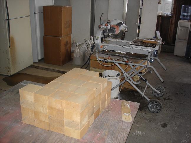

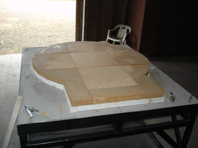

Thanks for all the input. Just finished my layout and cut the fire bricks for the oven floor and about a dozen bricks for the dome.
I decided to use the 18" x 18" fire brick for the vent landing and part of the oven floor and added a smaller 18" x 6" fire brick that will extend to the front of the vent.
I hope to have the floor installed today and start my soldier course. Any tips or hits?
