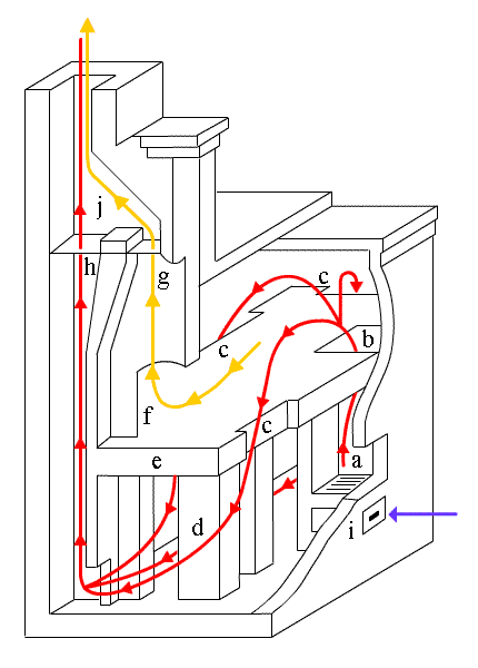

                David s: you are right with the ventilating flue, it divides a flow of gas from common inlet, but appliying "the Flow of gases" theory again, this situation is a descending gas divided flow, and this is a good design practice as things happens here for self adapting to good performance. In an oven derived from this theory, the teplushka oven, the oven chamber have even 3 gas exits at the hearth level that re-joins in an under hearth chamber, or bell, before a common flue exit. This way everything works fine.
                "Key
                a: Fire box
                b: Throat or in channel from fire box to bake chamber.
                c: Out Channels, from the bake chamber to the lower chamber
                d: Hearth support pillars
                e: Hearth
                f: Loading Opening
                g: Shut off Damper from the avaloire
                h: Shut off Damper from the under hearth smoke path
                i: Ash box/ air intake door
                J: Chimney
                Red line-- smoke path during remote firing. Yellow line -- smoke path during direct firing. Blue line -- Primary Air.
                Note: In this diagram the vault of the bake chamber is not shown"

                    Dmendo - You're right: this forum is a valued resource through individuals willingness to share knowledge, experience and ideas to evoke progress. Thanks for sharing the diagram of the Teplushka oven and how it it becomes 'tuned' via multiple damped intakes. I believe ovens are similarly tuned using a blast door during firing and and/or a damper on the flue during operation.
