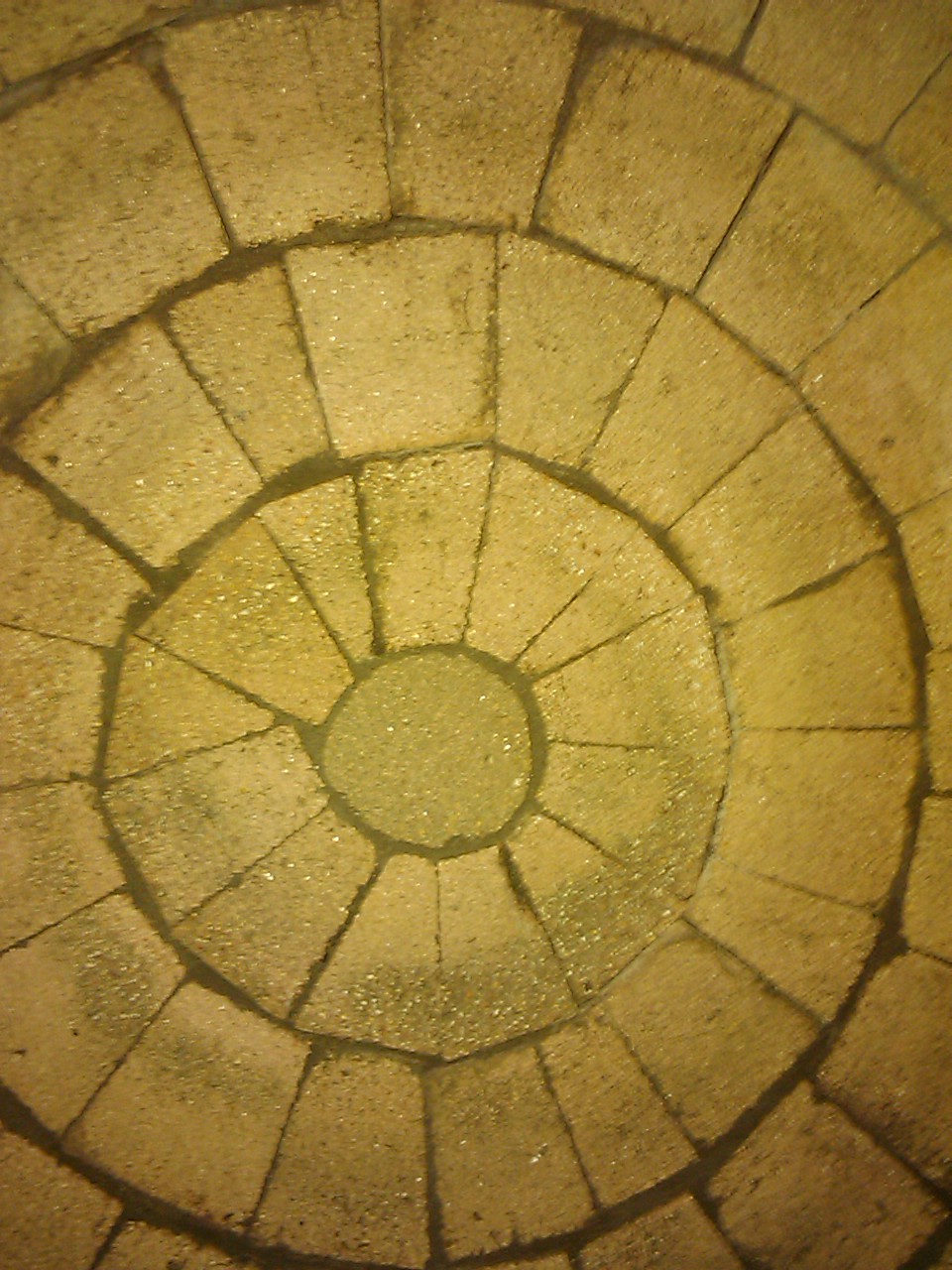

                          Taking time on this course, a little out of round with only one course plus a plug let so working hard to round up and make slope angle consistent. Since the IT is retired used a carpenter angle tool to check slope angle. Lots of tedious shave cuts, can't see for sure how good they are until I drop the plywood disk and don't want to drop until course is complete and set.

                            I admire the the tight cuts. I was lazy with mine and just tried to keep them tight to the inside of the dome. At the point your are in the pic, I already had the next disc placed. The platform disc just barely catches the edge of the previous course. I let the the outside of the course set down on the platform disc and the inside of that course set on the disc cut for the next row.
                            It may not be perfectly symetrical but, 1/4" (the stock that I had was 3/16") will set the angle pretty close.

                              My new home (dome). Here are pictures of where I have been banished by the SWMBO (she who must be obeyed). Wanted to clean and inspect the last course which was set with a plywood disk before moving on to the next course. Ground off a few high spots, tuck the mortar joints..... nasty, dirty, hot work. I think one more course then a plug
