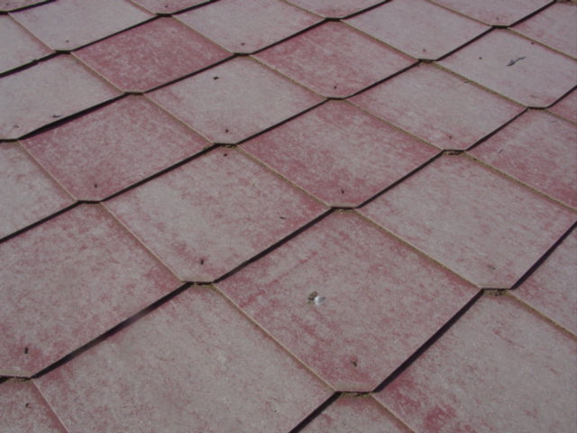

              Your shingles reminded me of my younger days, when after each storm, we would replace asbestos shingles that were damaged by limb falls. In those days it was important to keep the historic look of the old homes intact.
              I still have a stockpile of asbestos shingles down under the hill. But, there is not much call for them anymore .
