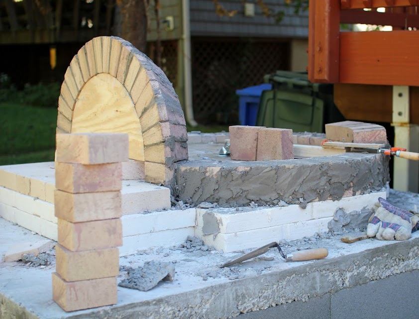

                              Picked up another 129 bricks yesterday (paid for 125 and got 4 rejects for free), and between last night and today, built my entry arch, mortared the rest of my soldiers, and started on my first dome course.
                              The arch involved a bit of frustration and heartbreak. Here's what I did last night:
                              Here's what I did this morning:
                              Here's what I did this afternoon (D'oh!)
                              And here's what I did this evening:

                                More pictures from today's work attached. The first two show an abject lesson in why you shouldn't mortar bricks together when you can't see all sides of the joint (even if it's pitch black on the other side because you're working at night).
                                One of the things which caused a lot of frustration today was the fact that my bricks are super absorbent, and when dry instantly suck all the moisture out of my mortar, seemingly irrespective of how wet the mortar is. The obvious solution is to soak the bricks (figured that out quickly), but this doesn't help when I'm mortaring a new brick to a brick that I set in place hours ago (for instance, the next course down). Is there any way to deal with this? Just more water in the mortar? I thought that I made my very first batch of mortar too wet, and have been trying to get the adjustment right ever since, and I wouldn't be surprised to learn that I still have it too dry.
