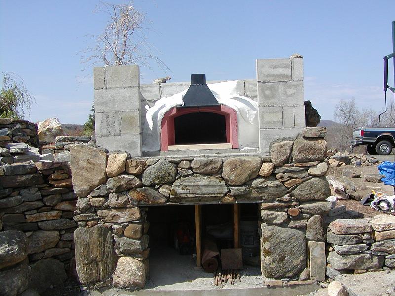

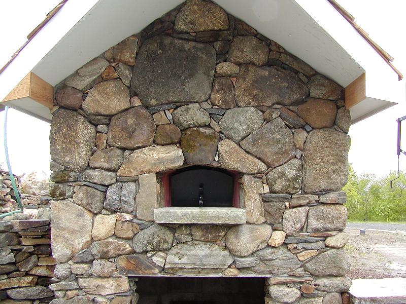

              Re: Block Stand Confusion?
              I used 4"x8"x16" (solids) for a similar reason. I needed more room for my stone veneer than the standard block allowed. So I used the smaller dimension block and everything worked out fine.
                [ATTACH]33900[/ATTACH]
                [ATTACH]33901[/ATTACH]
                Beautiful Oven! WOW what stone work!!!!!! That is a work of art, congrats and enjoy!
                  Thanks, but this was my first oven for a customer ( my best one ) 8 years ago...though I have gotten to enjoy it on occasion.
