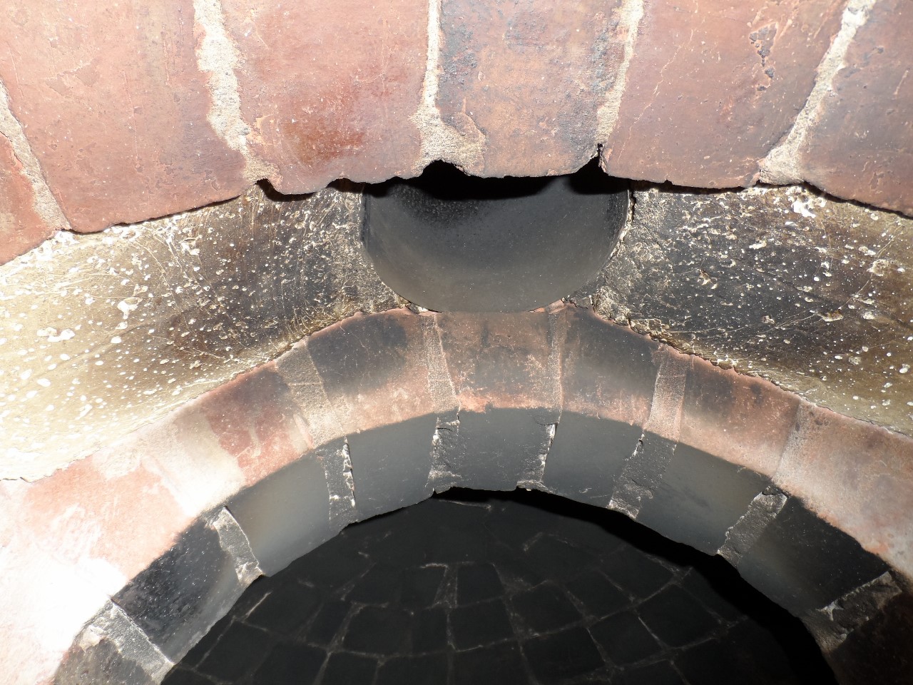

  • kstronach
    replied
    Re: Keiths 32" build in north yorkshire uk
    a couple more updates . . .
    got the flue set in place now. i shuttered the gap in between my front and back arch and filled with a mix of sharp sand vermiculite lime and cement angled into the flue.
Name:	003 (1280x960).jpg
    tonight i have insulated the dome, not as bad as i thought it was going to be! i ended up cutting triangles out and the pinning back together with bits of wire, worked rather well! ive got 4 inch of ceramic blanket, the last layer is abit patchwork in places and i had to use a little bit of rockwool to finish off as i had used every scrap of the CB!
    next step is mesh it over then get a render coat slapped on! went to the builders supply today and got a roll of chicken wire. i thought this would be easier to use on the dome than the proper expanding metal, however the exp metal is thicker gauge so the render has more to get hold of so to speak so i may now go back and get some of that instead! what mesh did others use and did it work ok?
    keith
Name:	005 (1280x960).jpg
    ps . . i know its not the most attractive flue but it was free so that works for me!!
