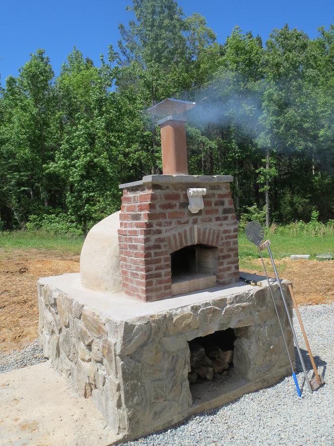

            I'm a neophyte, but, Les, brickie in oz , tscaborugh(sp?) and others will steer you right. I was slow and waited to build my outer archs and chimney before I started firings.
            As a result, I think my dome was curing about a month before any fire. That worked out really well. I started with really small and limited fires, following James at FB's instuctions. By the fourth fire, maybe up to 4-450F. My dome began to clear on the seventh fire, and then I added the blanket and started the stucco for the dome. Let it set a week before firing again. Not intentionally, just the way my schedule and weather allowed.
