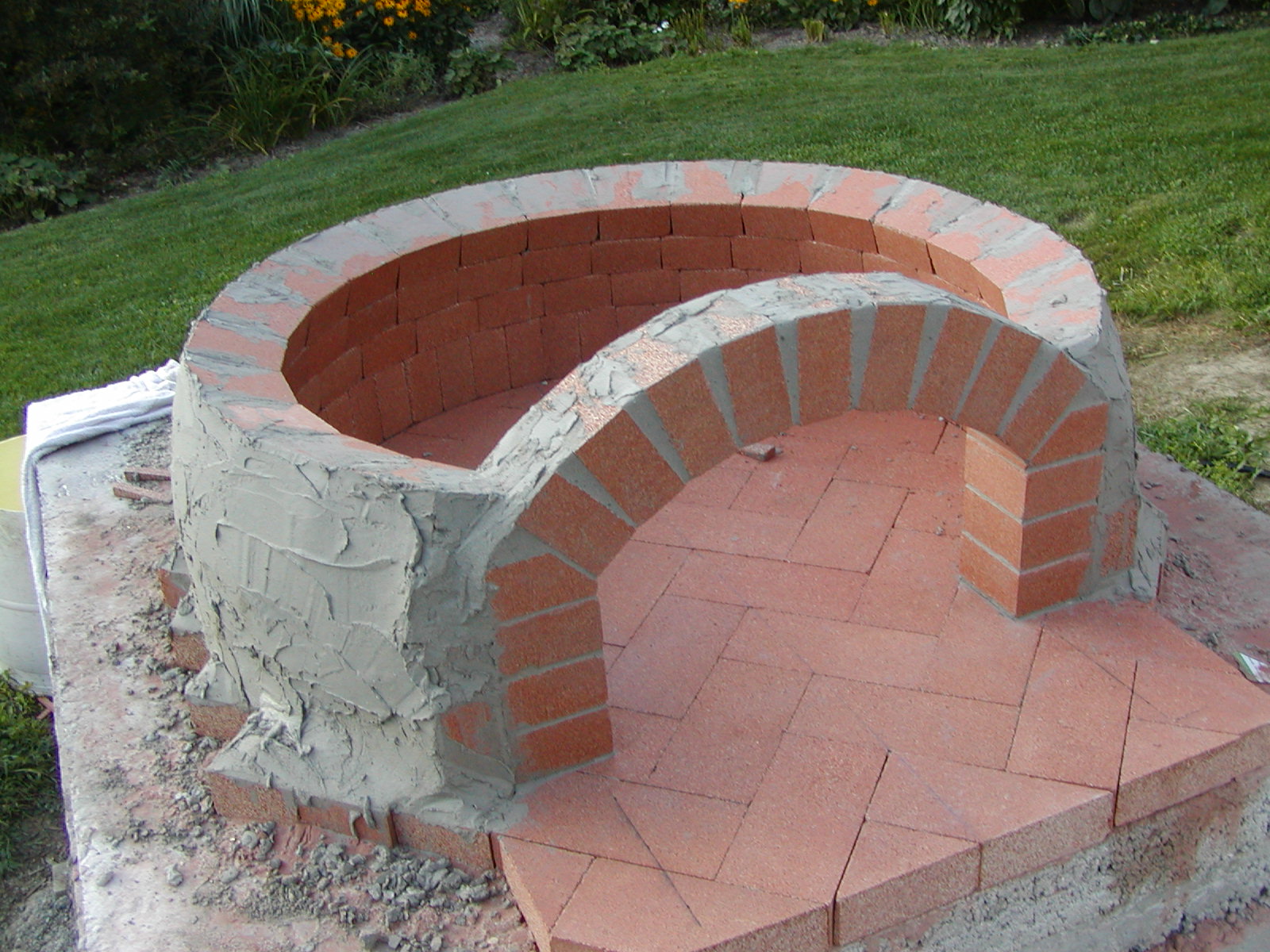

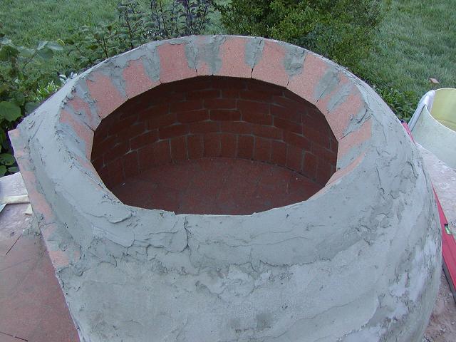

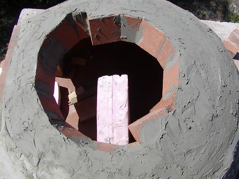

            I'm pretty sure that he is referring to the height of the dome, not the height of the oven opening.
            Also, the shape is just fine, and won't be any problem to get a round shape. I have done a couple oven openings like this ( high spring ) and like the above pictures, set the sides back into the walls of the dome. What this does, is provide the needed support ( buttress) that an opening like this needs.
            I have not seen many people do it, maybe because you lose a little floor space near the opening. You may lose that bit of space ( doesn't even matter) but you solve a structural issue with a simple solution without adding any additional masonry.
            Here are some pictures of the two recent ovens, both for my homes. It shows two kinds of arches, but both are set into the dome wall.
            High spring opening.

            I didn't need to do it for my current opening ( the arch is a modified equilateral) but it allows greater load bearing than without.
            Just another way to do it.
