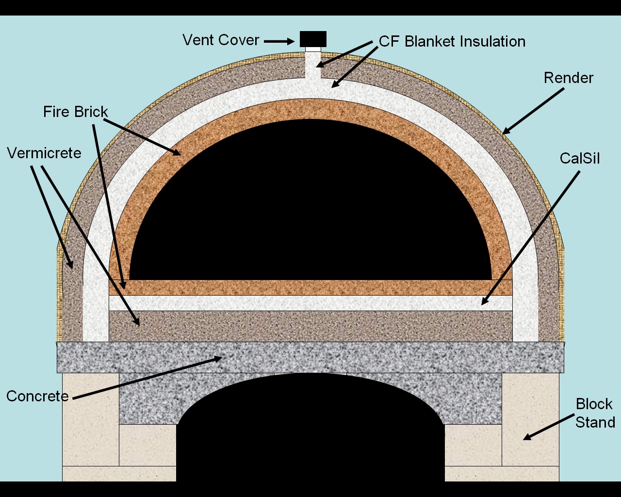

    replied
    Re: half brick igloo
    Originally posted by leetheldc View Post
    gulf what do mean about the vent on the dome apex please?
    The "apex" is the uppermost point of the dome. I drew this cross section of what I did some time ago.
Name:	Insulation and Vent.jpg
    I hope this helps. "Venting" is not a widely accepted practice. But, I would not build an igloo, without one
    Several of the ovens in the Jamie Oliver's link do look great! I am just not sure which one you are referring to. If I weren't working 14 hour days , I am sure I could figure it out .
