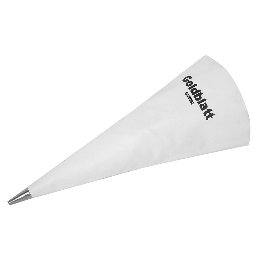

                    Lee,
                    Another inexpensive option is a grout bag, then you can use your regular brick mortar.
                      #295
                      Wow! That is really looking great, Lee. I love your selection of brick and you did a very fine job on placement..
                      I've never used a mortar gun. I did buy a mortar/grout bag once. It was bad about plugging up even with fresh mortar in it. The mortar had to be mixed too wet for my liking. I quickly gave up on it and went back to pointing. Pointing goes a lot faster than you would think, if you have the right hand tools and the right technique. I'll have to dissagree with Mike about treating this particular job like it were glazed tile. Brick are too porous for that. It will be extremely difficult to get all the mortar glaze off of the face of the brick. It will be next to impossible to get the mortar out of all those crevices that I see on your brick. Just point a section of joints with a fairly stiff mortar. It will take about 30 minutes to an hour (even more depending on the humidity) before the mortar in those joints will have set up enough for the final tooling. The mortar should then not smear and be easily swept from the face of the brick after tooling. You can keep working ahead just don't try tooling too green of a joint and don't let them get too dry before the final tooling. Don't worry so much about cold joints with mortar. If you have to do stop for the day and pick back up on another, it will be ok. Just make sure that you complete all the tooling and brushing of any joints that you had pointed before quitting time. I know that you want to see the finished product but, don't take what are percieved shortcuts. If you need a break from the project before pointing, take it. Time is not a real issue here. The job looks great just like it is. If some time has passed before you do the pointing, just use some compressed air or a paint brush to remove any dust from the joints.

                        Thanks for all your input guys I was only watching vids of the mortar gun not actual pointing I did purchase the gun but I scraped it after the the first load it was a great tool and the mix came out great but there was just not enough room too use it so I ended up with a 4 inch pointer and a brick trowel brick layer style 11 hours later with a few coffee breaks soon turned into beer breaks I got done at 10 pm well worth it though. The main reason for the gun was to save my back around the hard to get to part of the oven but old school methods beat new school hands down
