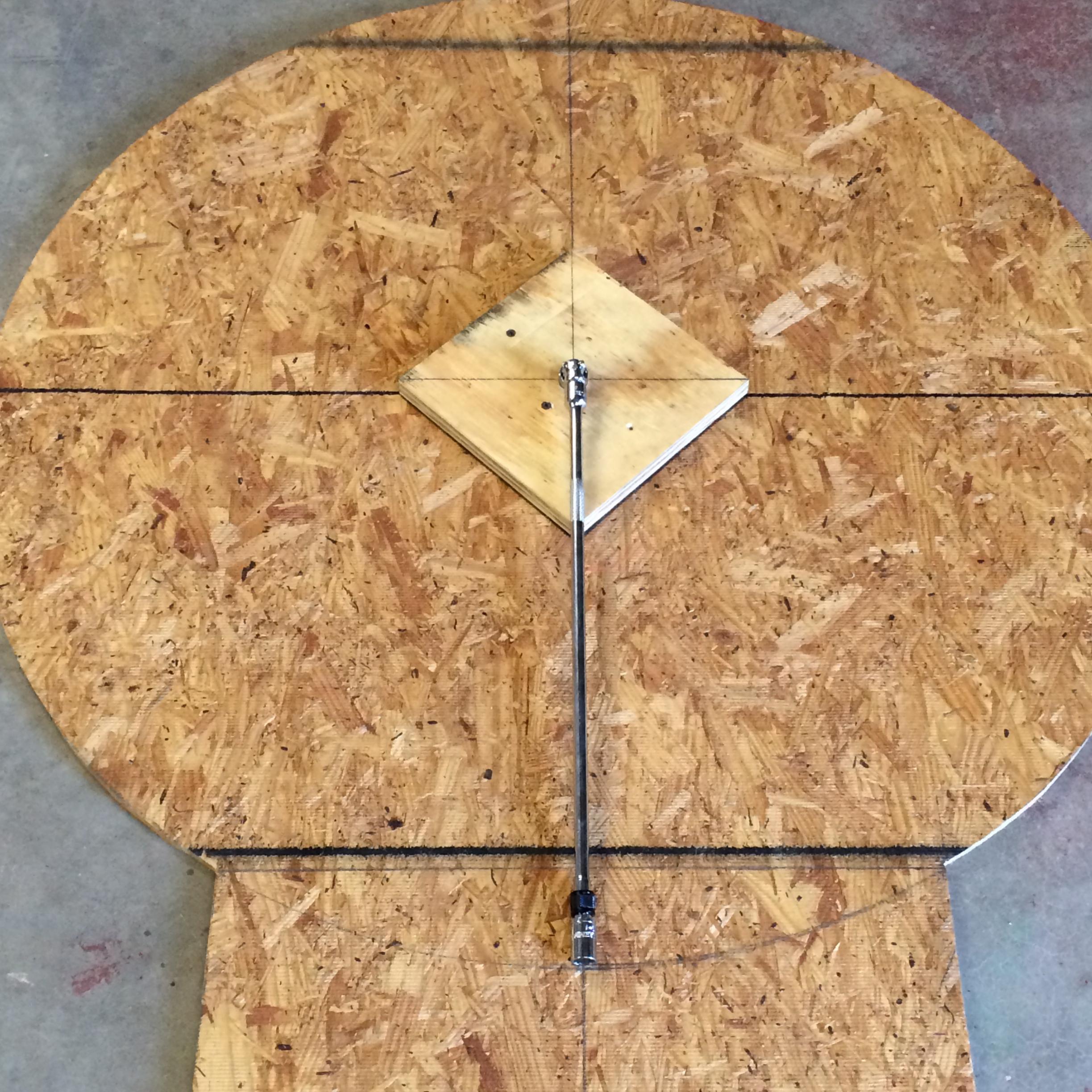

                          • rand18m
                            • Sep 2014
                            • 63
                            #58
                            Re: Just North of Nashville 42" Build
                            Thanks so much for the reply, I think I will cut them 5.5 leaving me an inch at the bottom, and I can see how cutting the angle in the arch joints would make it much easier than the complicated cuts trying to tie in the chains to the arch. Do you recall off hand how long your middle or longest pieces were in the arch? As in the keystone piece? Don't go to any trouble, just curious, I'll be able to figure it out when I lay them out and mark with IT.
                            I'll have to post some pics of my IT, my oven will be 38-3/8" as dictated by the IT. I made it with a 3/8 drive 18" extension and a 3/8 drive swivel. I will attach a socket to my angle iron piece and I set an 11/16" socket into the wood for the bearing, fits the swivel perfectly. Just bought some cheap sockets from Harbor Freight, and the extension and swivel I can always use. Actually only sacrifice the one cheap socket, and I can make other tools to fit the end using sockets as the attachment to the extension. If I can figure out how to post a pic I'll do so soon! LOL!
                            • rand18m
                              • Sep 2014
                              • 63
                              #59
                              Let's see if this works!
                              Here is the tool without the angle iron attached. I will weld the socket and angle together but for those without a welder epoxy would work fine, something like JB weld would do the trick.
                              I'll post this soon in a new thread for this build when I get fully started. Right now trying to find materials, not having much luck with calsil board. If anyone knows where you can buy calsil board in the Dallas Fort Worth area please let me know.

                                #60
                                There are several things that will determine the length of those bricks. I will post some more info on my lunch break.
