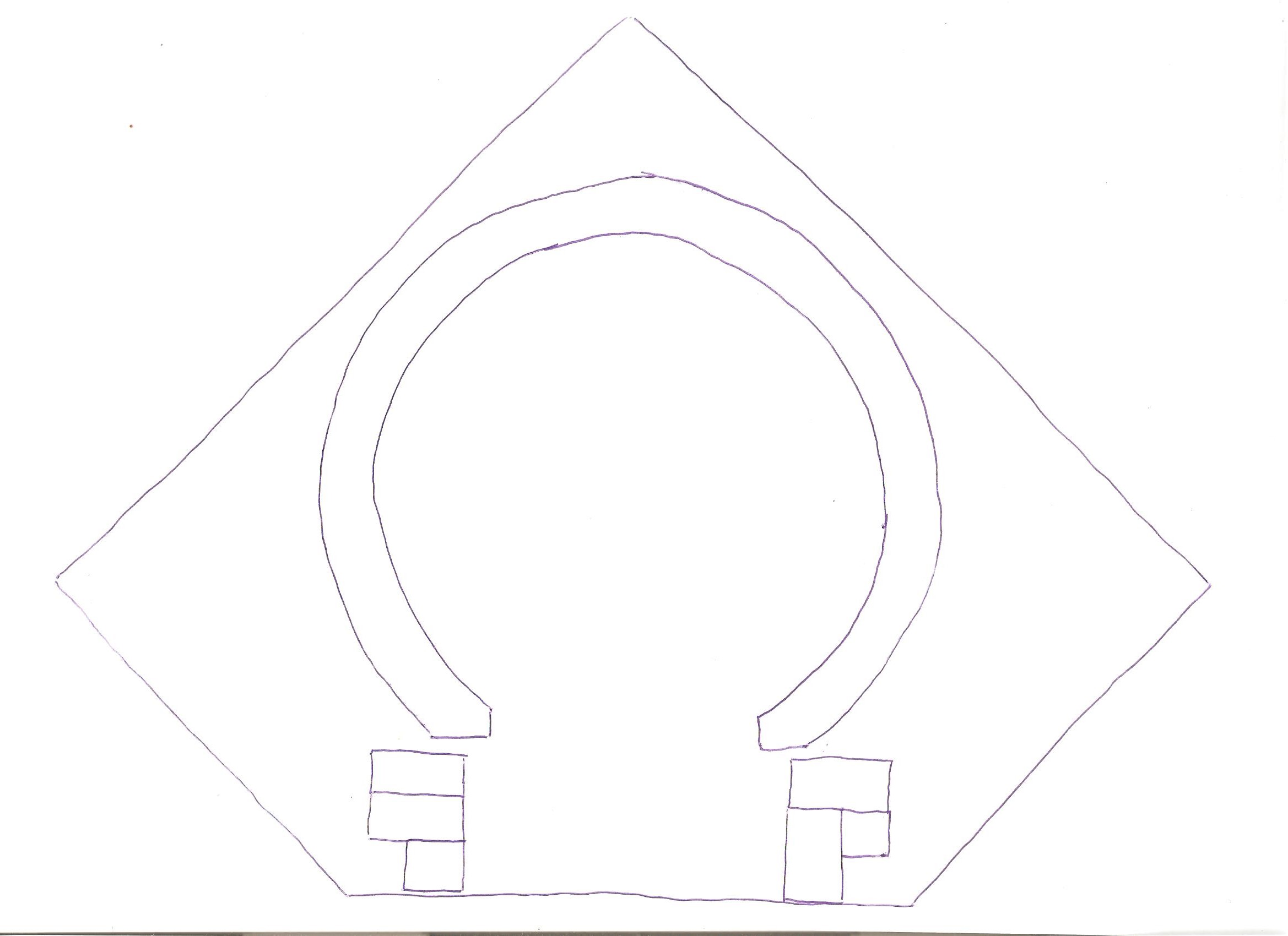

        I think a pic would come in handy about this time. I'm a little confused with the insulation board
        • hubert_s
          • Apr 2014
          • 135
          Re: Buttressing brick wall
          I have attached a sketch that hopefully explains the situation. Here is the color code for the sketch, in case it is not obvious:
          Green - Oven base
          Dark red - The brick walls for the entry, stainless steel vent goes on top
          Black C shaped things - Steel studs
          Blue - Insulation board
          My original plan was to have a 1" insulation board behind the entire length of the brick wall backed up by steel studs for buttressing. I realized the other day that there is not enough room for a 1" insulation board at the front of the oven base.
          My questions are:
          1. Is it ok to have galvanized steel studs in direct contact with the brick in the entry area, or will it get too hot? I think it's probably ok.
          2. The buttressing on the left and right of the walls only prevents them from falling one way. Do I need brick ties connected to the studs to prevent the walls from falling the other way? Or will the stainless steel vent bolted to the top row of bricks provide sufficient support?
          I was hoping to finish it before heading to Australia on Monday to give the mortar time to cure while I am away, but I don't think that is going to happen with the soccer game tomorrow.

            Yes a pics worth a thousand words. This shows what I was trying to say before. If you brick it like this it should bond and give you a strong structure for your metal vent to sit on. You should then still be able to fit the walls of your enclosure in as well.
            I'm sorry but I cannot see how a steel stud and insulation being rigid enough to hold a single brick structure. Unfortunately you'll probably crack the mortar trying to drill holes for the tapcons.
            Anyway that's my thoughts on that
            Regards Dave
