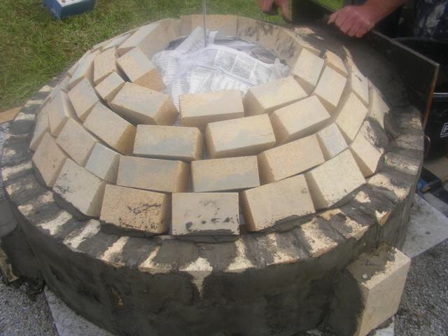

      No this is not my oven but a pic of a fairly typical Italian style pizza oven and the typical method used to construct them
      Notice the bricks are stacked into position then the mortar is poured into the gapes . Not many fancy cuts in there and once the mortar gets its first set the sand mold is dropped and the newspaper is cleaned away.
      Once that last brick is in position the mortar isn't the glue that keeps it together but rather the spacer that keeps the bricks orientated onto a dome. Gravity forces down on the dome making it a strong structure.
      Point is whichever way you complete you will have a dome and it will be one of the strongest structures.

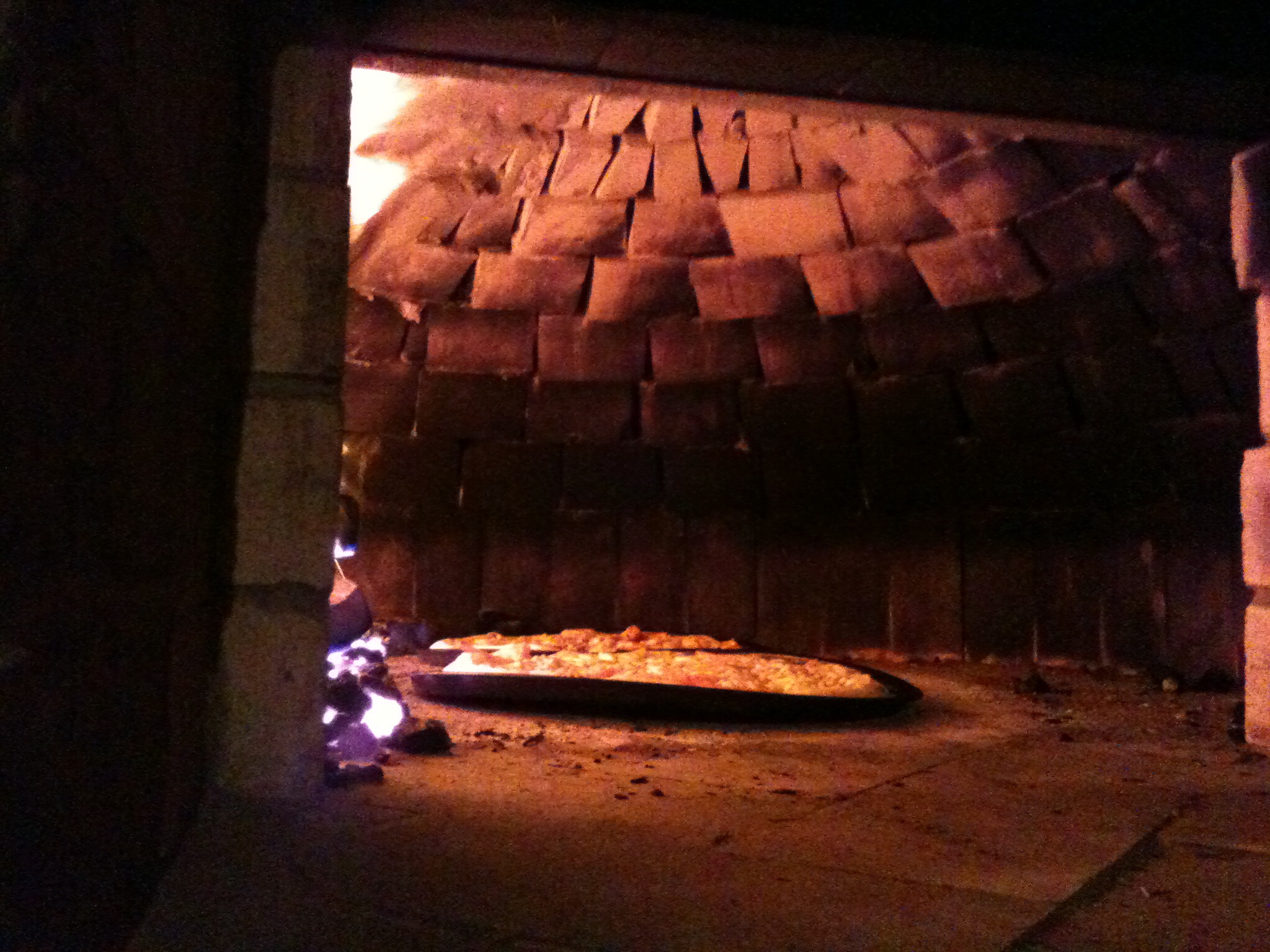

        Yes this is my oven, old pic , but you can see the brickwork is less than perfect .
        4 years of pizza, plenty of bits of cow pig etc have gone through without ill effects
