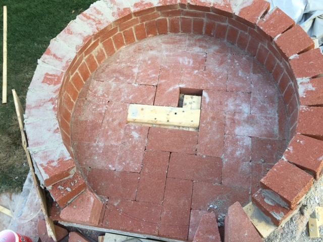

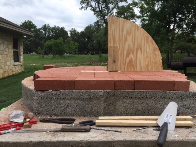

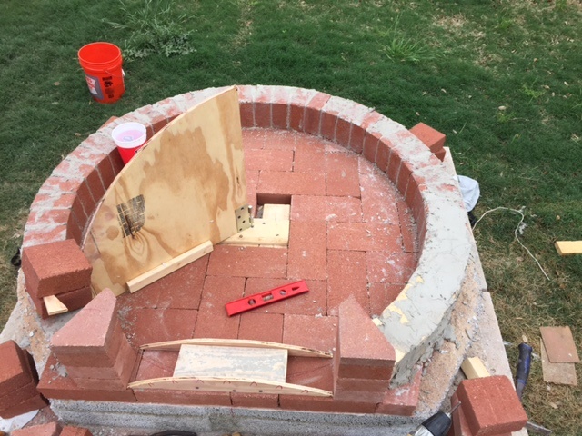

    Okay. I have made some progress, even with the rain.

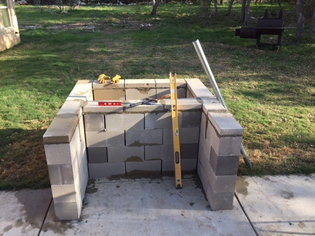

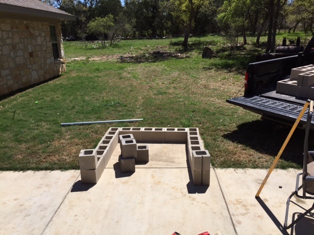

    Got started 3 Saturdays ago laying out the dry stack block work. I filled every other core with concrete the following week. I also set the form for pouring the hearthe base slab during that week.
    The next Saturday I was able to pour the concrete. During the following week, I was able to put down the Perlcrete, 6" with a 1" of Homebrew mix inset.

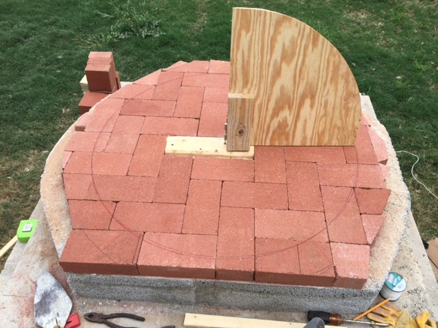

    Rain screwed me for this past weekend but was able to cut some brick, lay out the door and install the first chain of brick.
    Details:
    40" inside diameter
    Homebrew mix of 1 Lime-1Portland-1Clay-2 Coarse Grog-3 Fine Grog.
    Dooe openning expected to be 11.5"X 19"
    Dome height 19"
    I am using an Old School Guide rigged with a hinge bolt that fits into a 2X4 inserted with a bushing to rotate the hinge around.
    Here are a few pics of my progress:

      Looking good. I use the same type of form, but do not anchor it, just use it to check as I go.

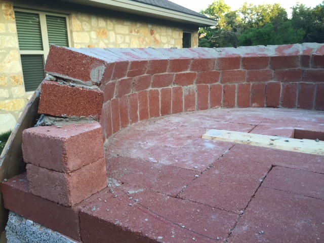

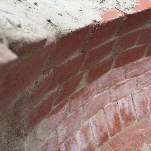

        Thanks Tom!
        I got a couple hours in this afternoon and completed Chains 2 and 3.
        Next up will be putting the entry in and them taking it on up.

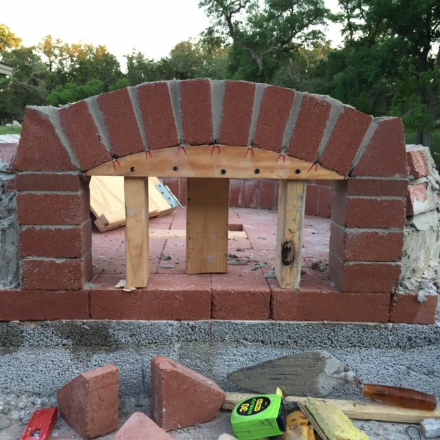

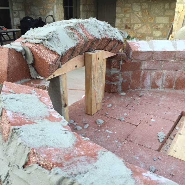

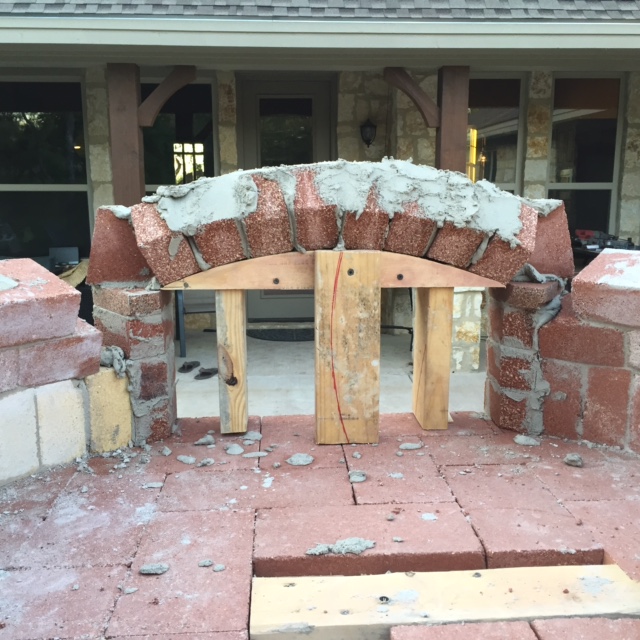

          Looks good. I would definitely get the arch in next. It is much easier to be able to figure out the cuts that meet the arch when you have the visual. Also will help you avoid the droop at the arch

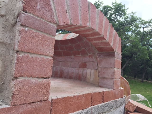

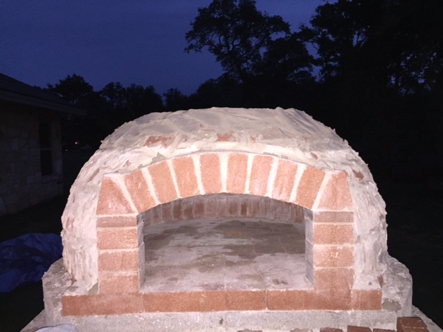

              Entry Arch completed this evening.
              Probably will not be able to do any more on it until Saturday as rain is expected to set in tomorrow evening.

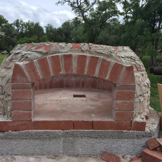

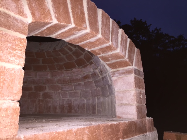

                    3 more coarses and I am over the door!

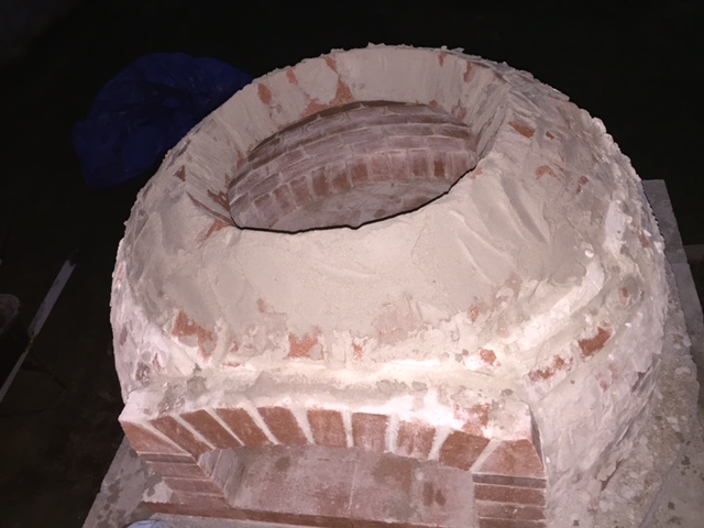

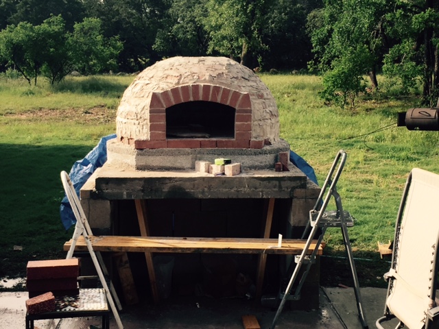

                          Two more chains after work today. Getting really tricky with the current slope of the chains. I hope to have the dome done by this weekend. Barring travel and rain.

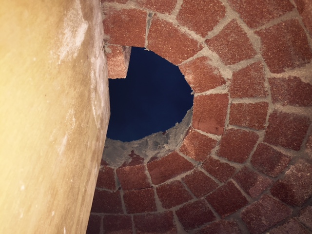

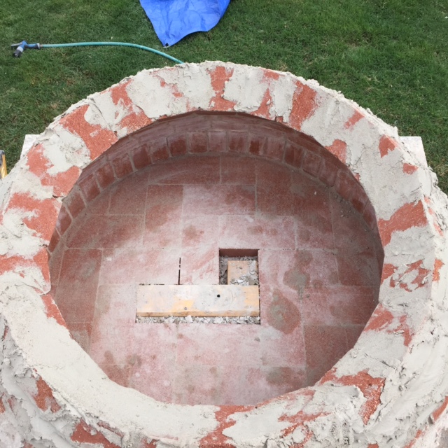

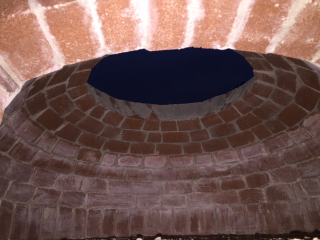

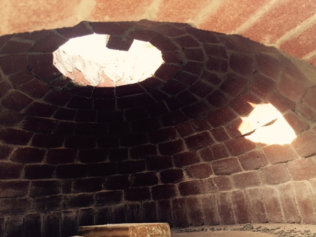

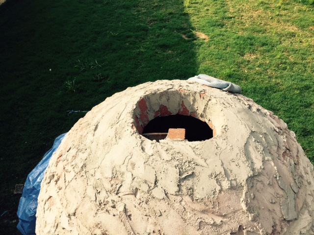

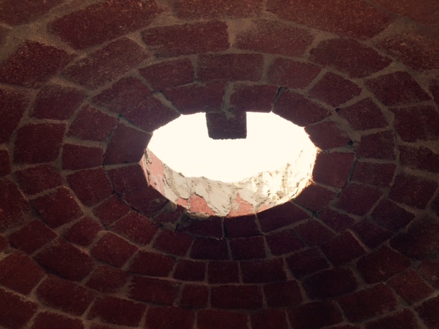

                              Getting close to closing it in. Two more chains finished last night.

                                That leading single helps, doesn't it?
