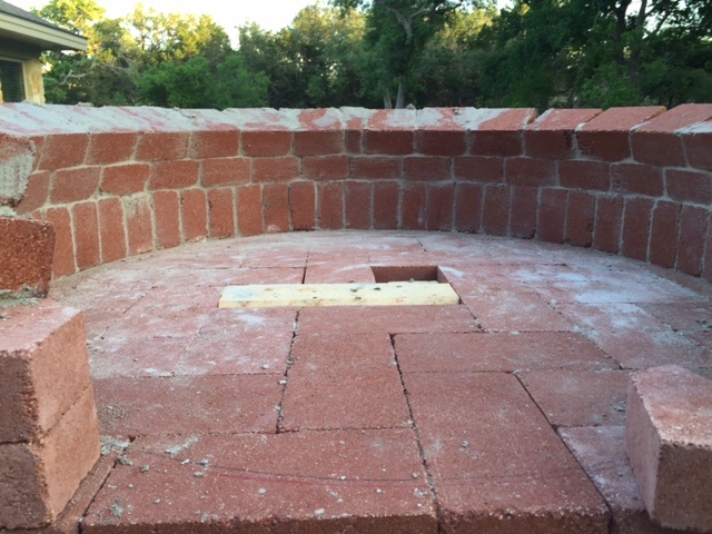

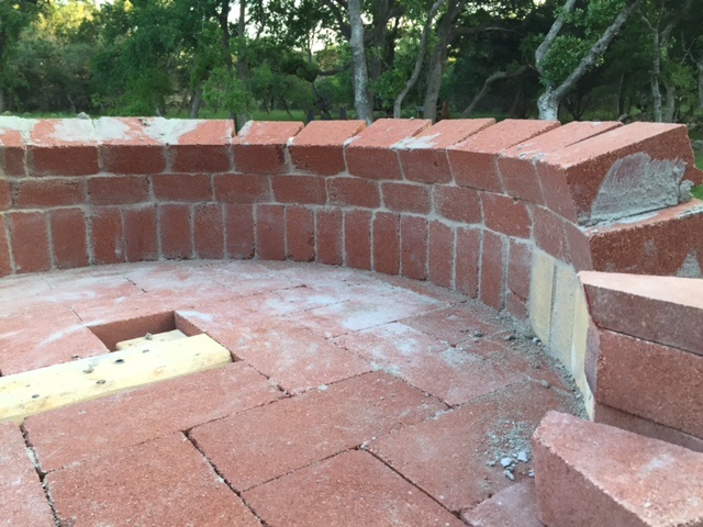

    I got a couple hours in this afternoon and completed Chains 2 and 3.
    Next up will be putting the entry in and them taking it on up.
    Pics below:

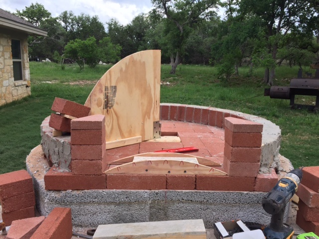

    Okay. I have made some progress, even with the rain.
    Got started 3 Saturdays ago laying out the dry stack block work. I filled every other core with concrete the following week. I also set the form for pouring the hearthe base slab during that week.
    The next Saturday I was able to pour the concrete. During the following week, I was able to put down the Perlcrete, 6" with a 1" of Homebrew mix inset.
    Rain screwed me for this past weekend but was able to cut some brick, lay out the door and install the first chain of brick.
    Details:
    40" inside diameter
    Homebrew mix of 1 Lime-1Portland-1Clay-2 Coarse Grog-3 Fine Grog.
    Dooe openning expected to be 11.5"X 19"
    Dome height 19"
    I am using an Old School Guide rigged with a hinge bolt that fits into a 2X4 inserted with a bushing to rotate the hinge around.
    Here are a few pics of my progress:
