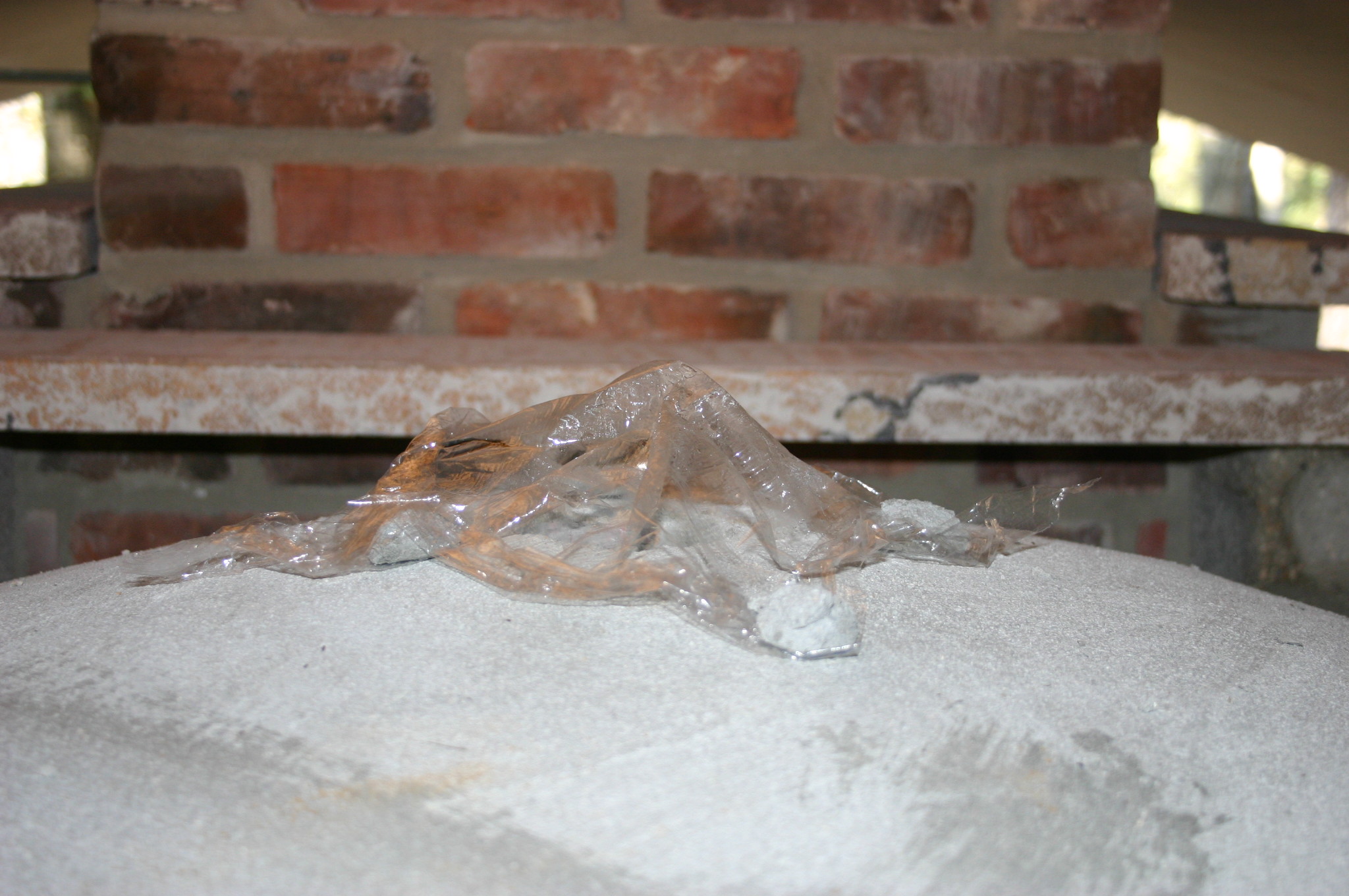

              At the very least, don't seal those outside cracks until you are sure that all extra moisture has been eliminated. You can see steam escaping, but only in massive amounts. Use the "clear plastic technique by David S to ensure that it is completely dry.

                  Any clear plastic that you can place over the dome will do. It allows you to see the water droplets forming underneath the plastic from steam condensation during firing. This is a pic of a piece of plastic (I think it was part of a dry cleaning bag) placed over a vent hole that I had purposefully left at the apex of the dome. The shell will be hotter in any area that has not fully dried. In my case, that area became an increasingly smaller area at the very apex of the dome. When it was totally dry, the entire outside shell was closer to ambient temperatures. I'm not saying that you don't need more insulation. But, I would keep the drying fires going until I was sure that all moisture had been driven out.
