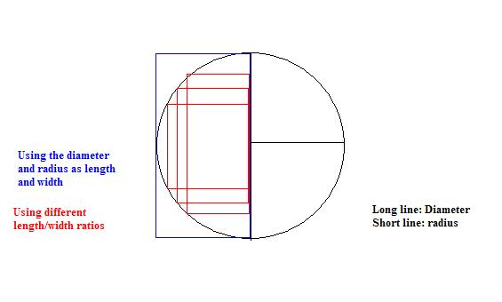

            After a couple of weeks of bad weather finally got started on the framing for the hearth. Measured three times and still had a wrong measurement for the plywood base. In dividing the overall area in to 2 equal rectangles I ended up with 2 rectangles that would only cover half the area.
            Luckily I picked up the mistake before getting the hardware guy to cut it for me so I've left that for another day after I recheck the measurements.
            Measuring three times cutting once is a good idea but it looks like I need to do a bit more.
            Anyway, got it half done today, hopefully the weather holds and tomorrow I'll get the frame finished and start calling friends to help pour the concrete and vermiculite.

              Okay, I'm not clear on how you're calculating this thing. If you're trying to derive the area of your rectangles from the area of the circle that's where trouble started.
              If you want two equal rectangles to overlap the oven then measure the diameter (length) and width of the oven. Multiply the length by 1/2 of the width (actually the radius). The result will be a rectangle that overlaps the exterior and is half the width of the oven. (In blue on the diagram).
              If you want two equal rectangles that fit inside the oven you need to decide how you want them to fit. From the side touching the oven walls measure the length you want then measure the distance from the point touching the wall to the centerline of the oven. (In red in the diagram). You can adjust this to whatever dimensions you want - you might want to use a piece of cardboard to better visualize how the thing will fit. (In the diagram I used more than one possibility - all are rectangles, however). Then have two of them cut.
              Basically, if you want them to fit inside it requires eyeballing then measuring. The area of the circle really won't help you much - it's the area of the rectangle that you need*.

              Hope this helps! If not, forward any complaints to: www. quitannoyingme. pht**
              *You can get closer using the derivative but who wants to do calculus? If you're trying to maximize the area then you'd need to do that - I'm not so good with calculus...
