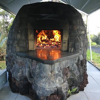

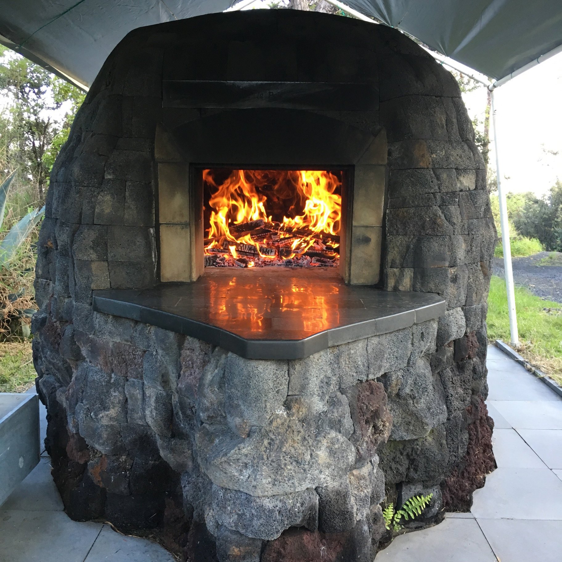

                  Click image for larger version  Name:	Woodfire Oven 1.jpg Views:	1 Size:	658.1 KB ID:	402077 Re: Cinder and basalt in oven construction
                  I completed a Portuguese Wood fire Oven in two years using mostly basalt Lava rock. I cut all the stones with a pearl diamond blade with a flush cut adapter. The blue rock cuts surprisingly easy with these blades. I used 9" x 4 1/2" X 2 1/2" fire brick for the oven floor (hearth). The basalt rock is moderately porous and has properties close to soapstone which has at least a 3 to 1 ratio over fire brick regarding heat retention properties. This rock is available here on the big island very cheap. I did have to coat the inside of the oven with refractory cement to keep the basalt bricks from chipping out. I did try using the nonporous basalt for the hearth but it started to crack and chip out after a few firings. The decision to change the floor or hearth with fire brick was necessary and has shown no signs of wear or degradation from repeated use over the last few years. The refractory cement coating (about 1/2" thick) inside the oven (walls) has held up very well too.
                  Dave
