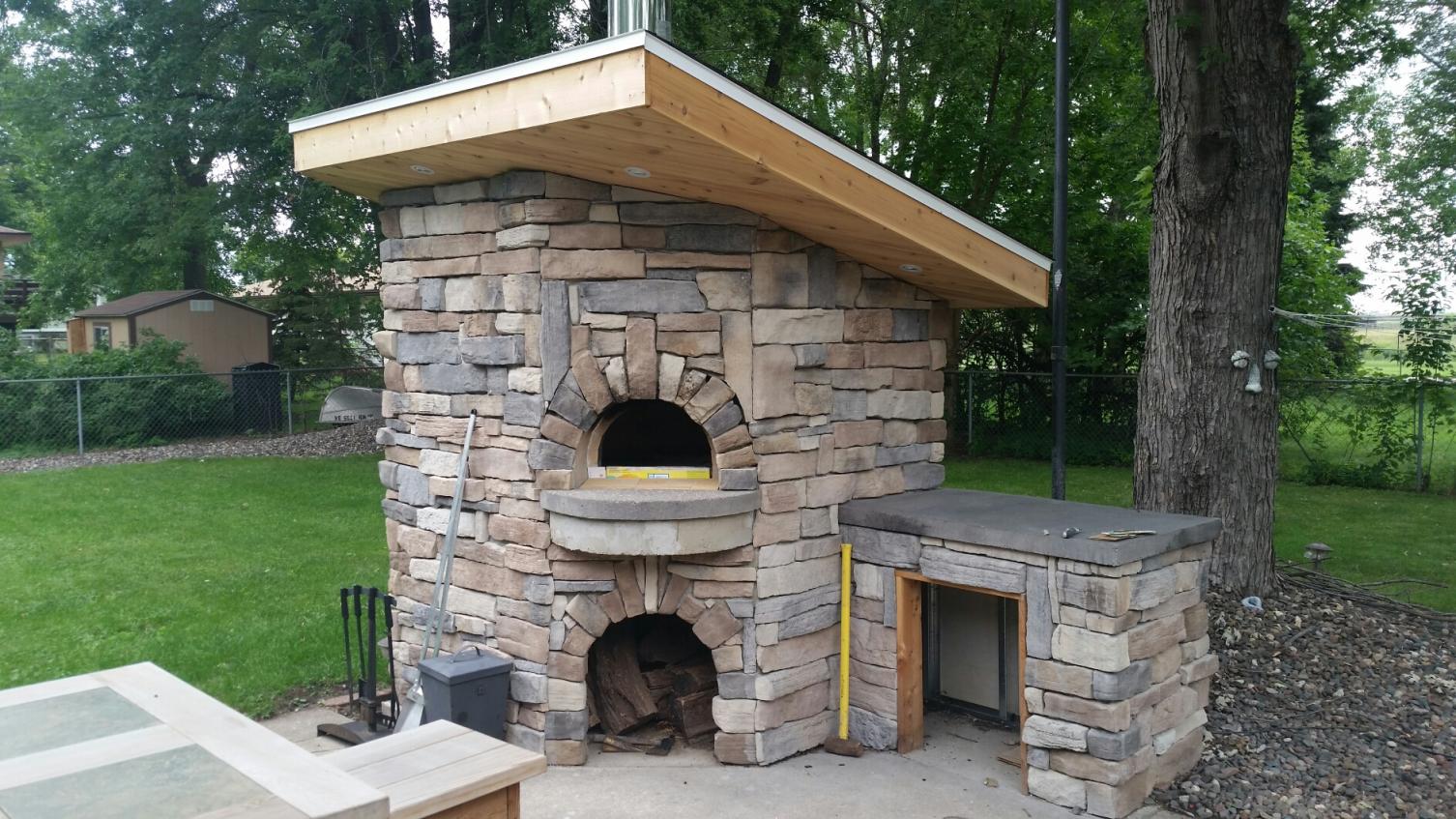

      You will find extensive debates on this forum about whether or not to pour foundations below frost level or settle for a slab. Many guys will say that you must pour foundations regardless. Some will argue that if you're not planning a large kitchen installation that spreads out over a large area and are not attaching the oven to another structure, then a stand-alone oven will do fine with properly prepared ground/gravel/rebar setup. I live in Minneapolis and chose the slab option. I dug down 12", placed 6" of class V compacting every 2" and poured a heavily-reinforced (mesh and rebar) 6" slab. Now, I haven't gone through my first winter yet, and I'm not even done with my oven, but I'm sure that if this sucker moves, it will move as a unit. If it moves and doesn't move back to level, then I will regret my choice. But I've got a large patio with a similar prep and I haven't noticed any heaving that doesn't come back to it's original place.

        I also live in Minneapolis area and went the slab route . I went 12" thick all the way around the edge and 6" deep for the rest, and lots of rebar. I also have not done my first winter but am not worried about it. Good luck with your build. I am almost done with mine.
