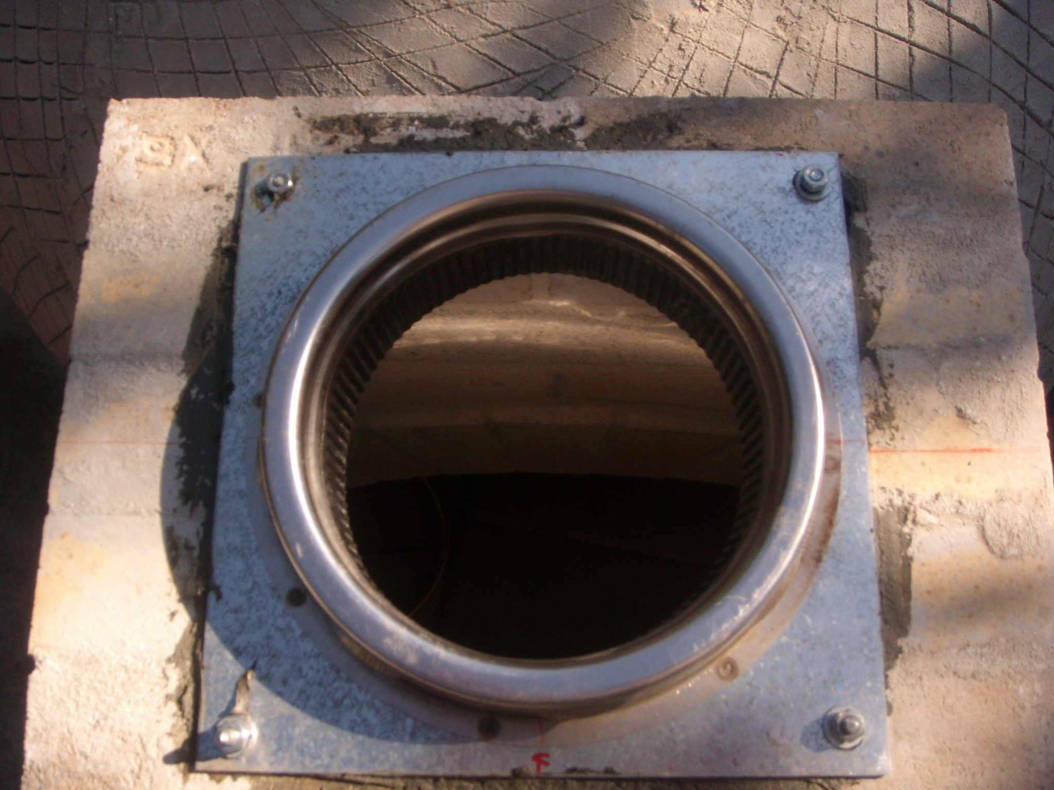

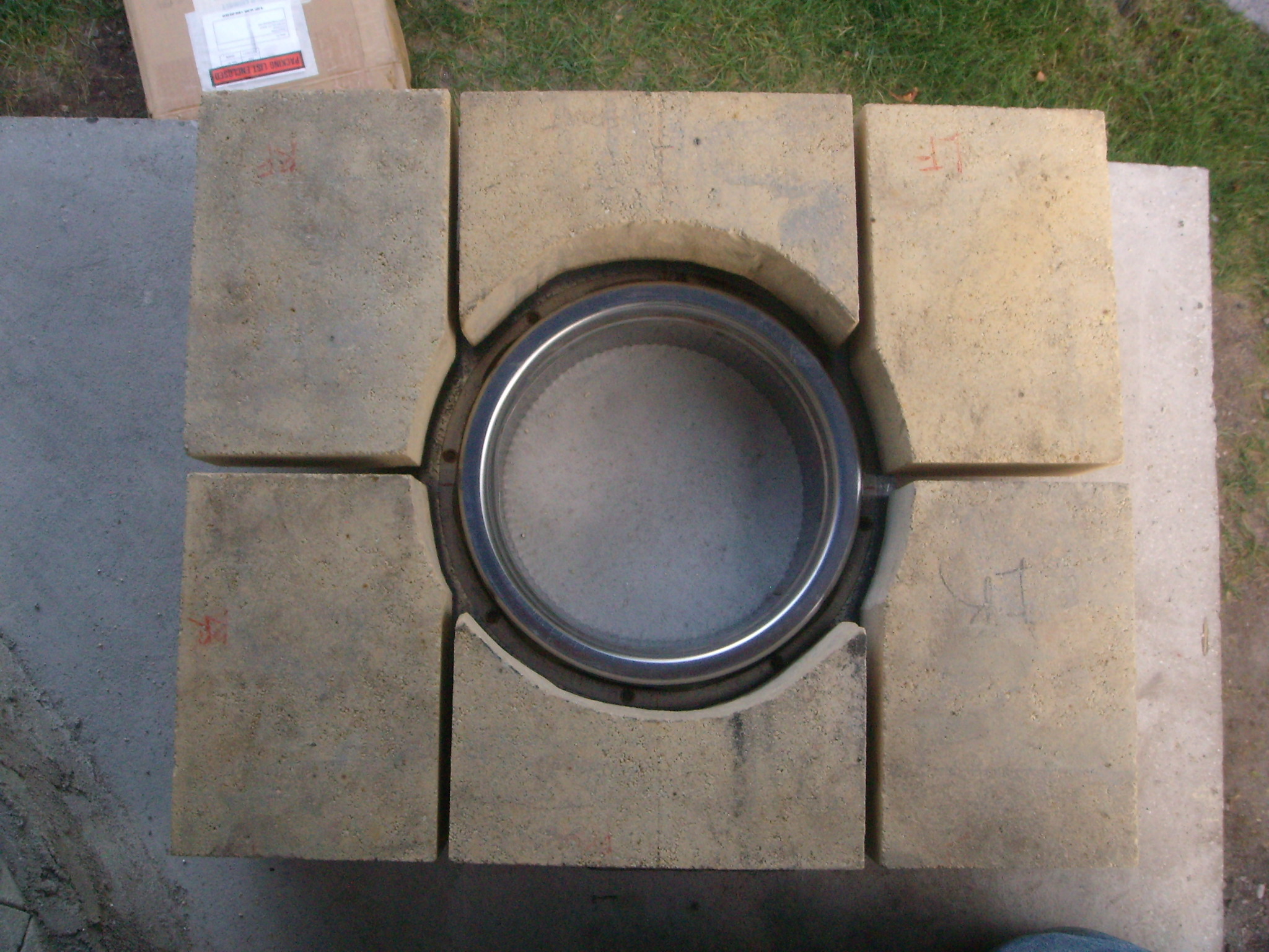

    Should the Chimney anchor plate be mortared and screwed in place? or screwed and use some type of high temp sealant under it?
    Member *********
    • 5256
    I used 1/4" concrete expansion bolts with high temp refractory caulking under the plate and capped with another layer of brick. Click image for larger version
