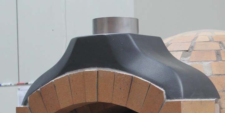

    Can I use a regular concrete mix to cast a flue gallery over my outer arch for my chimney pipe connection or do I need a castable refractory mix?
    Is there some sort of home-brew I could use if I need a refractory mix? I've attached a photo of a flue gallery. Mine will not be so elegant

    No, normal concrete will fail there, it's too hot. You need to use either castable refractory (best) or homebrew 3:1:1:1 sand, lime Portland cement, clay (second best)
