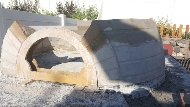

                      I was able to complete another chain today. It took longer than I anticipated. Getting the side bevels of each brick correct took some extra time. I also noticed that my last chain that tied into the arch wasn't completely round because this chain I finished tonight has a small lip that hangs over the archway on the inside of the oven. It's hard to describe but I posted a pic of it. It hangs over about 3/8" at the most. Is this going to cause a problem?

                        Nice work. you could take to it with an angle grinder. but I would be careful so as not too dislodge, or lay a few more rows then try.

                          That will not cause any problems, I wouldn't bother trying to fix it. Best thing: you'll never see it after you close the dome
