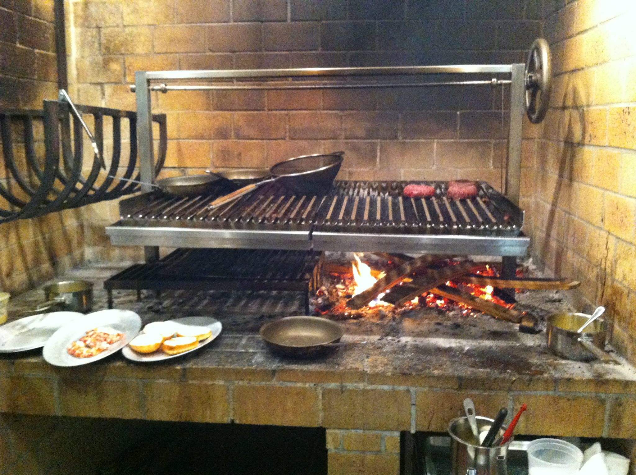

        I know it doesn't fit your description of simple but, if I were the cook (for the varied types of cooking that you describe) I would want something like a hearth stove and a very small pizza oven to the side in the same compartment. My daughter took the below pic of hearth stove and a WFO yesterday at a renaissance fair in Louisianna. Bauldy 2's post of an Argentine grill looks a lot more modern.

          I was thinking along the same lines... a modest oven and a grill would be much easier to work with imo. I'm just building a 48" model; it is pretty big for pizza - too big, really, but I wanted the size for baking bread and other stuff. Even so, I'm not sure I would want to be trying to cook pizzas and burgers in it at the same time, and stuffing a kettle in there would be too much trouble for my liking.
