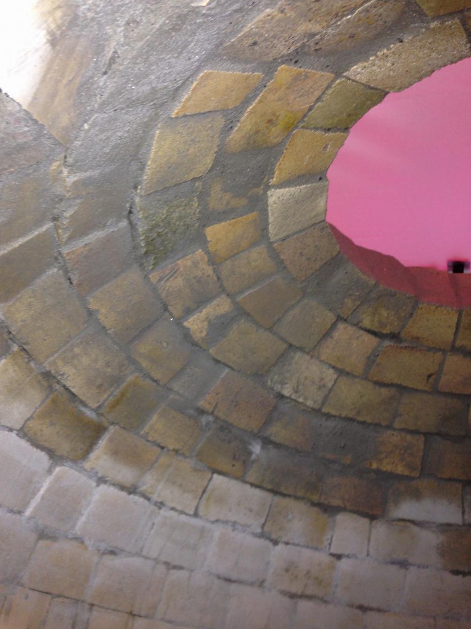

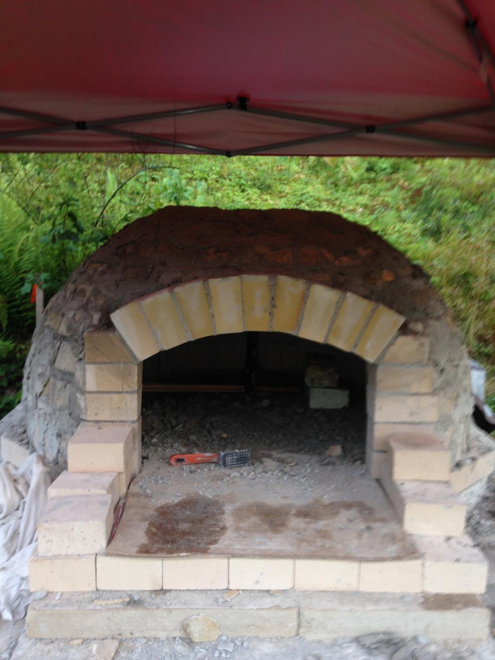

                  I'm not nearly an expert by any stretch of the imagination but mine started out perfectly round and, whether it was due to bricks slipping or my IT moving without me realizing it or who knows why, I had variations on almost every course I did here and there. My IT is easily adjustable so I am constantly adjusting it by 1/16" or 1/8" as I go around in order to make the bottom edge of the course I'm doing flush with the top edge of the last course. Other than some of the perfectly cut and placed domes I've seen on here, I think us amateurs will end up with a little variation but I'm told it won't make a bit of difference. My dome with only 2 courses to go (see pic) looks round and hopefully will cook some great pizza and I'll be the only one who knows how imperfect it really is.
                  I wouldn't sweat it
                  Marc
