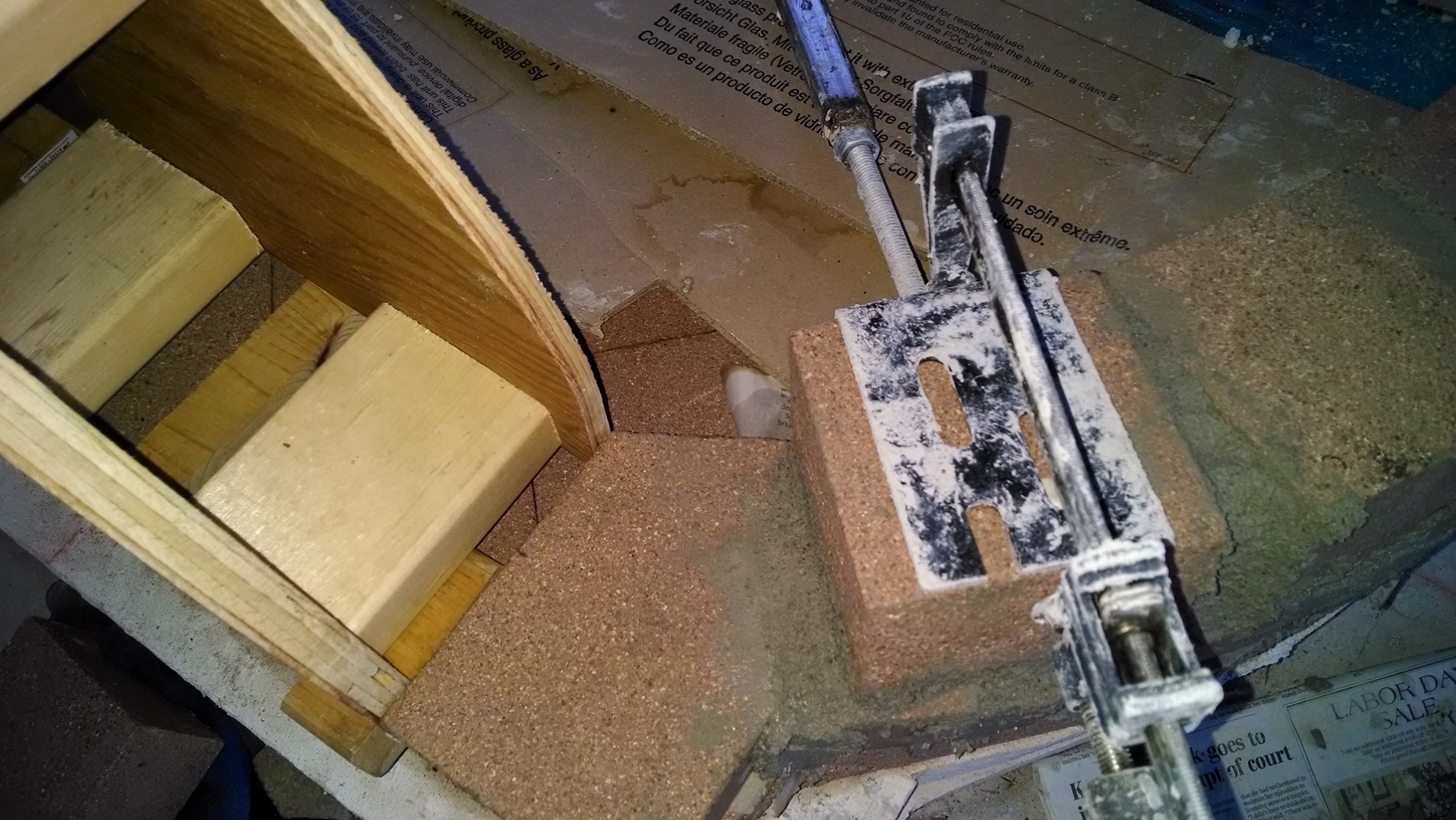

        I have builders block. i know you can build the arch while you build the dome and my plan was to do that until i got past the straight sides of the arch. my plan was once i got to the curved part i would just finsh the arch then continue the dome. I guess what im asking is im butting the dome to the form then cutting a triangle piece for the front for the reveal. is this not right and should i take out a few brick to do something else.

            Hi Chach,
            Yes you will need to remove the bricks from each side of the entry and replace them with bricks similar to the ones in this picture, then but up your course bricks keeping the side arch bricks flat,
            if you continue to go up with the course bricks when you are ready to start the arch you will not have a flat surface to start from, the arch needs to stand alone with the dome butting up to it, then tying in when you start you arch.
            Sorry for the long winded explanation
            Cheers
            Doug

              That's how I originally had it but took it down because i was looking at the reveal ...so the flat part stays next to the form then the brick in front slides over a bit for the reveal correct?

                Here's another, more messy, view of a first course with the inner arch started. As the dome progresses the bricks on each side of the opening move inward and upward following your arch template, and if you have the proper fore/aft orientation, the bricks will get longer as the dome "pulls back" and the top dead center brick will almost be full length.

                  JRPizza's picture is a little less confusing than mine, that first brick on each side is the door arch the reveal is created when you build the flue arch

                    As some of the others have said be careful if you prebuild the arch ahead of the dome walls. I did that and ended up with a tear drop shape and had to fix it. It was not a big deal but needed tending to. I didn't realize the dome pulled back as it went up.

                        ok so this what I'll on both sides...stacked up mortar joint and the side facing the oven i beveled to match the angle of the course (chain) so it has the same angle as the brick next to it and continues up the arch..

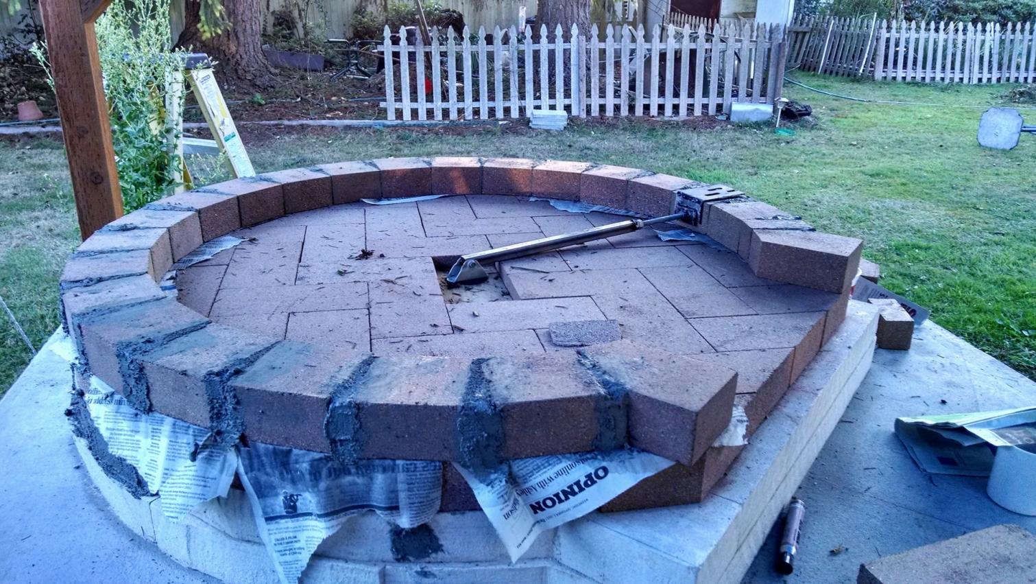

                                Well in my limited time today i was able to finish the rest of the second course the whole third course and about a little more than a third of the fourth course. I cam noe see the dome starting to form and I'm getting more and more excited. I tell you it's the little things in life.
                                My Build Pictures
