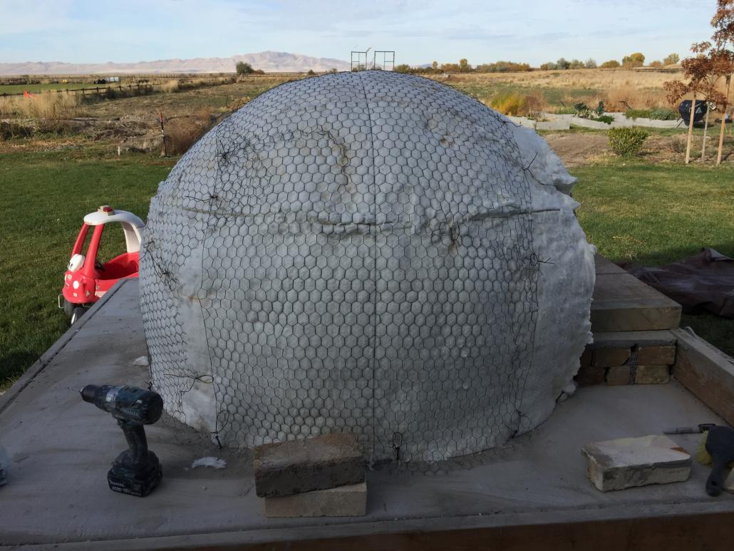

Was running two halogen work lights in the dome and it was getting around 220 F but thought it would probably be best to give the mortar on the keystone some time to cure before drying it out to much so I turned them off yesterday. Fiberglass gasket should be delivered today so I can move forward with the entry and chimney transition. Used a hammer drill and concrete screws to secure the chicken wire.

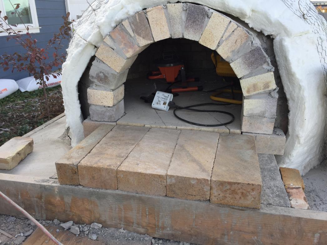

Friday night I got my dome closed up then Saturday morning I wrapped the CF blanket over the dome and then placed chicken wire over that. I also cut out L shaped bricks for the entry tunnel that I will use fiberglass rope gasket for thermal break. I dry fit the entry arch and have a question about mortaring. My diamond blade is nearly useless now and I dont want to purchase another one so I dont think I will taper my entry brick for the entry arch. Instead I will have wedges of mortar rather then a consistent mortar gap. Can I dry fit the entry arch then tuck mortar with the brick in place or am I asking for problems doing it this way? Seems I can keep the brick angles more evenly spaced by leaving it all assembled with some little wood wedges to keep it all uniform. If I take all the brick apart and then mortar and place each separately I dont think I can get it to turn out as clean and even.

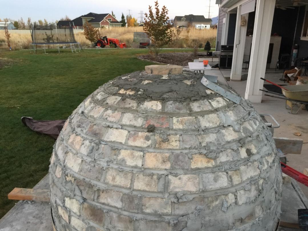

waiting for my last course of mortar to set and shaping my keystone to fit. Igloo should be complete soon. Used a piece of soft cardboard and a crayon to transfer the shape of the opening to the firebrick.

I think most fiberglass rope is rated to 1000 F and is probably less expensive than ceramic fiber rope, so plenty good for where you would be placing it. I used ceramic fiber just because I had it available. Thermal K values are similar. Your choice as long as temperature rating is high enough.Last edited by UtahBeehiver; 10-22-2018, 03:44 PM.
Leave a comment:
Fiberglass rope vs. Ceramic Fiber rope for thermal break? Is ceramic a better insulator? I'm looking at ordering from amazon around 1/2 inch wide and doing an L shaped brick for my tunnel to entry connection.
