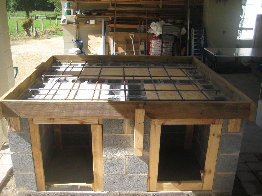

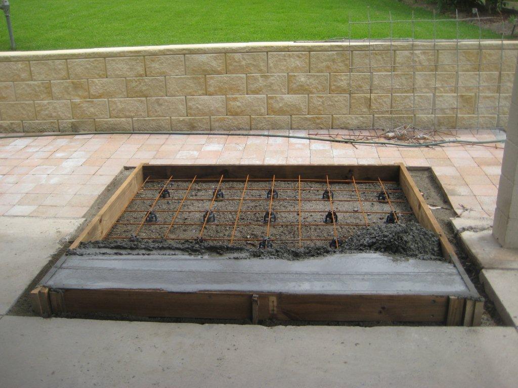

        I would not be to concerned about the cracks it is only hairline you have put enough mesh in the concrete to hold it all together most concrete will crack at some stage thats why they put expansion joints in concrete slabs as I said the mesh is there to hold it all together
        Micky unfortunately people get the use of mesh and reinforcement wrong, mesh is for use when laying concrete on the ground and rebar is used when pouring a suspended slab most would use 1/2 inch rebar for a suspended slab and perhaps F7 mesh for concrete driveways etc
        Cheers Doug
          Cheers Doug
