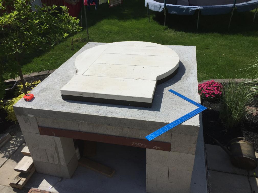

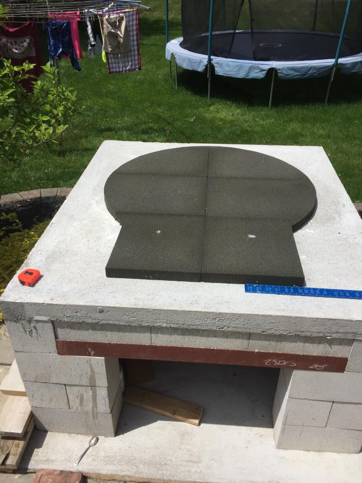

    I ended up using 5 thermo 12 boards for my insulation. Then laid out my cooking floor. I installed a thermal break between oven and vent chamber using a left over piece of 1/4 insulation paper. I’ve got a 1/4 SS tube that will rest on top if the insulation paper and be about 1/8” below the cooking floor.

    I priced the thermal 12 gold. I think that may be what I purchase. It is pretty reasonably priced at $5.49 a square foot not bad since everything else I saw was ridiculously priced. How many boards did you buy for your oven?
    Leave a comment:
  • jamel
    replied
    I used thermo-12 gold. Came in boards 2”x12”x36”. The dome is actually already done. I just need to organize my photos and get them up.
    I’m in the middle of a deep freeze right now with more snow in forecast but I want to be ready for spring
    Leave a comment:
  • cbailey
    replied
    Very nice start. Good choice with the foam glass. I already had my floor laid with 2" of insulating board. I'm always concerned with it getting wet.

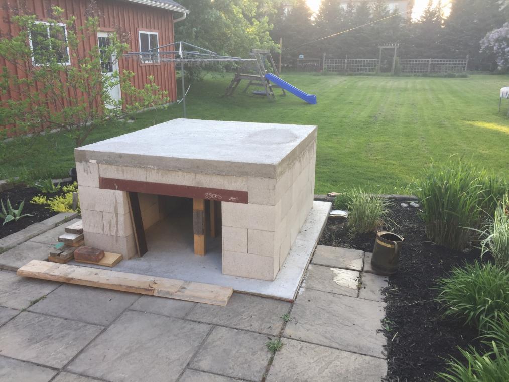

    Well, I’ve decided to take the plunge and build a Pizza oven. This site has been invaluable and giving me ideas and direction. I’ve settled on a 37” Pompeii design with a full arched opening and a walled enclosure. I actually started the project last year so I’m a little behind in my posts. I went with foam glass Option to help keep thing dry
