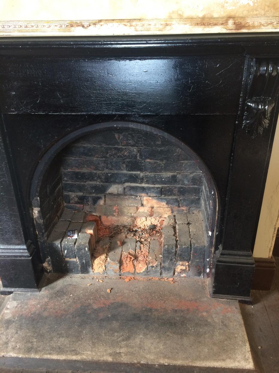

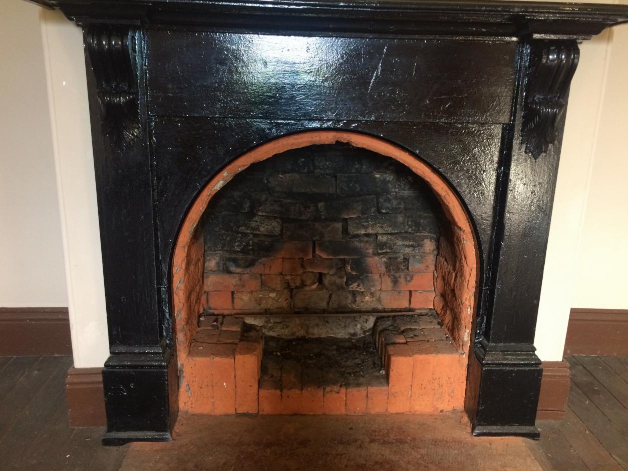

                  Just by looking at a brick and its appearance can be quite misleading and bear no relationship to its suitability. Similarly hitting a brick with a hammer or throwing into a fire is unlikely to give you an indication of its longevity. It is the materials contained in the clay combined with the degree of vitrification and temperature fired to that determine their suitability. Generally a brick with a high proportion of alumina is better also a low level of iron oxide. Generally red indicates a high level of iron oxide. Higher temperatures the brick has been fired to also better but there are exceptions. A fully vitrified clinker brick fired to 1200 C may suffer from thermal shock while a low fired brick with an open body may perform better. This information is unlikely to be available so although a brick may prove in practice to be quite serviceable it also may not. We used to source creamy house bricks from Cooroy that proved quite suitable for kilns fired to stoneware temperature (1200 C+). A similar looking house brick with a different composition may prove disastrous. Attached are pics of failed solid reds used in a really old fireplaces. The spalling may have taken many years to develop, one firing probably not.
