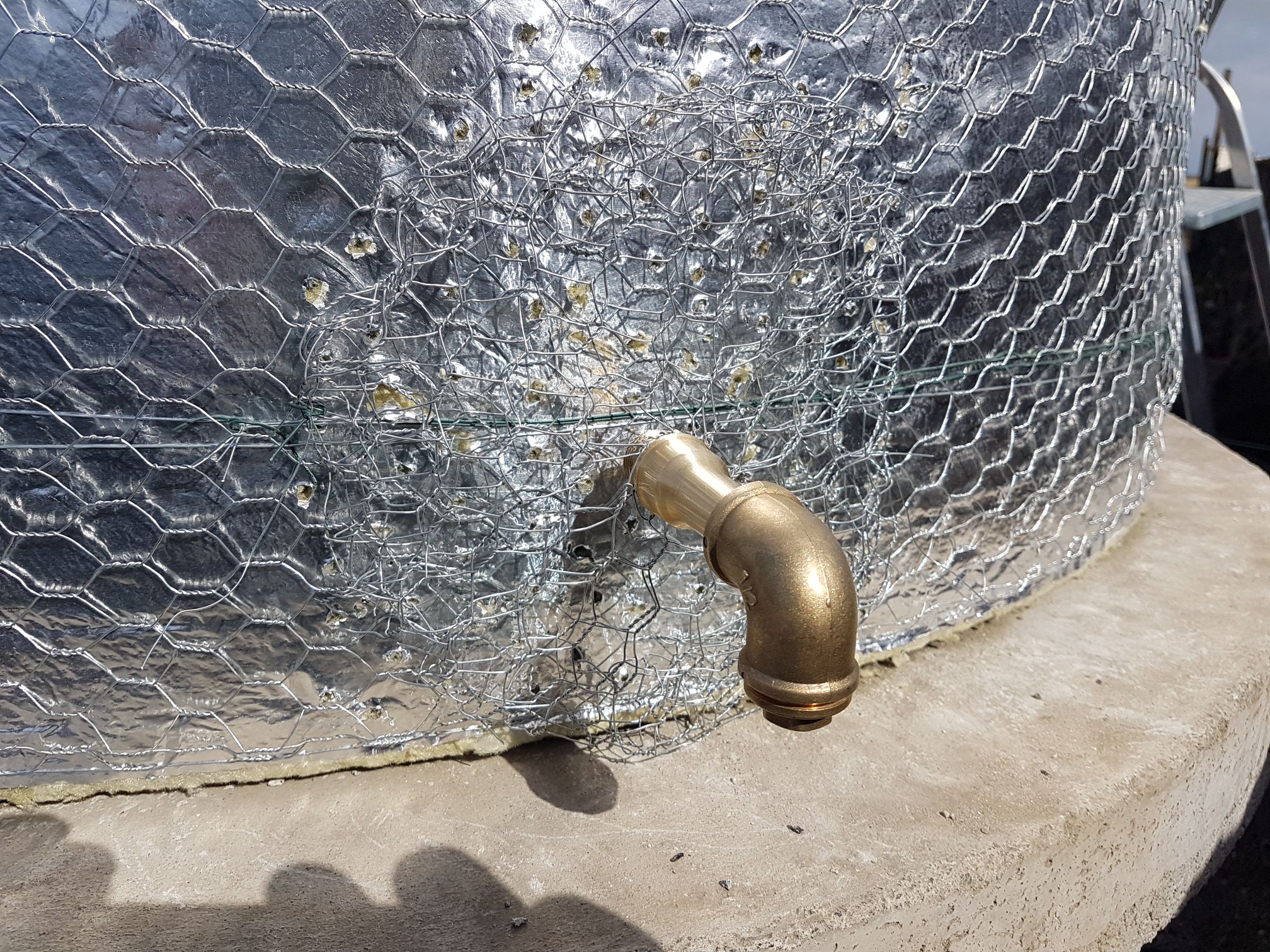

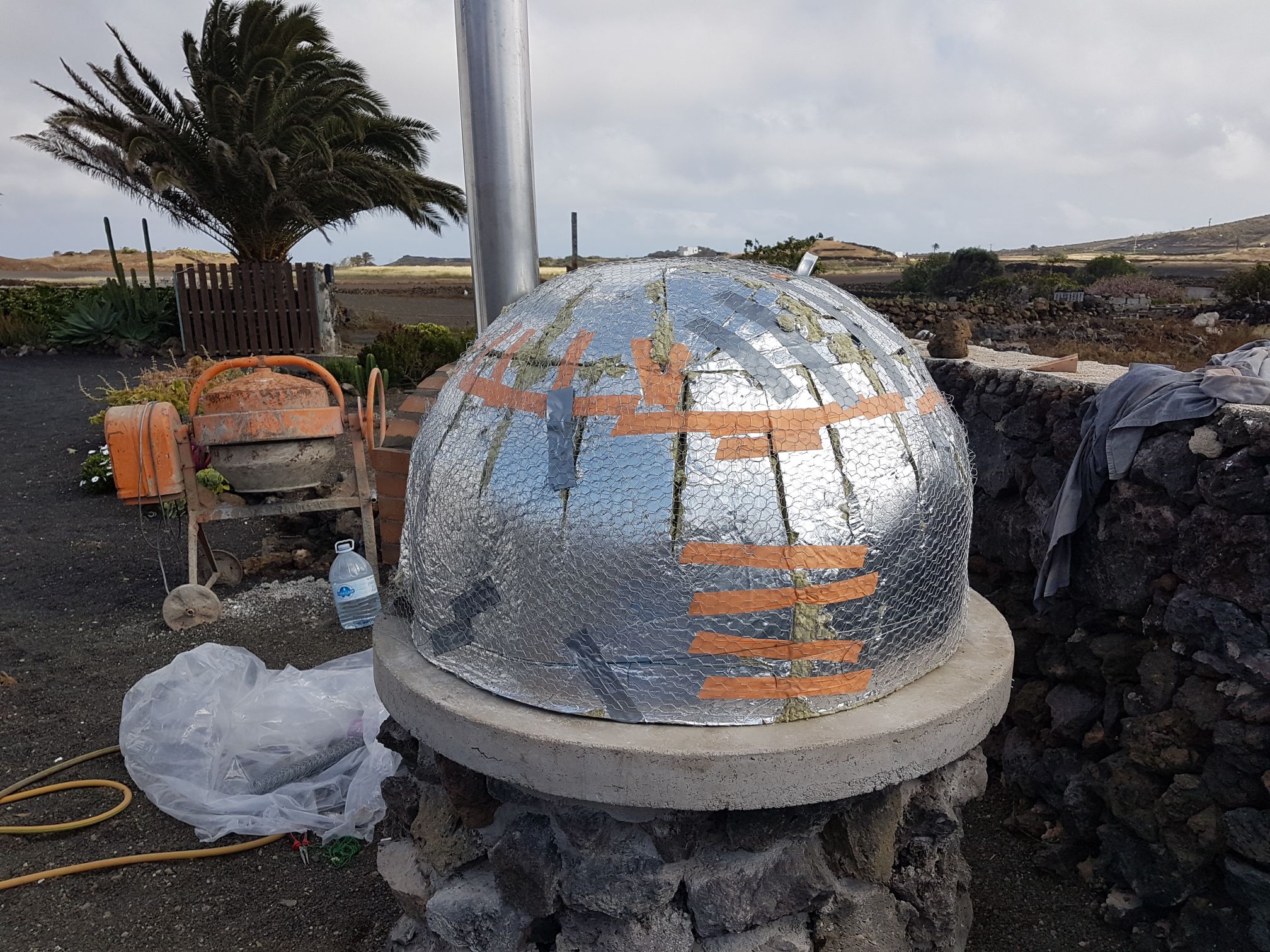

    I found rock wool oven insulation today and packed the dome with it. It was a pain to work with it, but I think it's good enough. The datasheet confirmed a maximum temperature of 680°C.
    I am going to insert a brass fitting into the next scoria/concrete layer to create a pathway for the potentially accumulated moisture.

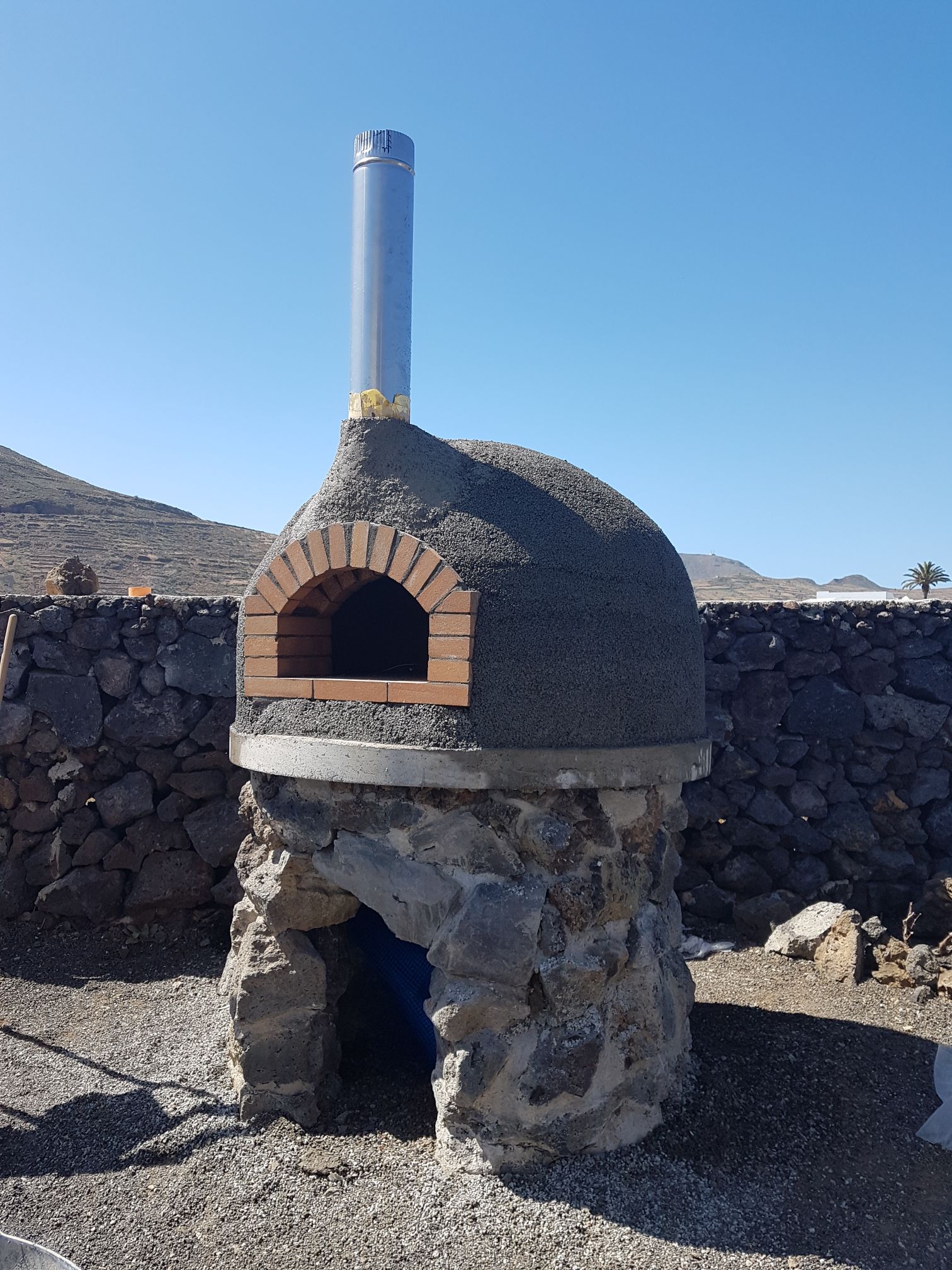

      A little update from today. I finished adding my scoriacrete layer today and shaped the transition to the Chimney. I had to make the mix a little richer in cement than 8:1 to be able to work it at all. I was able to get a nice surface which I am very happy with. It's now covered and I will add the stucco tomorrow. I know that this is not ideal but I want to get it done and I'm confident that the coming summer with hot and dry weather will dry out the oven anyways.
      I will advise the next visitors on how to do the curing fires and then, when I return myself, I can enjoy a finished oven. I hope, at least!

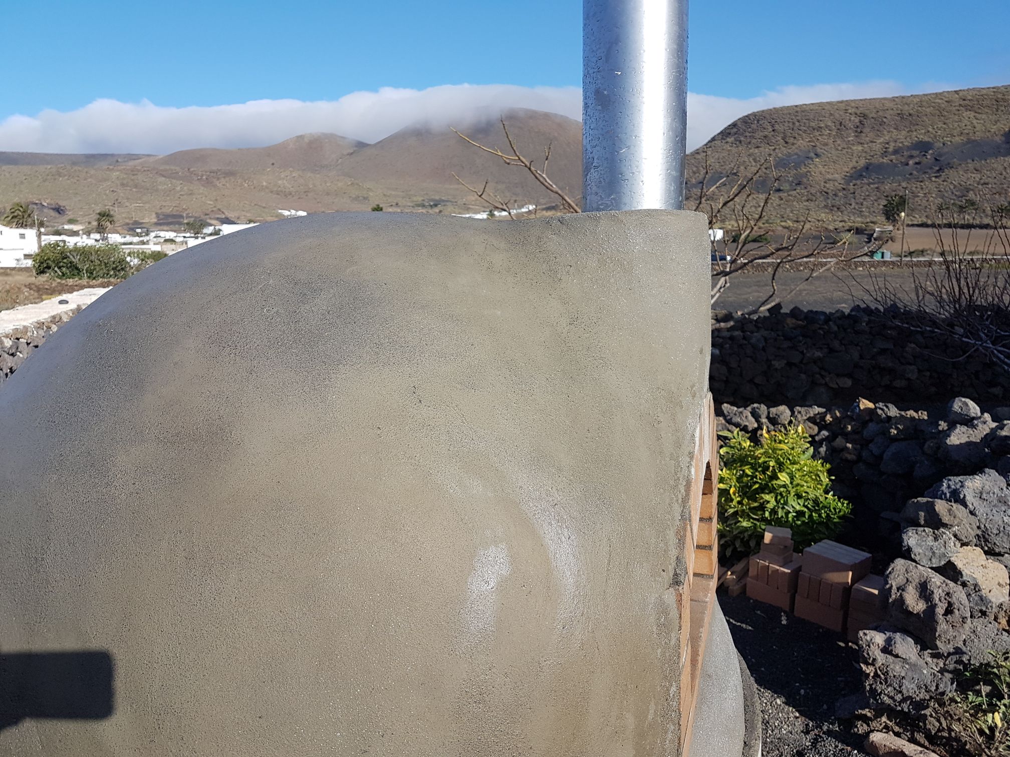

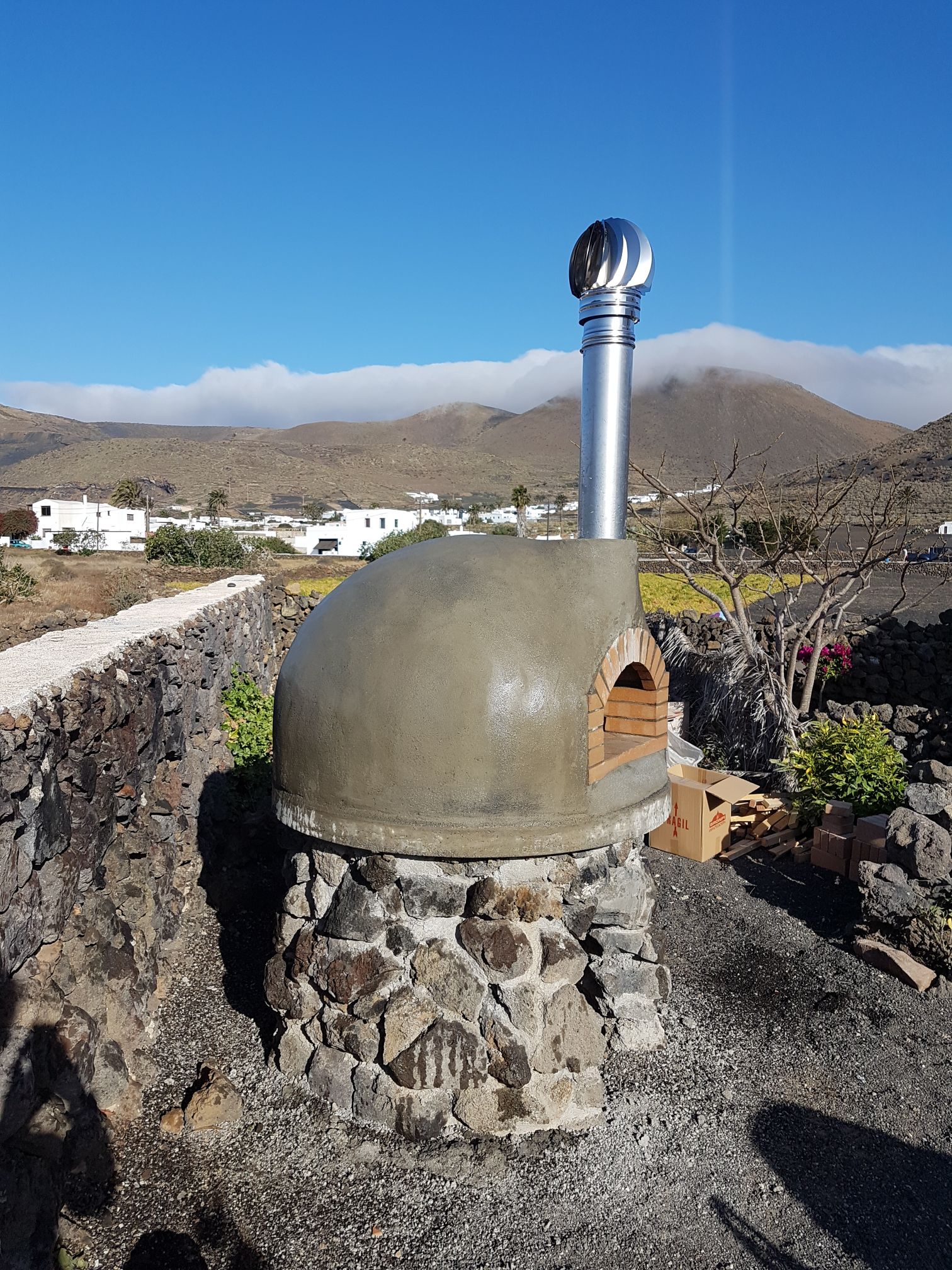

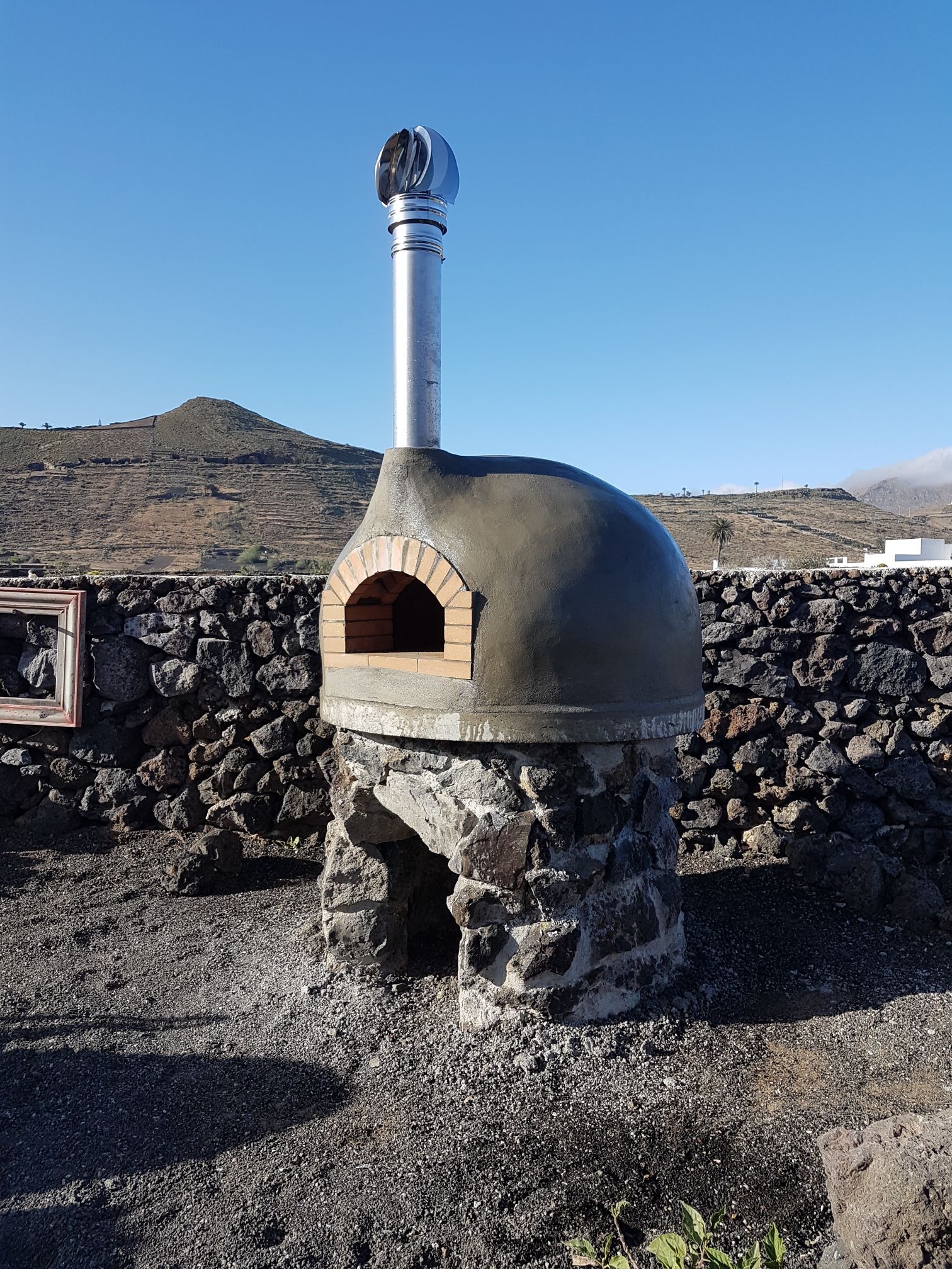

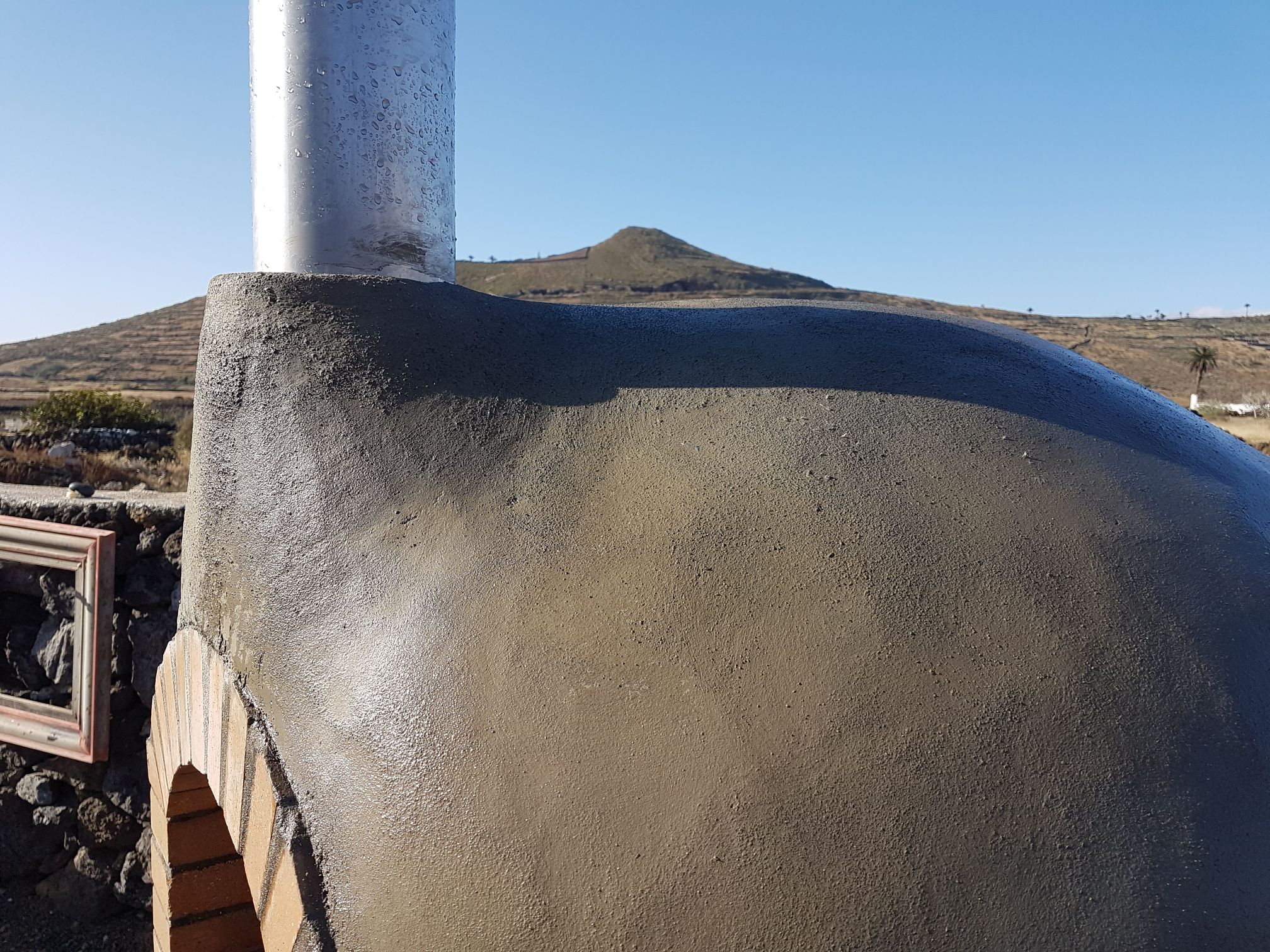

        For the sake of completeness, this is the oven with the final stucco added.
        It is nice and damp under a cover for now. When I leave, it will have been a full three days under the cover. I will remove the cover just before leaving and then the oven will have time until may to dry and cure in the nice dry heat and wind here.
        It will be painted white in the future. Should I use a sealing paint or a breathable one?
        Thanks for all the support and I will make sure to post some more pictures next time.
