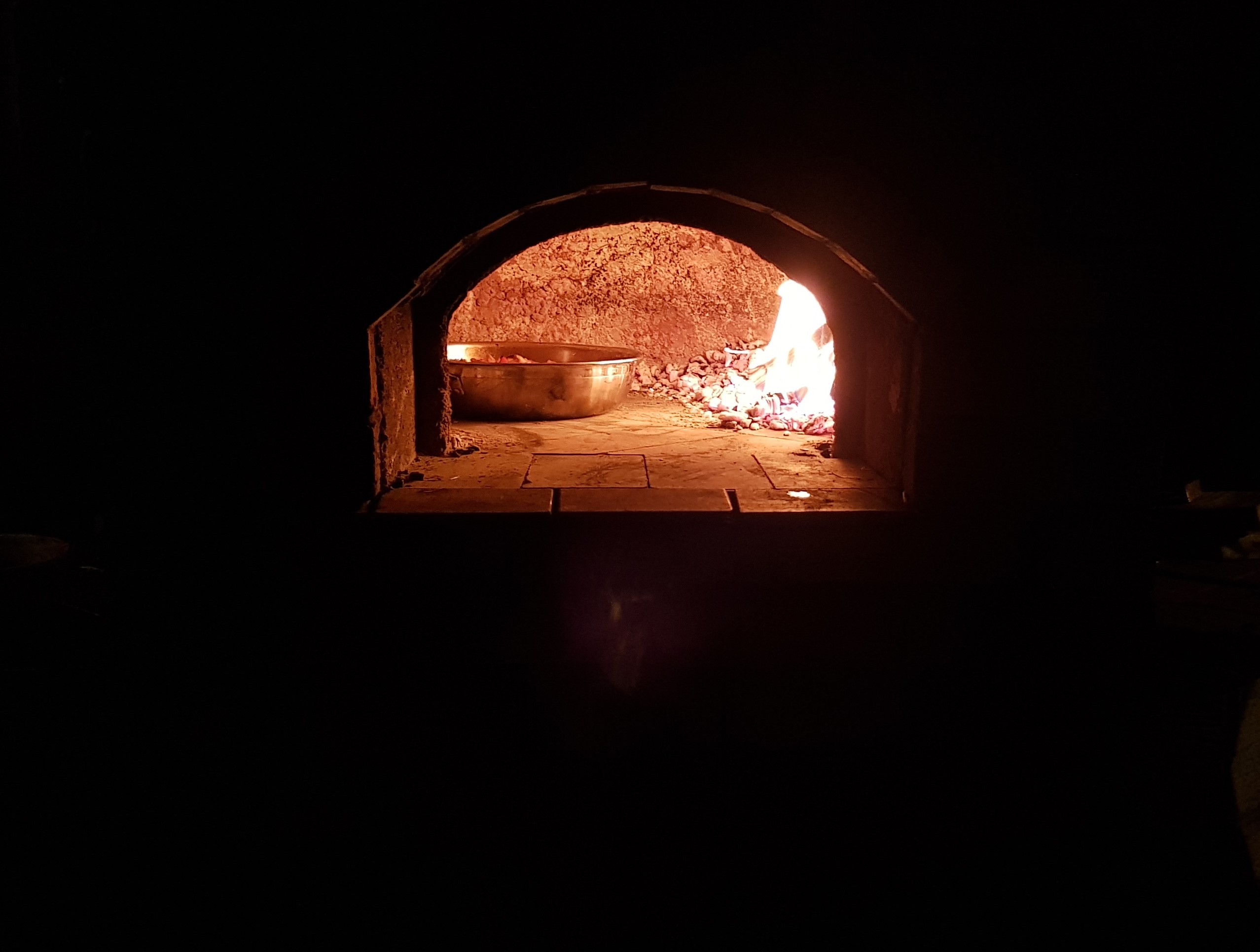

        Cooking a paella in the oven last night.
