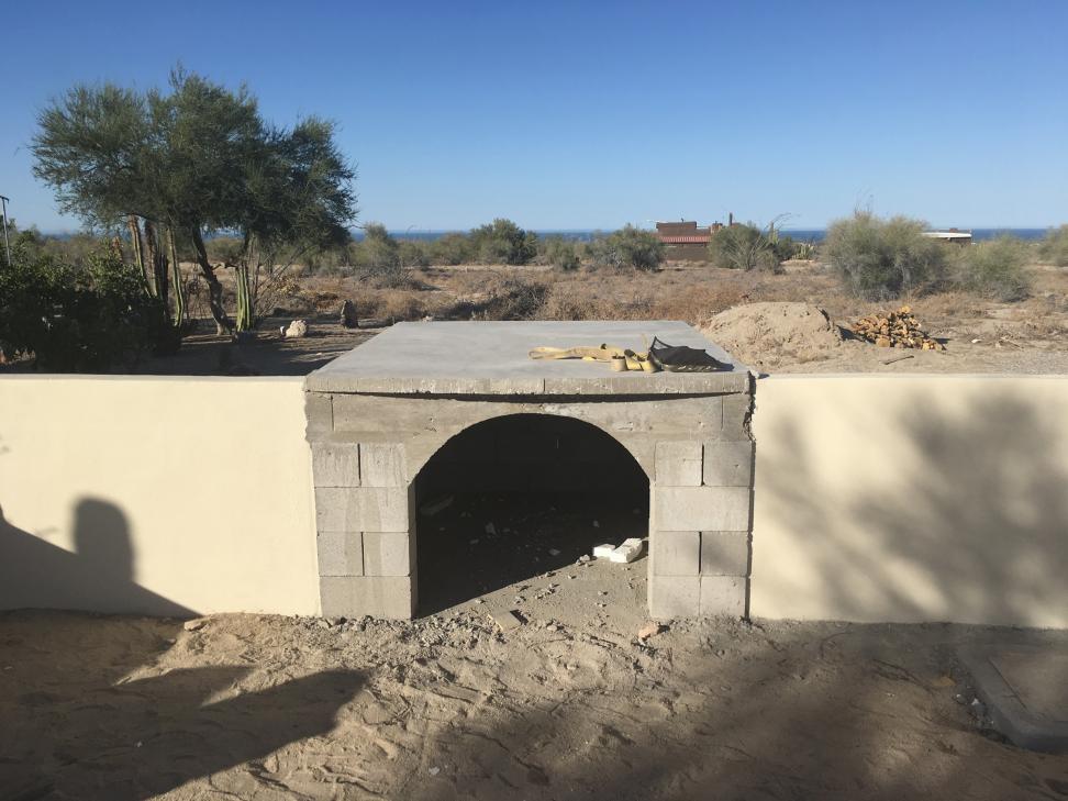

    The base is a great start, monolithic arch pour. You can do it, although I classify myself as a glorified DIYers I never had tackled bricklaying or building of an oven. It can be done. There are a lot of builders on the forum that this was their first WFO. So be sure to ask lots of questions, much easier to correct on paper the old sayin goes.
      Thats a good start. Because you have built it into a bank there is soil against the sides and back of the stand. This may/highly likely cause water wicking issues. If it were mine I’d be sealing the top of the slab before the insulation layer goes on, with perhaps the kind of waterproof membrane used under tiles in bathroom installations. In addition to help water elimination from the oven and insulation drill some holes through the supporting slab to help moisture escape.
        Thanks gentlemen... the photo is deceiving. The base is not actually built into a bank... it sits flat on our sandy soil under a heaven duty foundation/footing. I use the word soil loosely. Average rainfall here is less than 3”... that said we had a 100 year flood last winter so sealing the slab is definitely in order. Also like the idea of weep holes... planning on drilling several small holes and screening them before I get rollin’.

          My apologies, I misread your photo. Given your climate and it not being surrounded by soil, you won’t have water wicking issues.
