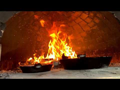

    I've put some photos of my most recent build here and a few video of recent use on my YouTube Channel.
