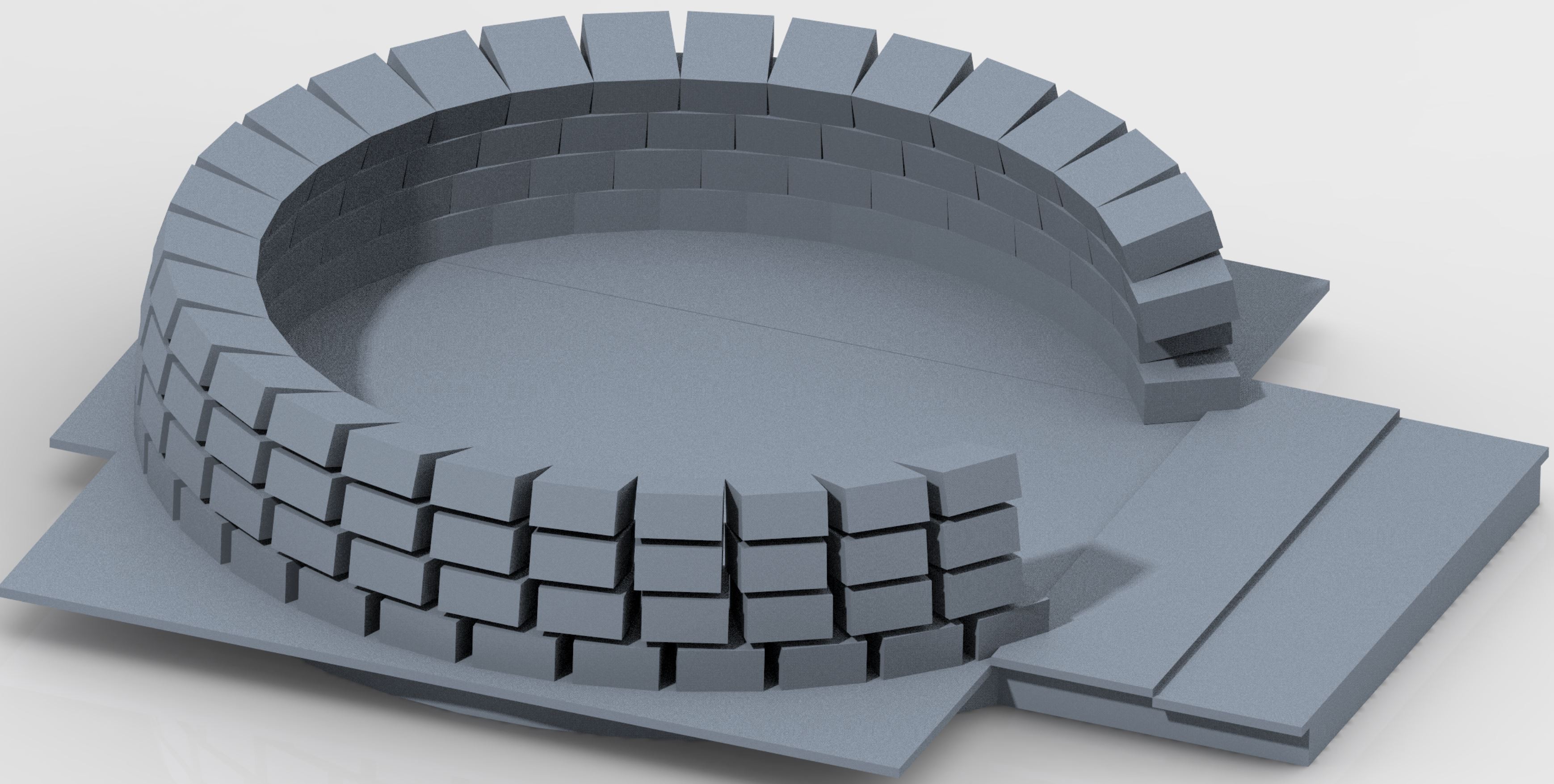

      I plan to make igloo if dome turns out okay. If it is a mess I will box it in. The image below is what I'm planning, Of course though I will align the bricks so the joints are more offset from course to course than shown in the image. Dave

        Couple items since I have a visual now, the design is using half headers rather than half soldiers or rowlock. This is the more common starting point. You have two options for the floor, Cut to fit inside of dome or dome sits on top of floor, the former takes more cutting to fit but allows removal of floor brick if necessary (however, I have only seen one or two out of hundreds that required a brick removal). The later requires less work by rough cutting the floor bricks and leaving proud, IMHO, I would do this method if I were to build another. Based of the CAD drawing, if to scale, the insulation under the floor and dome does not appear adequate, You need a bare min. of 2" of CaSi or AiSi board or 4" of 5 to 1 p or vcete.
