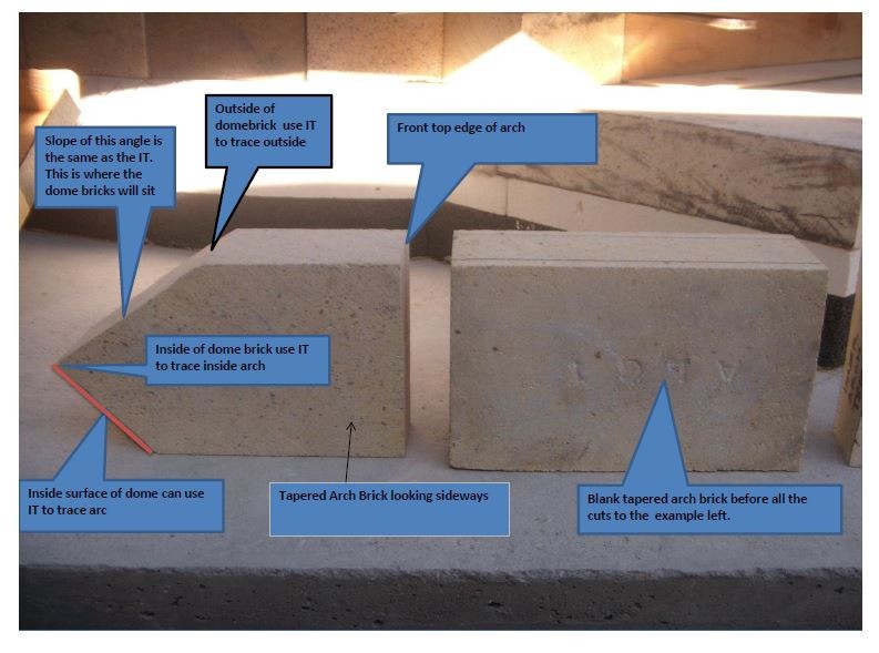

                Are you wanting to do a tapered inner arch? Here is a little explanation I put together to help people visualize this concept. It is one of the more difficult concept to see until you actually see it fit together. One thing I cannot tell if the arch bricks are already been cut in half. In order to do this type of arch you need to start with full length bricks with the top dead center brick being the actual longest one. Each arch brick is slightly different so you cannot cut them all at once.

                  Thanks Utah, that diagram is supremely helpful! The cutting each brick slightly different is what got me still thinking, but I'm almost there. With a low dome the angle changes from the IT angle with each new course. So far I've used my template to figure out how to cut the notches on the bottom side. Now I'm stuck trying to figure out how to meet the dome to the arch because I think there are at least 2 good options. A) Cut enough off each arch brick to meet the dome well but leaving good amount of brick behind or B) cut enough off the arch bricks so you don't have to cut the bottom of any dome bricks, transitioning to the next dome row when required. Also there would be C) build arch first and do your best to meet the dome to it without any planning ahead of time with lots of tricky dome cuts.... (Already clear that this is not the advised path)
                  I'm pretty sure the best answer for stability is A and I think that is what I understand you and others saying.
