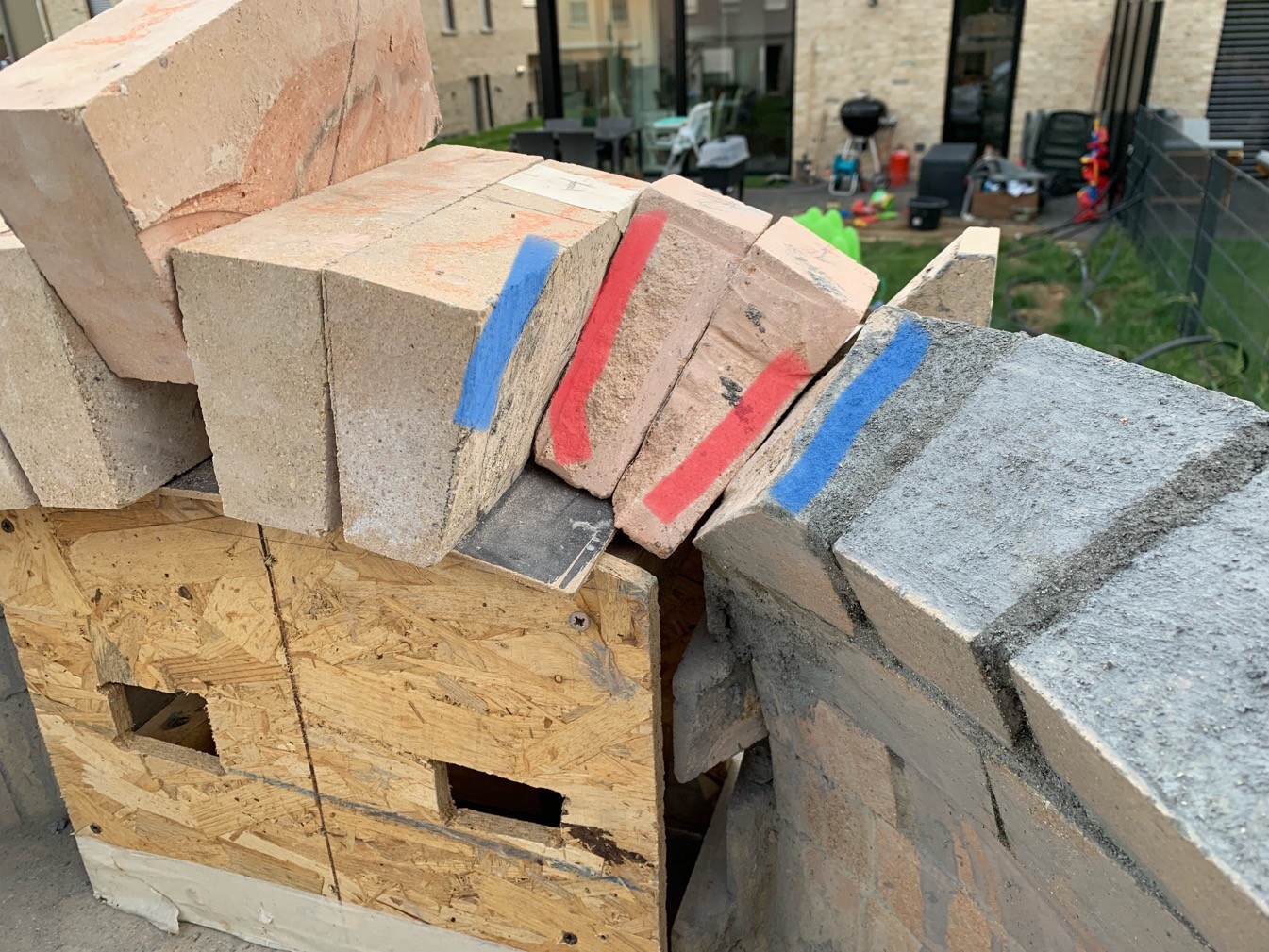

    Hi Guys, I ask your opinion on one of the most difficult part of this journey: the arch.
    I already tapered all the bricks and read a lot of theory, but now I’m a little bit stuck .
    In order to be aligned with the dome courses, should I:
    1) cut the arch bricks in order to be aligned with the 4th course (red line) , but leaving smaller bricks for the arch
    2) be aligned with the 5th course, a bit prominent inside the dome but less work and bigger bricks ?
    thanks for your opinion

    you could use an online calculator, like this one: https://www.blocklayer.com/masonry-arch.aspx
    But it's not so hard to do it yourself:
    You first need to know how many bricks you will need, you want as few as possible, but you also want to keep the joints nice and thin.
    You should realise that the dimensions at the top of the bricks are proportional to the ones at the bottom (see attached illustration)
    R1/R2 = L1/L2
    So, in practice:
    1. You know your arch radius (R1). To know the radius of the top of the arch R2, just add your brick height. Use a flexible measure on your entry shape to determine the length of the arch (L1). Now, the length of the top arch can be calculated using that ratio:
    L2 = L1 * R2 / R1.
    2. Now that you know L2 (in my case it was 755mm), you can determine how many bricks you will need: My bricks were 55mm wide, and I wanted the joints to be around 5mm. Together that's 60mm. Dividing L2 by that number and rounding up to the nearest integer number (or to the nearest odd integer number if you insist on a central keystone). In my case, the result of the division was 12.58, so I decided for 13 arch stones.
    N = L2 / (brick_width + joint) rounded to nearest (odd) integer
    3. Now that you know how many bricks there will be, you can divide the arch lengths to find the individual brick widths:
    W2 = (L2 / N) - joint
    W1 = (L1 / N) - joint
