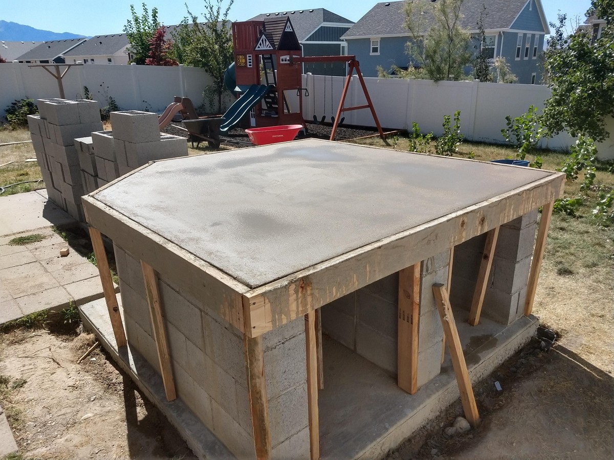

    I started my work a few months ago. I just finished the construction work on my base and I'm finalizing plans for building my oven. As of now i'm planning on building a 40 inch oven. I have a few questions.

    Nice looking base - looks like you are doing a corner build?

      Thanks for the response. it's a corner design because I'm building prep area that will have a big-green-egg style bbq set inside.
      For the insulation i'm mostly worried about safety. I'm also planning on doing a couple inches of perllite cement. That seems like a less expensive option as I'm already over budget on this project.
      Thanks for the quick reply. I'll attach more pictures as I progress.
