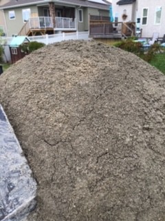

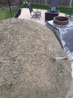

    Today I put on my 3 inch of ceramic cloth and then started to put on the vcrete. I used a 6 1 mix of perlite and cement.
    It was a nightmare to try and get it to stick. I was not able to trowel it on and ended up just hand slapping it in position. Almost as much fell off than stayed on. (I guess if you throw enough mud at the wall some will stick!)
    The cloth moved and kept breaking the vcrete which would fall off. I tried with numerous different "wetness" of mixture. Too dry fell off wouldn’t even bind together. Too wet would just fall off. Got it right towards the end and it would palm on and spread a little but too much pressure would lead to the fabric being pushed in and the the vcrete falling off.
    Anyway got it finished.
    But .....am I being too much of a perfectionist as it is cracking already. Should I put another thin layer on once it has set to cover the cracks?
    I am leaning towards I will be ok as I have 3 inch of blanket underneath and will be putting stucco on the outside.
    I only really put the vcrete on for extra insulation and for a better surface for the stucco to bind too.
    What do you all think.??
    Willl these cracks be ok?.
    Haven’t even started curing yet. These happened as it was air drying while I was still finishing the layer.

    It’s difficult for me to keep up with your build. Its best to start a single build thread in the beginning so folks can follow and offer advice as you go.

      did you use chicken wire to firmly hold the blanket in place? Seems like the blanket moved under the weight of the vcrete.
      It is not ideal. As it will not provide a stable support for your stucco. Vcrete is not so strong, a thin layer will just crack in the same places.
      If you need a weatherproof dome, then I would either redo the vcrete (this time using a curved tool as a movable mold, holding the vcrete in place while that you can compress it somewhat). Or fix the cracks with a crack filler (fit for outdoor use).
      Then make sure to use some kind of mesh in your stucco to give it tensile strength.
      if this was the point where planned to start curing, you might as well do it with it cracks in place, so that steam can easily escape and all the cracks can settle before you fix them.
      I had some vcrete cracks after curing (less severe then yours). Used a filler. So far holding up.

        I just finished the vcrete on my dome too, and the top is definitely weaker/crack-ier than the bottom. It's at least 2 inches thick. I did not use chicken wire.
        I'm not going to worry about it and just move to the stucco layer. I do like the idea of using some crack filler. I can't imagine re-doing the whole thing, because I think it would have the same end result.
        might put some chicken wire or mesh down overtop the vcrete for some more strength and support.

          No I didnt use chicken wire and yes it cracked because of the blanket moving. I will put chicken wire over the top of this and do the stucco. I have started curing as I though the same thing and the heat doesnt get thorught to the vcrete anyway because of the blanket. So I assume the curing is for the thermal brick and floor only. Im on day 3 of curing now and no more cracks inside or in the vcrete. Chicken wire and stucco it is.
