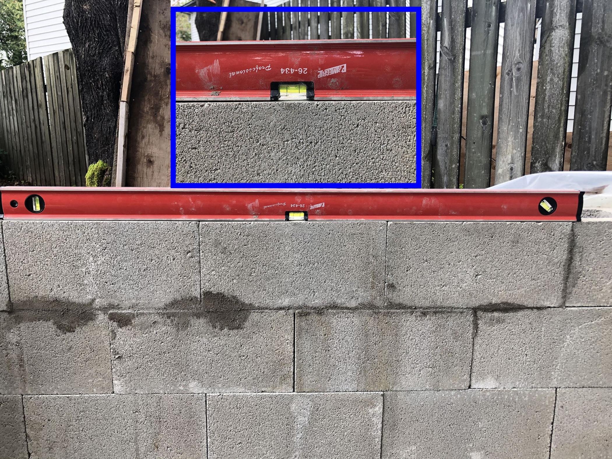

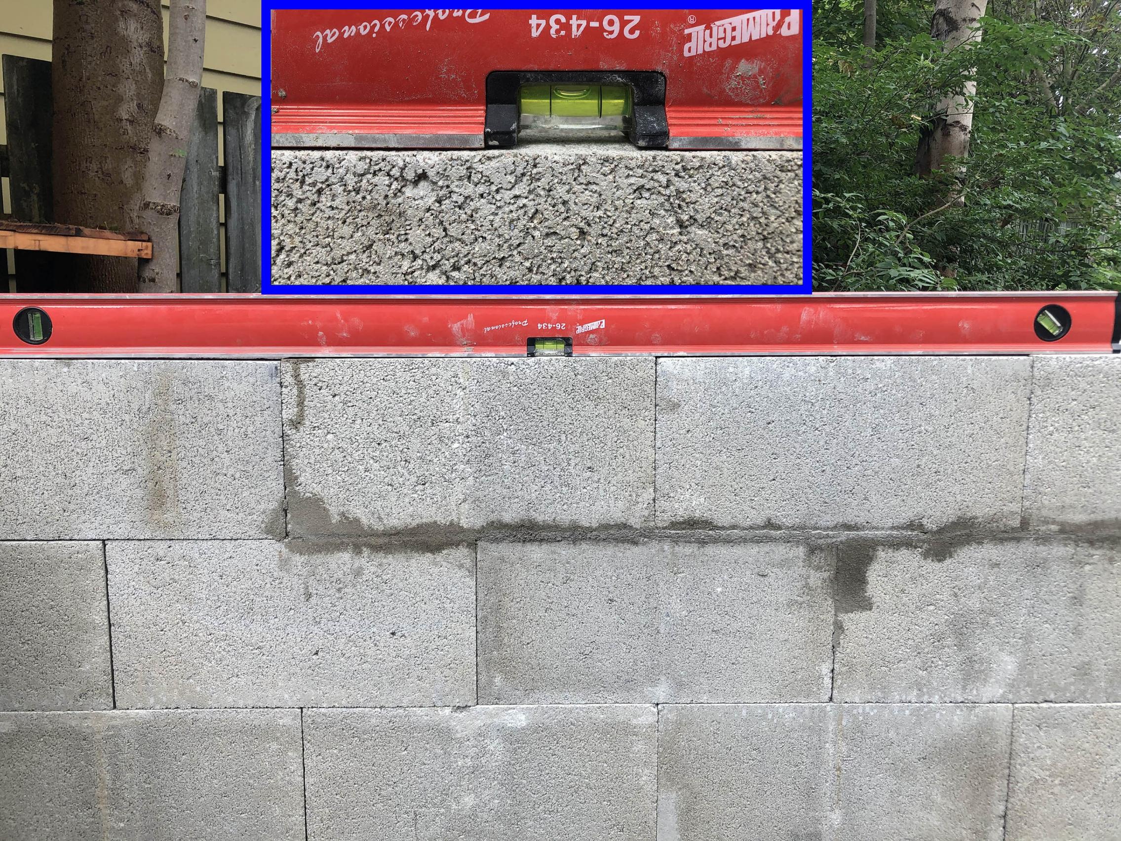

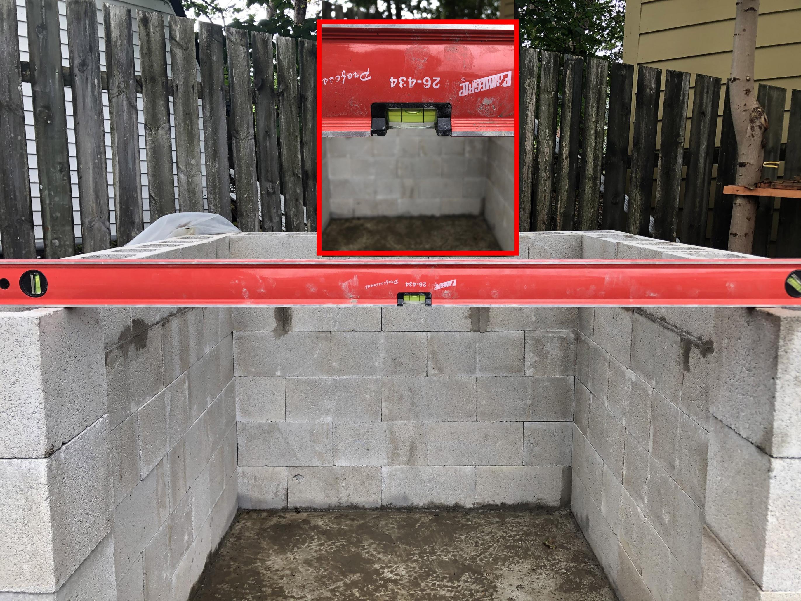

    Hi,

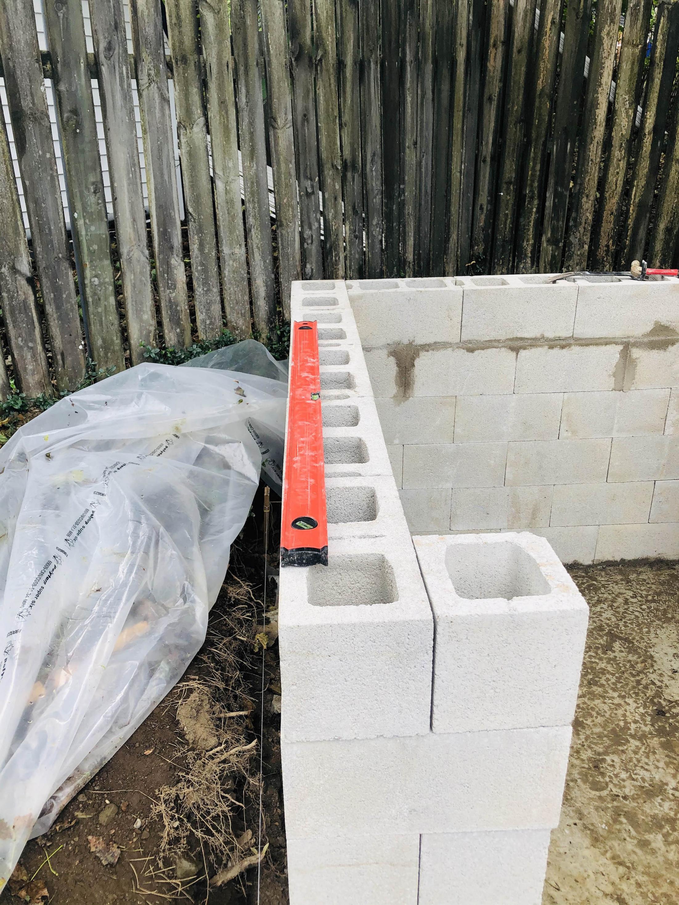

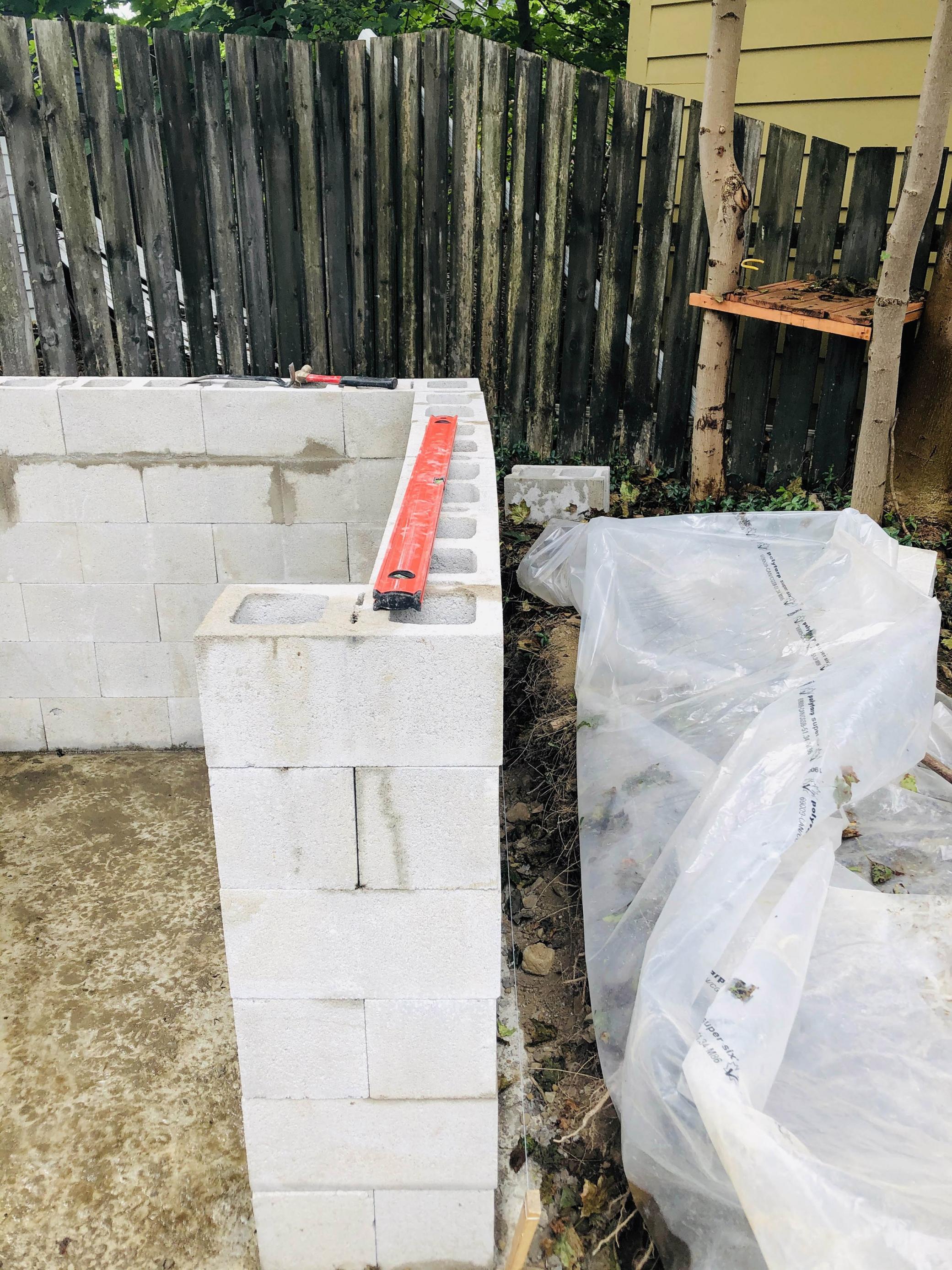

    I recently stacked my stand and I had a conversation with a mason who recommended that I don't dry stack my blocks. Is what I have done is ok? The diagonals are equal. I used mortar on the bottom layer. I plan to fill cores with rebar. I have concerns about the "right wall.jpg"
    I've attached photos, can someone advise?
    Michael

    Howdy Michael! I would guess the majority of ovens documented on the forum did a dry stack with alternate core fill that was rebar tied into the top slab. Being an "over builder", I would suggest a stack/stub wall to support the center section of your wood storage area. Masons always suggest mortar because block alignments assume that 1/4" of mortar will be applied. Your dry stack base is fine. Keep posting your progress pics & any build questions you have.

      Thanks for the quick reply and your expert advice. Did you notice my right wall pic where the wall is slightly curved? I'm wondering about a solution to that. My plan is to have my top slab square and have the finishing material cover it up.

        I also think your dry stack is ok. As Mike pointed out, most builders dry stacked and it's a generally accepted practice. The slight bow of the right wall shouldn't be an issue. A stub wall will support the middle but will also make your storage area a bit cramped. Picture yourself fetching the last bit of firewood out of there. Or picture it sitting back there for years because you keep putting 'fresh' wood on top of it.
        The majority of weight will be around the peremiter. My stand has two openings into the storage and a lot of open spans but no stub wall. Also being an over builder I compensated with a thicker hearth slab and LOT of steel. If you want extra piece of mind on your walls, fill every core.

          about the bow in the right wall, when you frame for your hearth you'll have a gap at either end. Concrete won't fall through small gaps. Good plan to just compensate with your finish material.

              Wall looks good to me. and there are structural analysis articles out there that prove drystack is stronger than a mortared wall. The downside is that they are nearly impossible to keep as straight/plumb as a mortared wall.
              also, all my levels have a top/bottom. The vials have a slight curve to them which effect how they read level. All mine are older though, maybe the new tech is different.
                If dry stacking, I prefer to use masonry adhesive. It doesn’t really matter as filling cores is sufficient to hold everything together. The main reason mortar joints are used is to get correct levels, compensating for brick inconsistencies. If using masonry adhesive you can adjust the levels with some 8mm washers in a few strategic places. For folk who haven’t developed mortaring skills this is far easier. Sorry this tip is probably too late.
