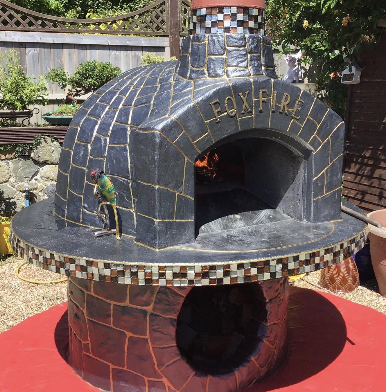

    Quite a lot on this one I built a few years ago!

      thanks for the quick reply. I see there is a ramp that enters the oven and it looks like that is tilted. Is your hearth also tilted?

        Sorry, yes the outer ring slopes outward around 10mm and the area below the chimney has a steep slope to try and stop any rain water ingress that might get blown in or come down the chimney.
        i build the hearth level and slope whatever finish I use away from the dome. Obviously you dont want your wine glass sliding off but even a slight fall will be a bog help.

            Well i plastered the oven with fibre mix cement ( plastic fibres, one part cement two parts sand) that sets like sheet metal so no water can get in the oven, however i live on a very humid island so i have to build my ovens like this .
            I have built 6 ovens all pretty much the same design and a few others with total enclosures so I have leant along the way.

                Well the slopping entry is a compromise as that area is also a great space to have for keeping food warm etc but it works for me and my location.
