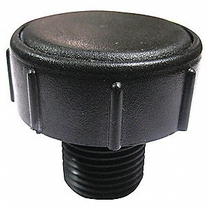

    It is cheap insurance to vent the oven at the apex of the dome. Any water that sublimates from liquid to vapor increases in volume by a factor of 1500 plus which has the potential of building pressure under the stucco to the point of possible cracking. There are many solutions to vent the oven. Gulf and I used a breather vent found at any car part store for under $10. It is a 1/2" MPT where you use 1/2" PVC bushing seated in the vcrete and or stucco. David S has his built in the chimney stack..Click image for larger version  Name:	breather vent.jpg Views:	0 Size:	25.9 KB ID:	434701
