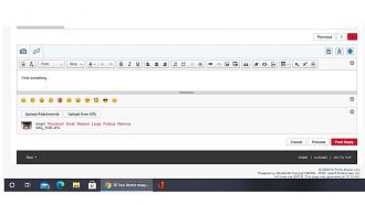

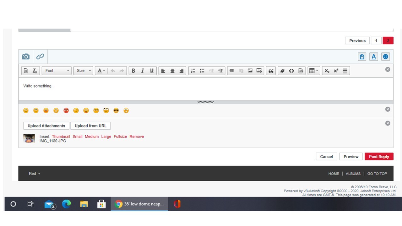

    Somehow I don't manage to upload the pictures properly, they always appear as thumbnails only. can someone help?
    Thanks!
    • #17
      If you are uploading as an attachment, there should be a size prompt for you to select

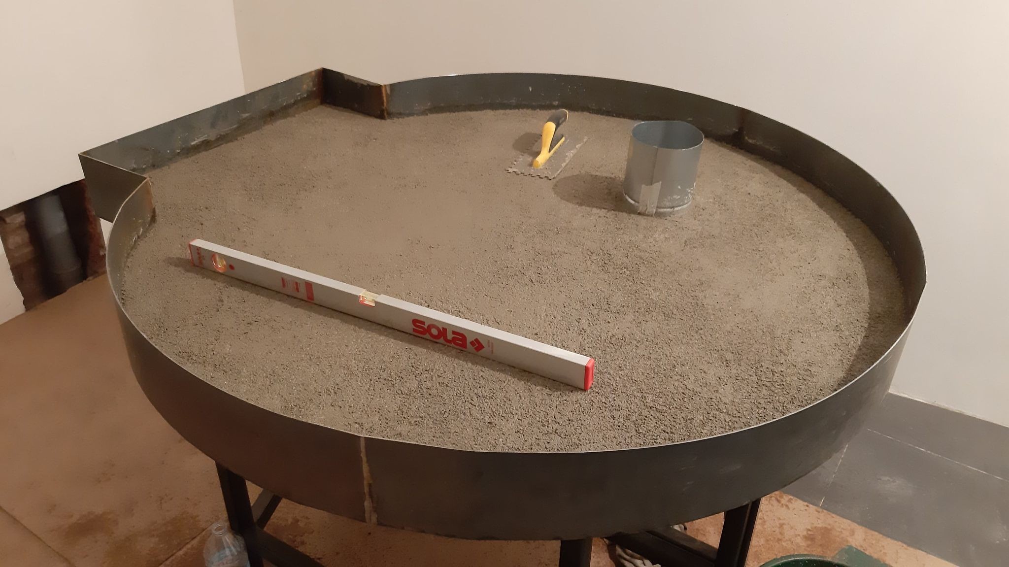

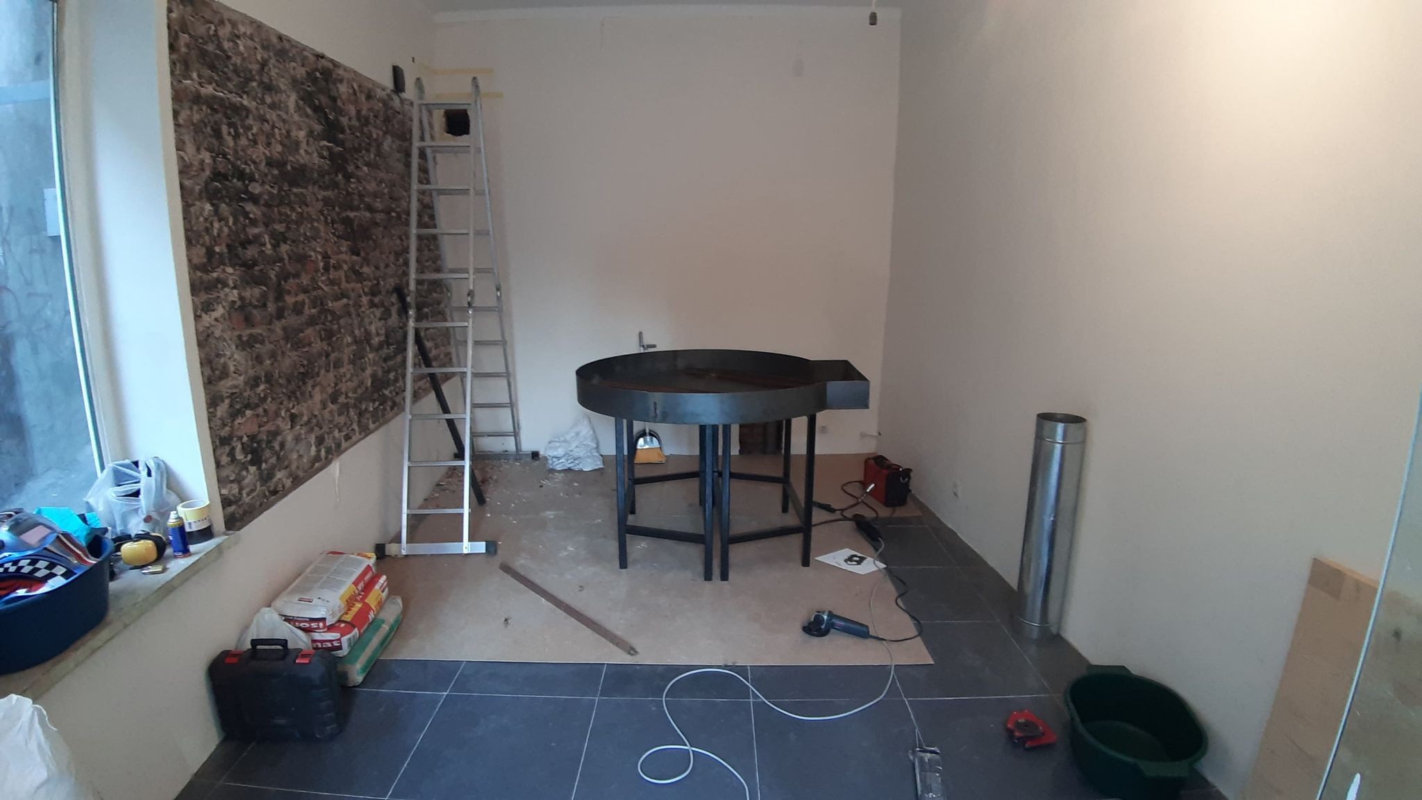

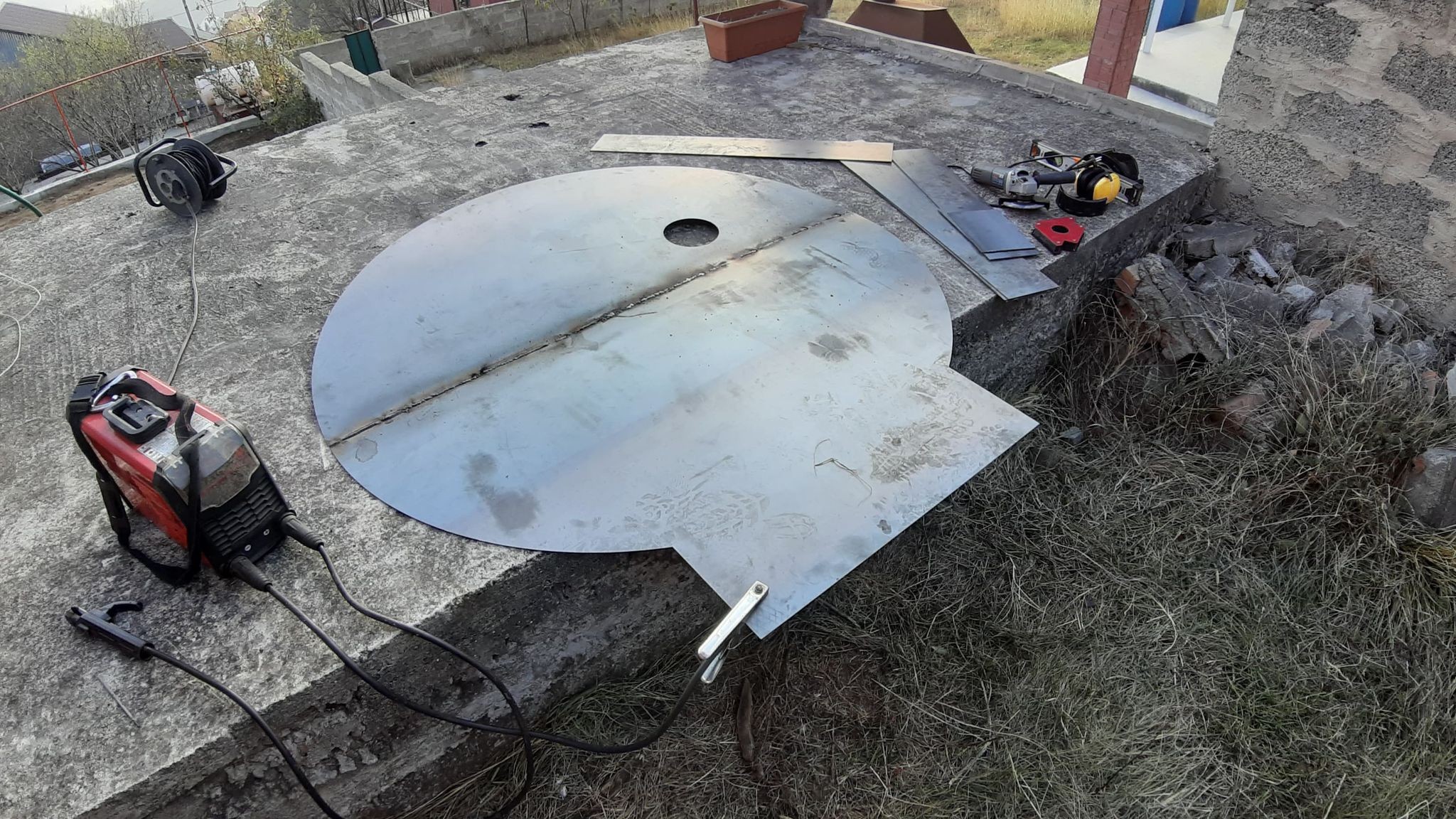

          • #20

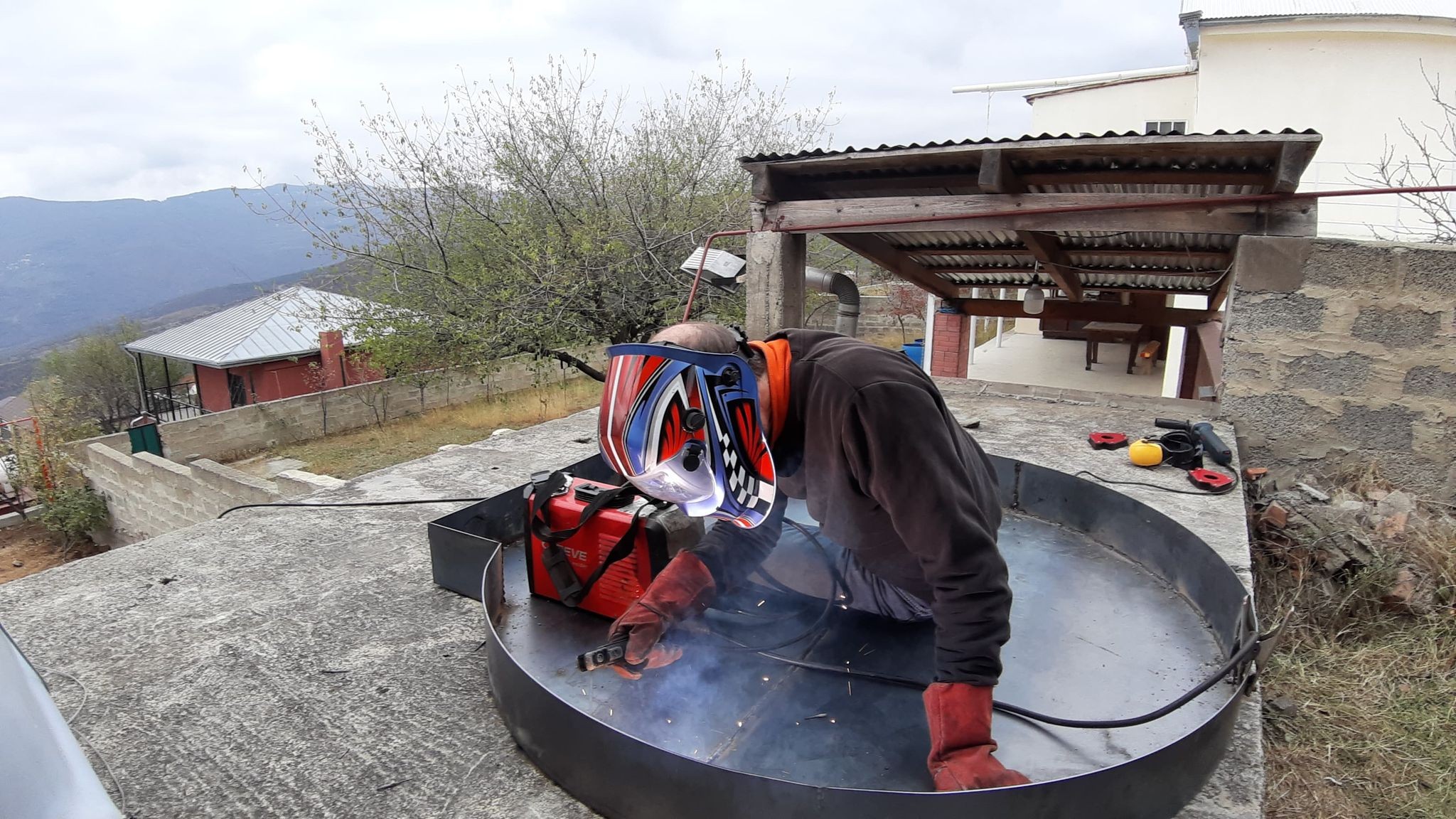

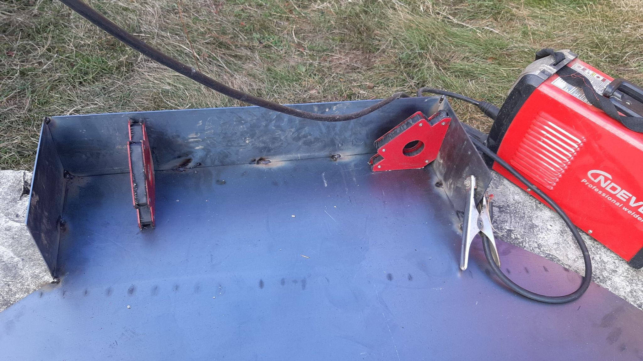

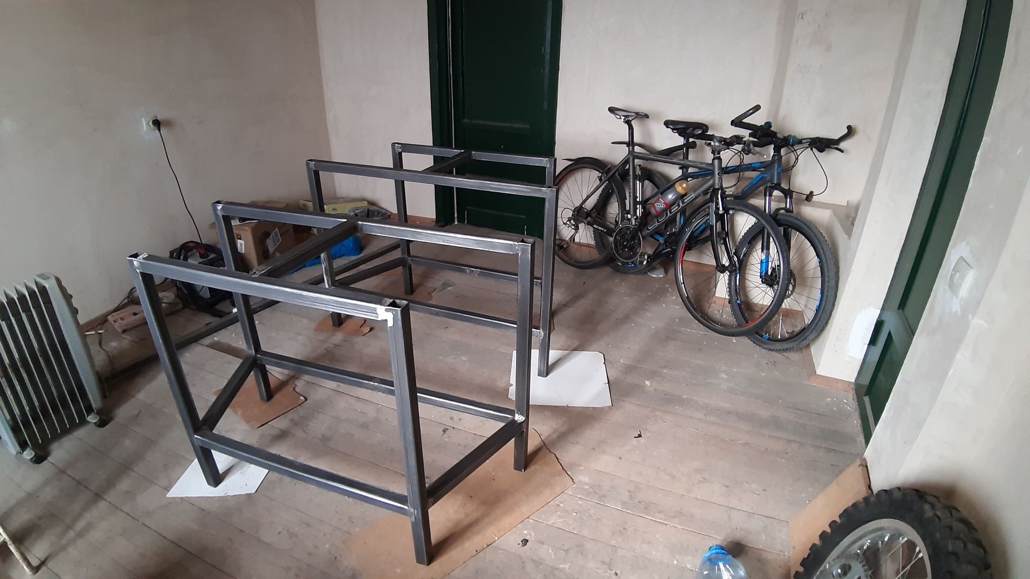

            I have welded it together - however made some mistakes. I was not aware enough of the bending of the metal when it heats up - so it does not win a beauty price. But it should work.
            Since the oven one day needs to be lifted out of the building I also added some support structure which will be hidden in the vermiculite cement - just to make sure it will not collapse.

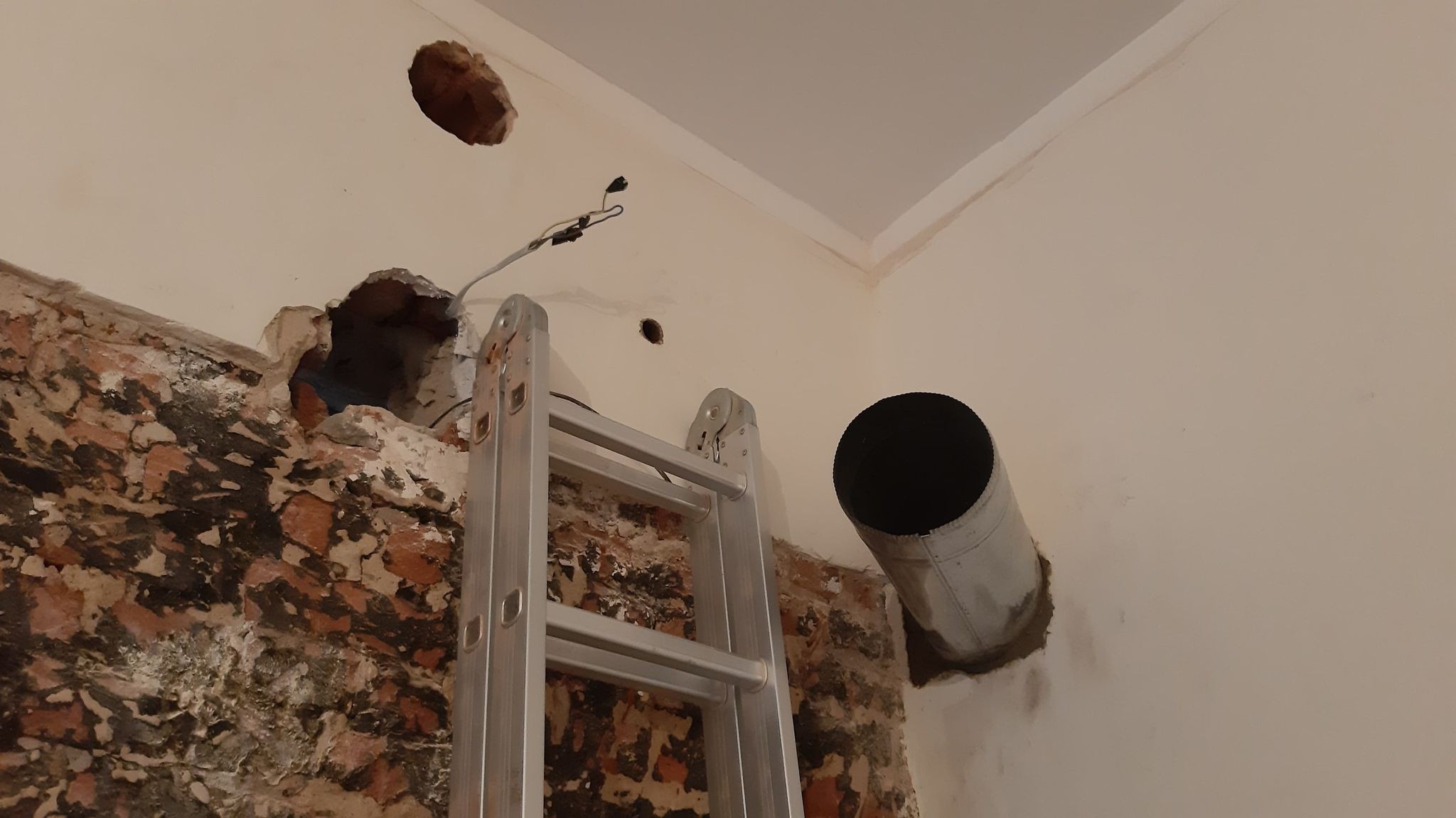

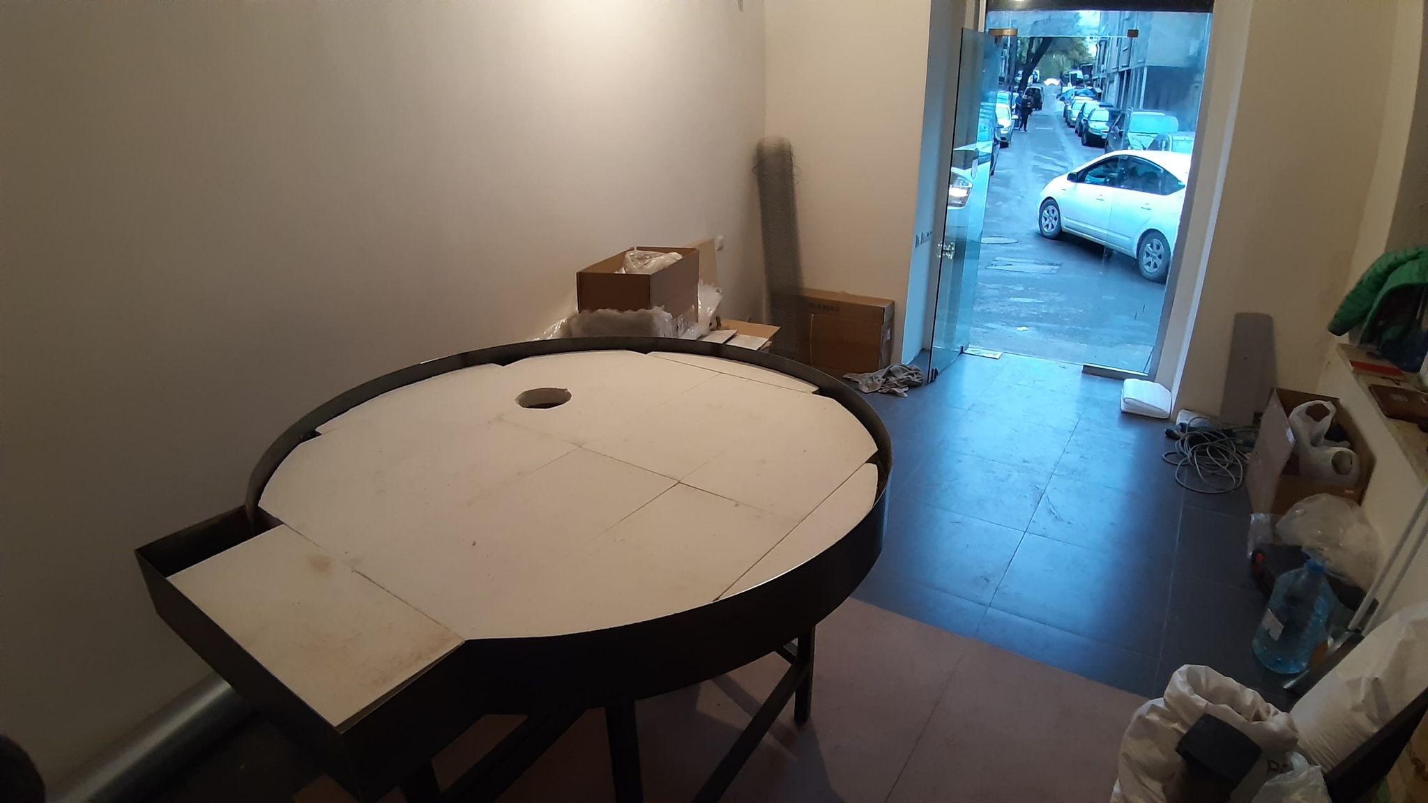

            • #21
              I have also been working on the pipe which is directly connected with the chimney, as well as the air inflow for he oven next to it and the ventilation for the room air. The next step was then cutting the bricks, and preparing the 2nd layer of insulation. Here I used ceramic fibre board, 5cm in thickness, 300kg/m3 density.
              I waited to cut the front end of the floor, since that should be precise. Also because the place I cut the bricks is 45 min away from the location of the oven itself...

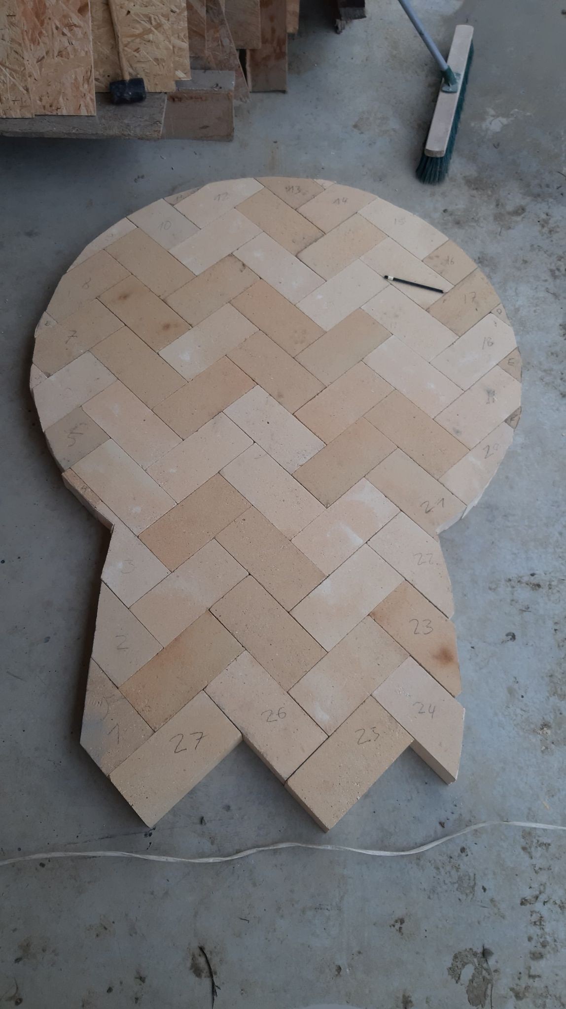

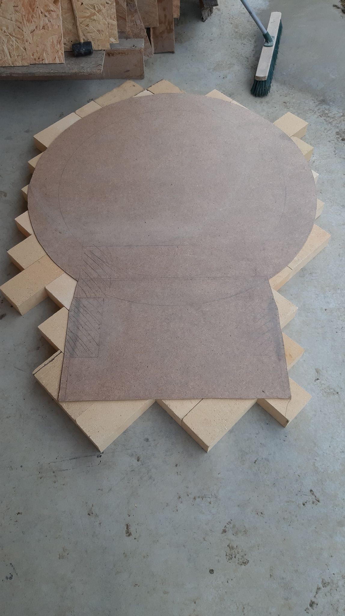

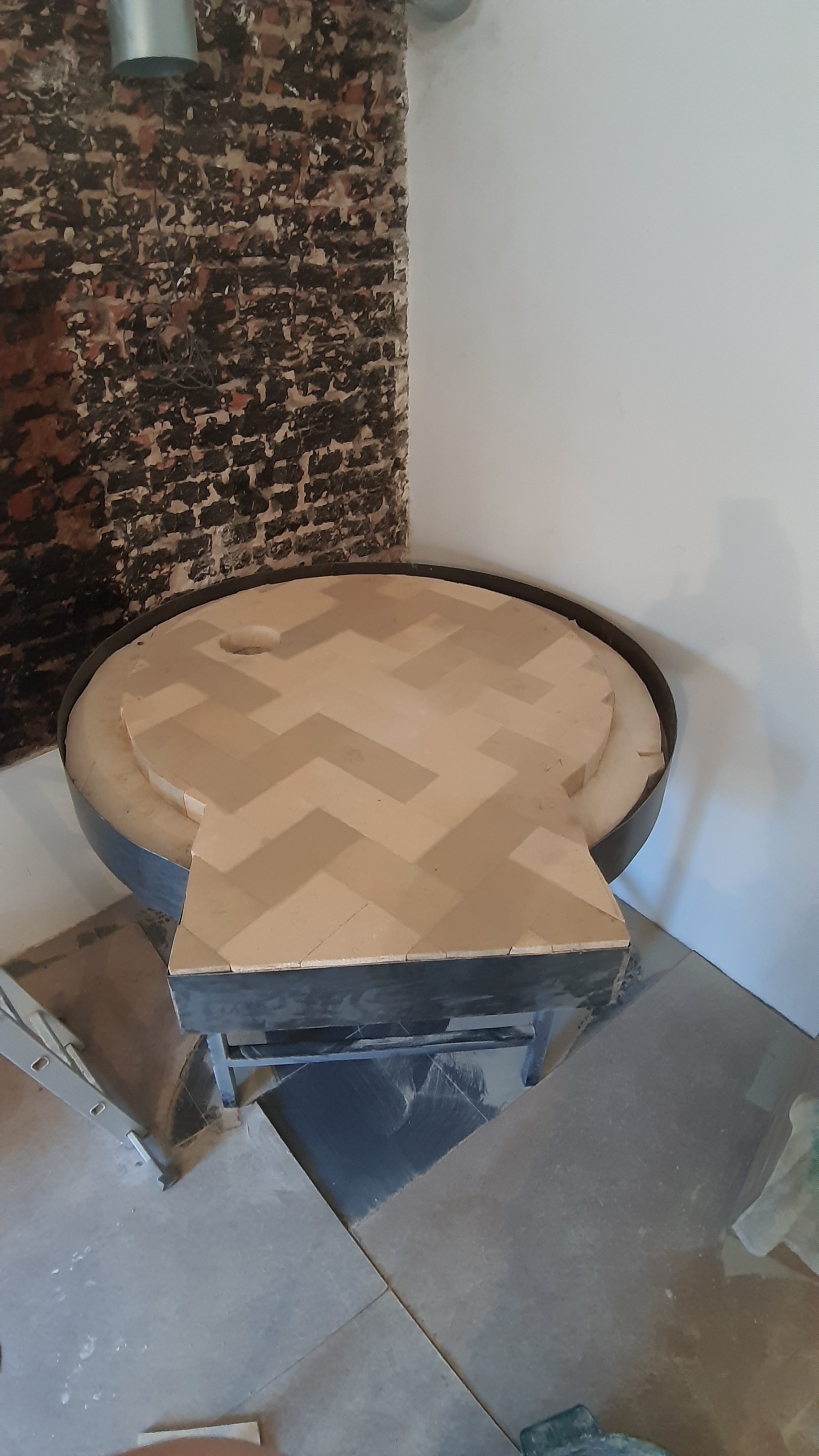

              • #22
                There are a few questions which came up, does anyone have some advice?!
                1. The firbre-boards are not perfectly leveled. Some pieces (also because they are small, due to transportation) the stick out a millimeter here and there. Shall I use sand first, and put the bricks on top of it then?
                2. One of my concerns is, that when I have to lift the oven out and transport it somewhere this might cause an unleveled floor. Is there an option to "glue" the floor together wich high heat mortar? As far as I am informed the floor stones are only laying without any support. Can I improve the stability here somehow?
                3. The cement layer (7:1) is drying very slowly. Its over a week now and I just need to get started. Also some of my firebricks were a bit in the rain. Is that an issue? Or can I solve this with adding a few additional little curing fires once everything is finished?
                4. Originally I planned a low dome, as the post says. I also have made a indispensible tool which is adjustable in lengths, so technically everything is in place. But somehow I am a bit afraid of choosing this version, also it might be even less stable for the future transport? Any hints?
                So far so good. Tomorrow I will put the oven in the final position and then lay the first ring of bricks.

                • #23
                  Can you lightly sand the high spots down in your insulationn manualy, with a sheetrock (dry wall) sanding block first?
                  • #24
                    Thanks for the advice Gulf!
                    I did it with a long knive and cut some overstanding edges slightly. Then I mixed the dust form the cutted bricks with sand 1:1, added water and thought I could evenly distribute it with the trowel which has pinks. But the fibreboard suck up all the water right away, that I only had crumbs which I could not distribute.
                    Can I also use sand only? or nothing instead? I mean the overstand is really never more than 1 mm.
                    thanks for your advice guys!
                    • #25
                      I did not use anything. I placed my floor brick directly on the board insulation. Many have applied dry clay with a knotched trial before placing the floor brick.

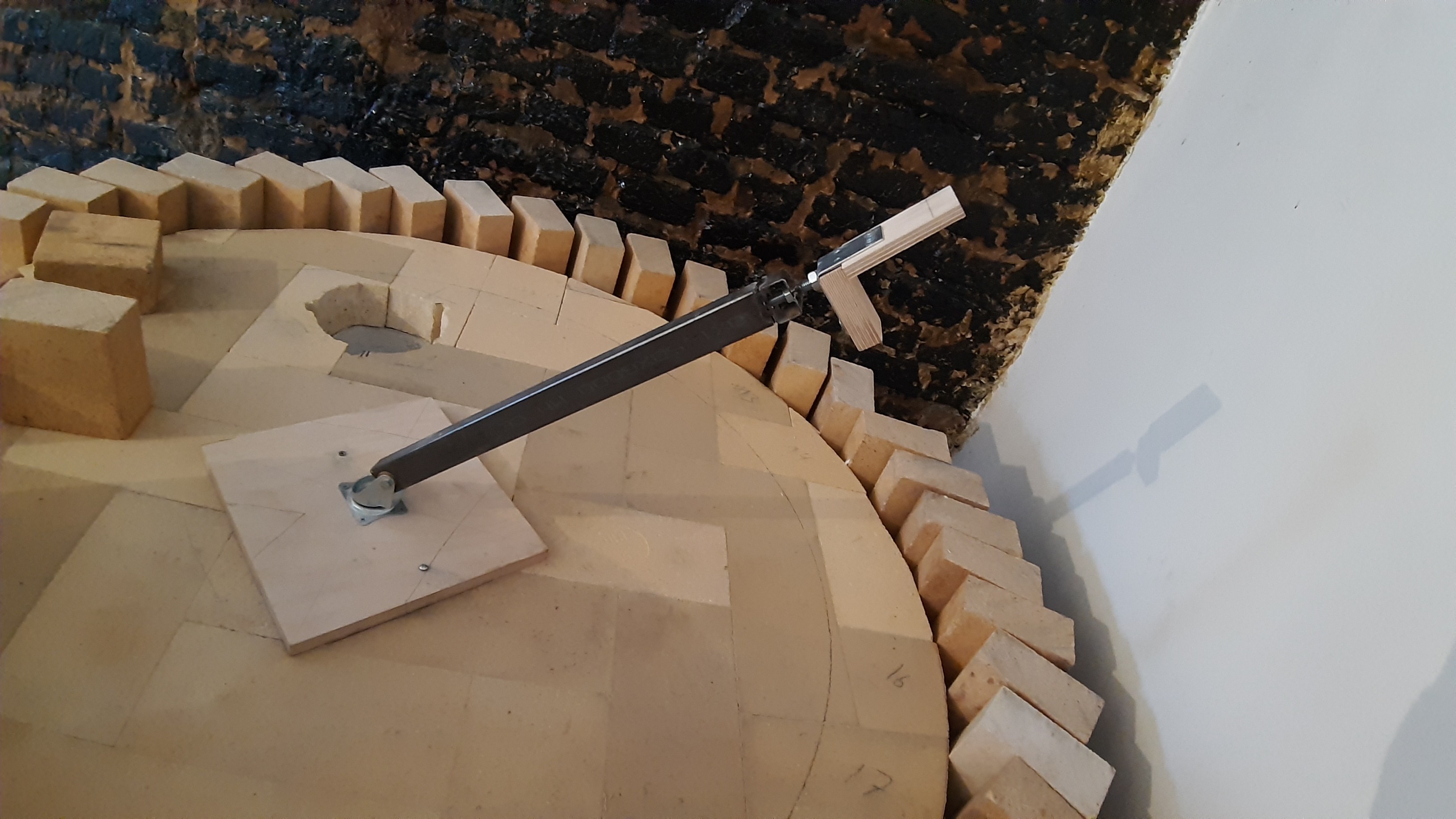

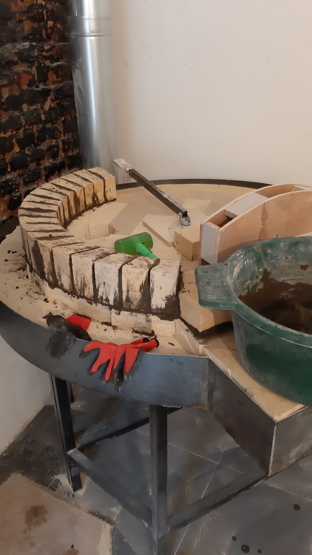

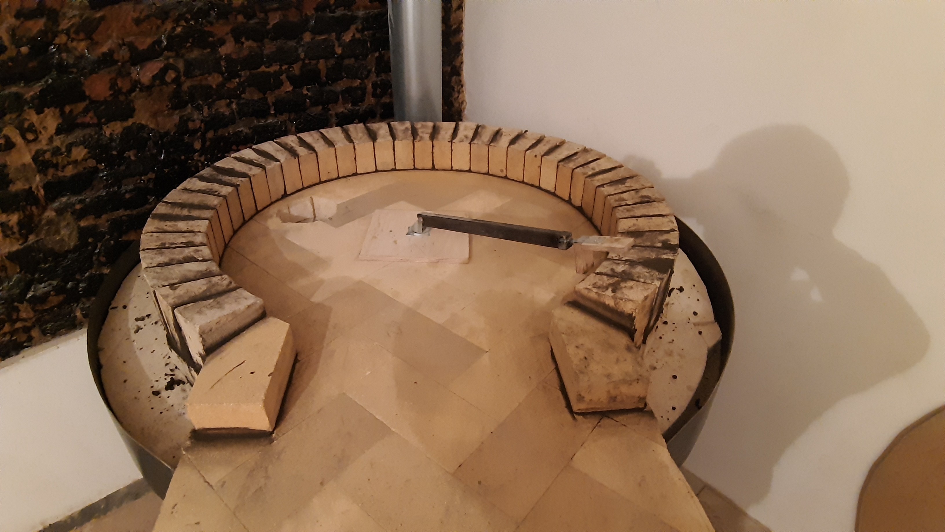

                            Meanwhile some little update from todays progress:
                            Click image for larger version  Name:	20201217_130802.jpg Views:	0 Size:	729.7 KB ID:	433997 Click image for larger version  Name:	IMG-20201219-WA0002.jpeg Views:	0 Size:	324.0 KB ID:	433998 Click image for larger version  Name:	20201219_174557.jpg Views:	0 Size:	718.5 KB ID:	433999 Click image for larger version  Name:	20201218_150843.jpg Views:	0 Size:	739.1 KB ID:	434000

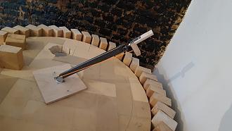

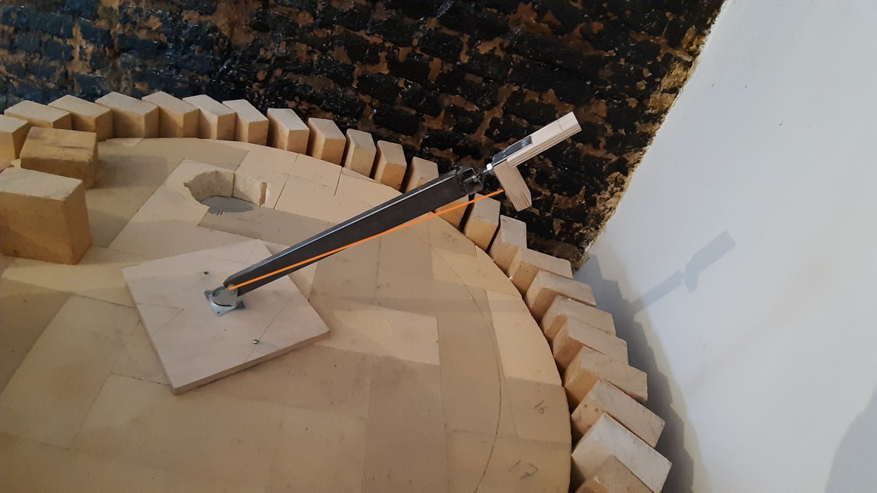

                            • #29
                              Your IT may need a little tweaking. The centerline from the pivot should be directly inline with 1/2 the thickness of the brick. I hope the pic below will explain.
                              Your pivot point is also above finished floor level. That can make the finished dome height a little taller than 1/2 the diameter. To check, compare the measurements of the IT from horizontal to vertical. About the only way to compensate for that is to remove a center floor brick and insert a wooden brick to attach the pivot. I've seen a lot domes built like that. They still cook. But, I just want you to be aware in case you want to adjust things now.
Name:	IT Angle.jpg
                              • #30
                                Hi Gulf, thanks for your eagle eyes!
                                I see the point. Centering the line should not be a big issue. For the bricks I layed so far I guess it does not matter so far, right?
                                Yes, I was also thinking of removing the floor brick, but do not really feel comfortable doing that. I'm afraid that the brick will not fit in properly after that anymore...I mean the plywood I use is about 10mm, the round thing itself another 15-20mm, so I think i'll just accept that. Or shall I shorten the IT every with every round around 2 mm?
                                Maybe you have also noticed, that I somehow made the entry of the steel floor too narrow to put insulation around. On one hand I feel like leaving it so I can see the bricks, on the other hand I am afraid that this will heat up the little room like crazy. I mean adding 5-10 cm in width there in welding some metal would be fairly easy. What do you think?
                                Have a good day!
