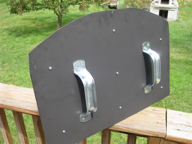

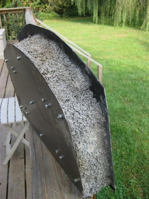

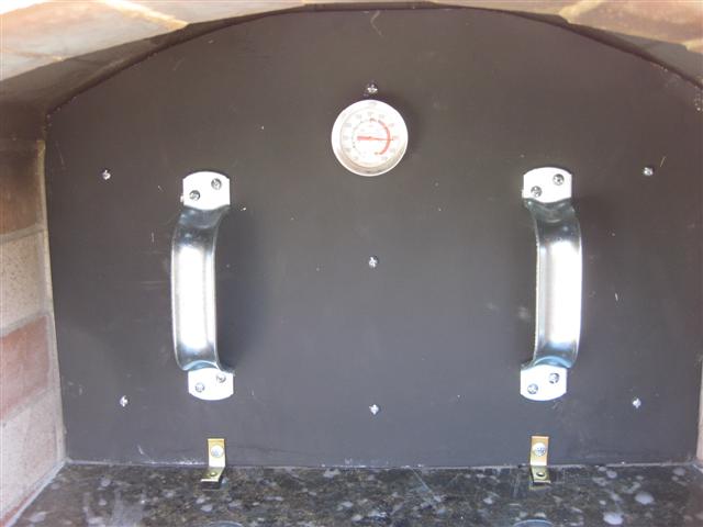

      Re: New Door
      I just built a door for my new oven as well. I made a sandwich of 18 gauge steel and vermicrete.
