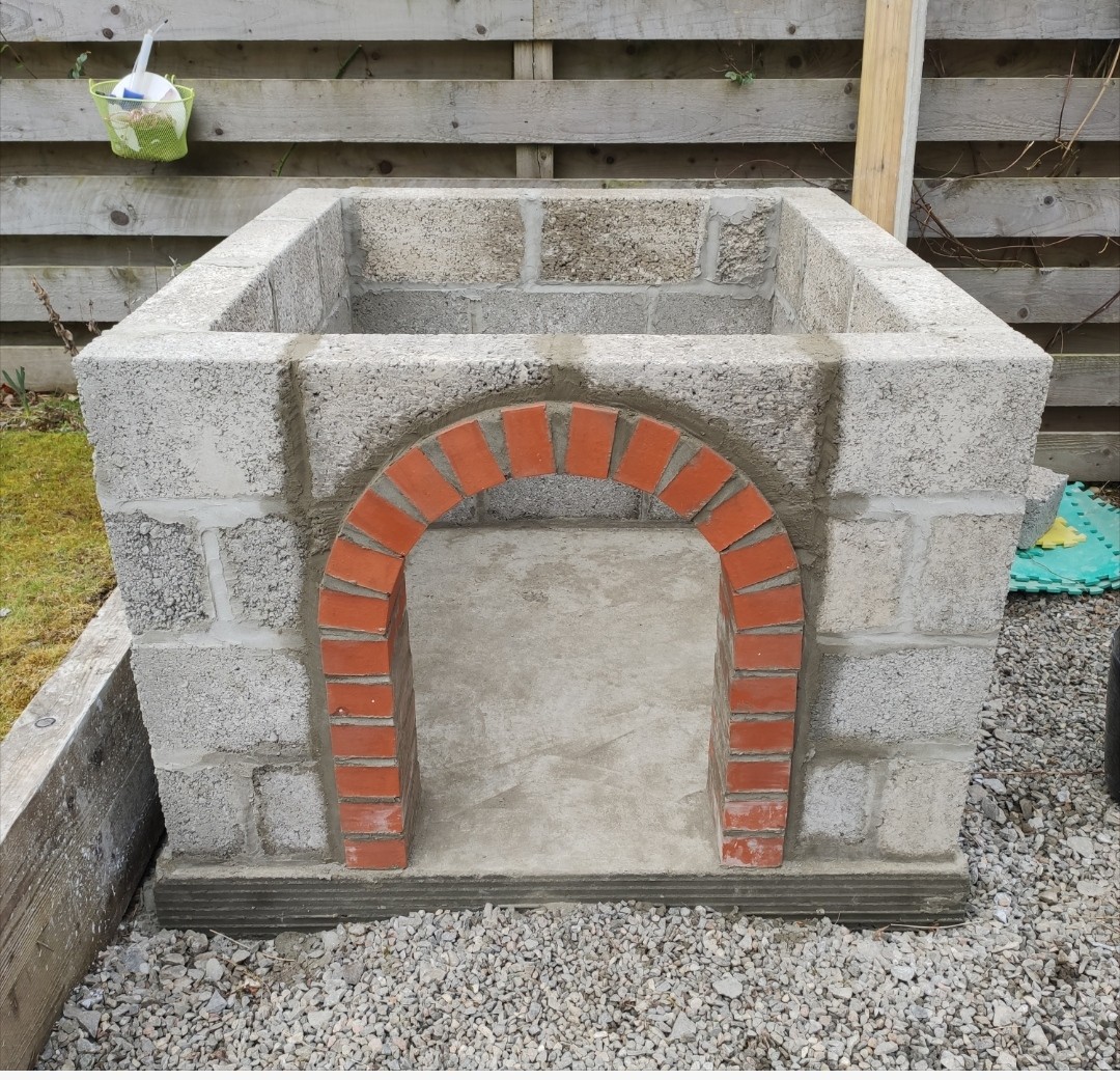

    Baza thanks for the info and support, Canada's a long way from home, but a great choice! On the question of insulation, I was wondering about boosting it a little (I currently have 50mm of ceramic fiber board and was wondering if I could put an inch of kingspan under that. I believe kingspan (also known as Celotex) is rated to 100 C. The question is - is the temp on other side of 50mm ceramic fiber board from brick floor likely to get much higher than 100 C? I could also use rockwool, but it's not structurally ridged, so I would worry about sag in middle of floor. I could use vermiculite, but it's not as good and I have the other options lying around. Any thoughts? Is 50mm ceramic fiber board enough?

    My floor is at 48”. Perfect for us. I’ve worked ovens that were not that high and I hated the bending to look down the throat. My wife is 5’ 7” and she has no issues either.

    JJ - get the height right - for two reasons - workability and heat retention.
    I wish I had added a layer of foam glass under my CalSi board - the extra 3" would have been a nice rise (and thermal support) for the floor. As it is, I'm ok, but not in a position to go back and fix all that now!!
    So - really check the height for workability and lift it in a way that ensures thermal support for the floor ... you don't want heat bleeding out the bottom!
    Looking forward to watching your build!

    I'm pretty sure I saw somewhere that approximately elbow height for the landing is about right.

    That's good to know, we are both a couple of inches shorter than you guys, so height is looking about right at the moment.

    I have mine at 1250mm above paving level and I think that's about right, but then I am 6'2". My wife thinks it's fine and she's 5'4".

    What height do you plan to have the oven floor level at, above floor level?
    It is currently about 1200mm from the floor, which is getting quite high, I think.

    Snowing here at the moment, so progress has slowed even more than the already glacial pace. Pic of where I've got to attached hopefully.

    Mark, thanks for the advice. I will indeed increase my reinforcement and might increase the thickness of the slab (whilst keeping an eye on the final height of the oven floor - my wife is 5'2" so don't want to make it difficult for her to use). Keeping the shuttering in place makes good sense too. I am thinking that a 1:4 (cement : ballast) mix should be strong enough - I think that would be about 30mPa based on a minimal web search.

    Mongo, Thanks for the advice and words of encouragement. As far as the table top slab goes, I am going to have a brick arch at the front of the base, so that will help support and I'll get some bigger rebar to set in and I'll be sorted, and as you've pointed out, the majority of the load is at the edges over the support walls anyway, so I'm feeling more relaxed about that now.

    I have a rough plan (pic attached, hopefully readable), but hope to fill in the detail as I go along, particularly the opening and the chimney.
    My main concern at the moment is casting the tabletop out of concrete. I'm concerned that my rebar is under spec'd (it's about 5mm mesh) and that I'll not use the correct recipe for the mix since it has to span quite a large gap between the supporting walls. I may just go and get some more rebar before I cast it. I'm also wondering how long I should leave the tabletop once it's been cast before removing the form and continuing with the build. Temps here at this time of year are around 10 degrees C.
    I've decided to go for a relatively thin wall (I plan to cut 230x114x76 bricks into three and use the 76 dimension as the thickness) because I wanted a relatively quick heat up time, and then I plan to insulate quite a bit to keep the heat in as much as poss for retained heat cooking. I will probably increase the insulation by about 25mm beyond what's on the plan simply because I've got some loft insulation (rockwool, I think it's know as) lying around, which I will put over the ceramic blanket.
    Anyway, I've started now, so no going back!
    Welcome to the forum JJnevis.
    Like you, I used rockwool over my ceramic blanket and it's worked really well to insulate the oven. Yes, as Mongo has pointed out, your floor reinforcing is light.
    I would recommend min. 10mm or 12mm reinforcing bars, in both directions, in a 150mm grid. I would also comment that 100mm as a slab thickness will work, but 150mm thick will be better! Considering your cold concrete curing conditions, I would recommend fully supporting and bracing your temporary concrete shuttering under the slab for a minimum of one week, preferably two weeks, after the concrete has set. Use min. 25mPa concrete, preferably 35mPa. You can, of course, happily build on top of the slab, providing you keep it supported below. In my case, I left the shuttering in place until nearly the end of the building process.

    A grid of 12mm or equivalent rebar would be better.
    Regarding the amount of weight bearing on the slab, for the center portion of the slab, the only weight bearing on it is the oven floor; the floor insulation and floor firebrick. The weight of the dome as a whole bears on the circumferential footprint of the dome, and a good portion of that footprint is directly over the block walls below the slab.
    If you are using bagged concrete mix for the slab, you can increase it's strength by adding a shovel full of portland cement to the contents of each bag when mixing your slab. You could also add a couple of lengths of steel angle iron across that span. Example, use a diamond blade or abrasive wheel to slice a kerf in the top surface of the block, and slip one leg of a piece of steel angle in to the kerf. The angle will span the opening on the flat, and offer support to the hearth slab. Spanning openings with angle is fairly common in these builds, quite a few builders do it to span the opening in the front wall of the block foundation.
