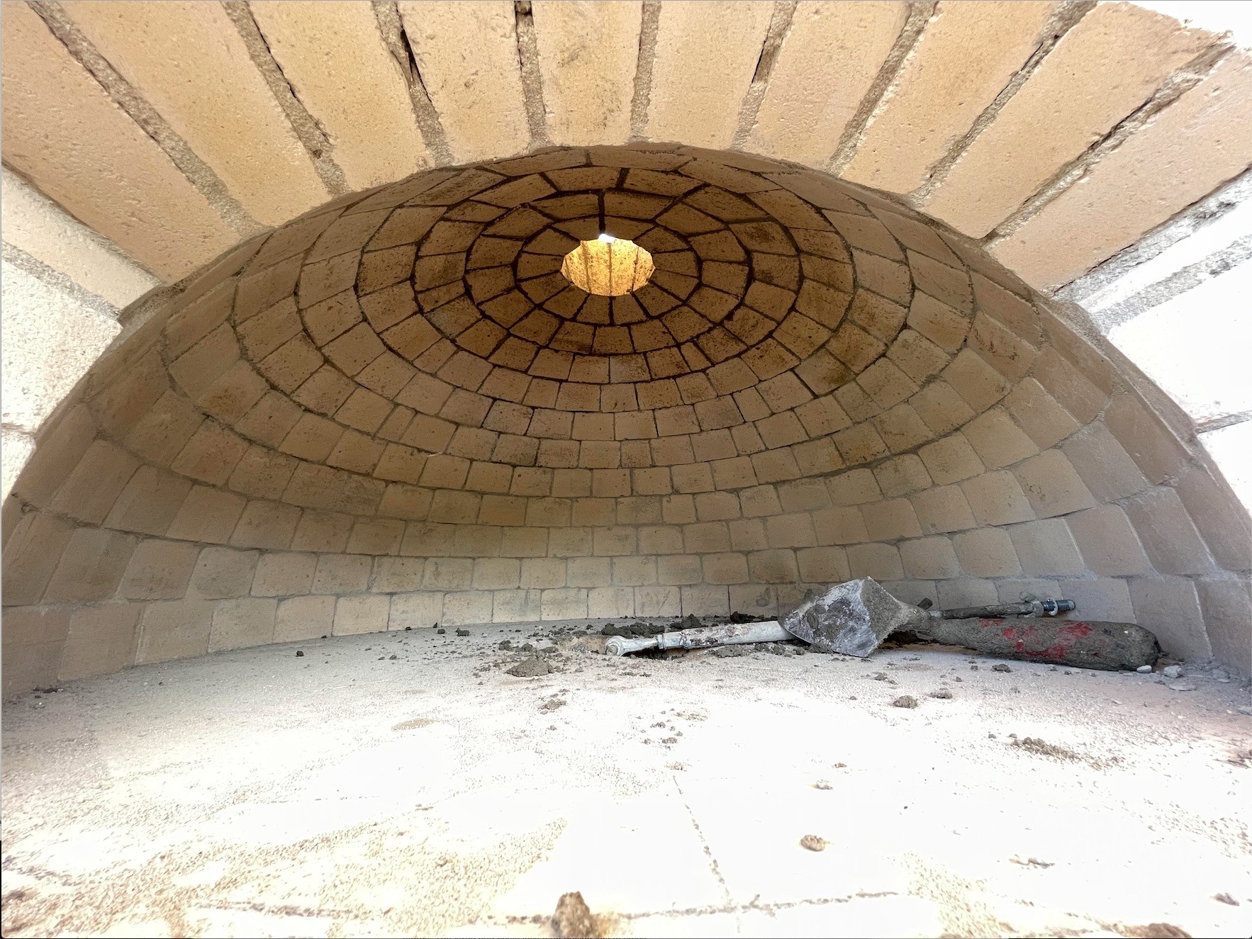

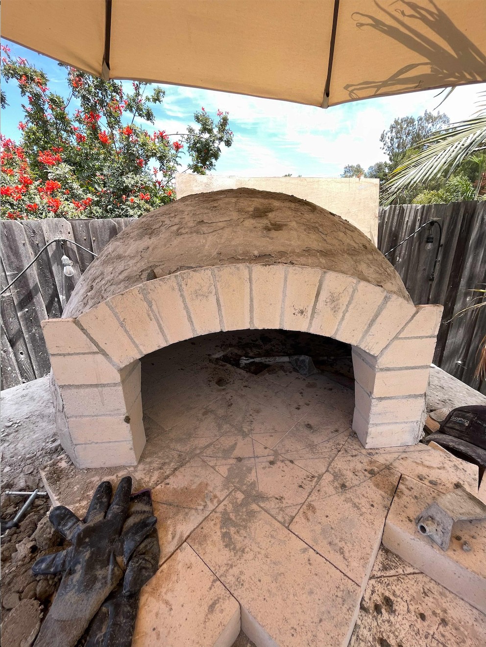

    I've just about closed the dome on my oven and now I'm moving on to the front. I'm deciding if a heatbreak is worth it in my case. Unfortunately I've built the oven in a way where I cannot add a heatbreak to the floor (can't remove bricks to make cuts), however, I can still add one between the inner arch and the start of the gallery. Does it make sense to add a heatbreak here, even though there wont be one at the floor? Adding some pics so you can check out the build so far.

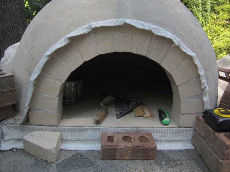

      Adding a thermal break is quite easy to do and not expensive. I always like to use them if you are concerned w/preserving stored heat. If not, they can be left out. However, as was stated, they serve another valuable service as an expansion/control joint, so it's really up to you. Personally, I like to use them and recommend them. My preferred method is using ceramic fiber tape.
      My Build:
