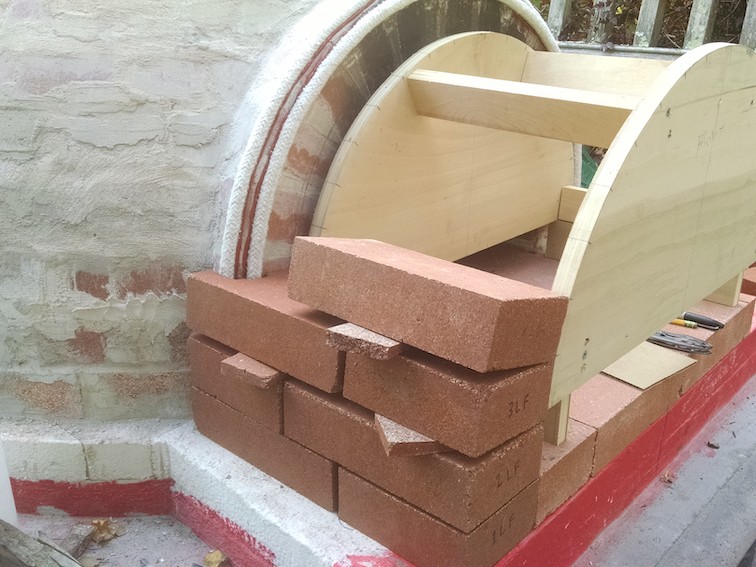

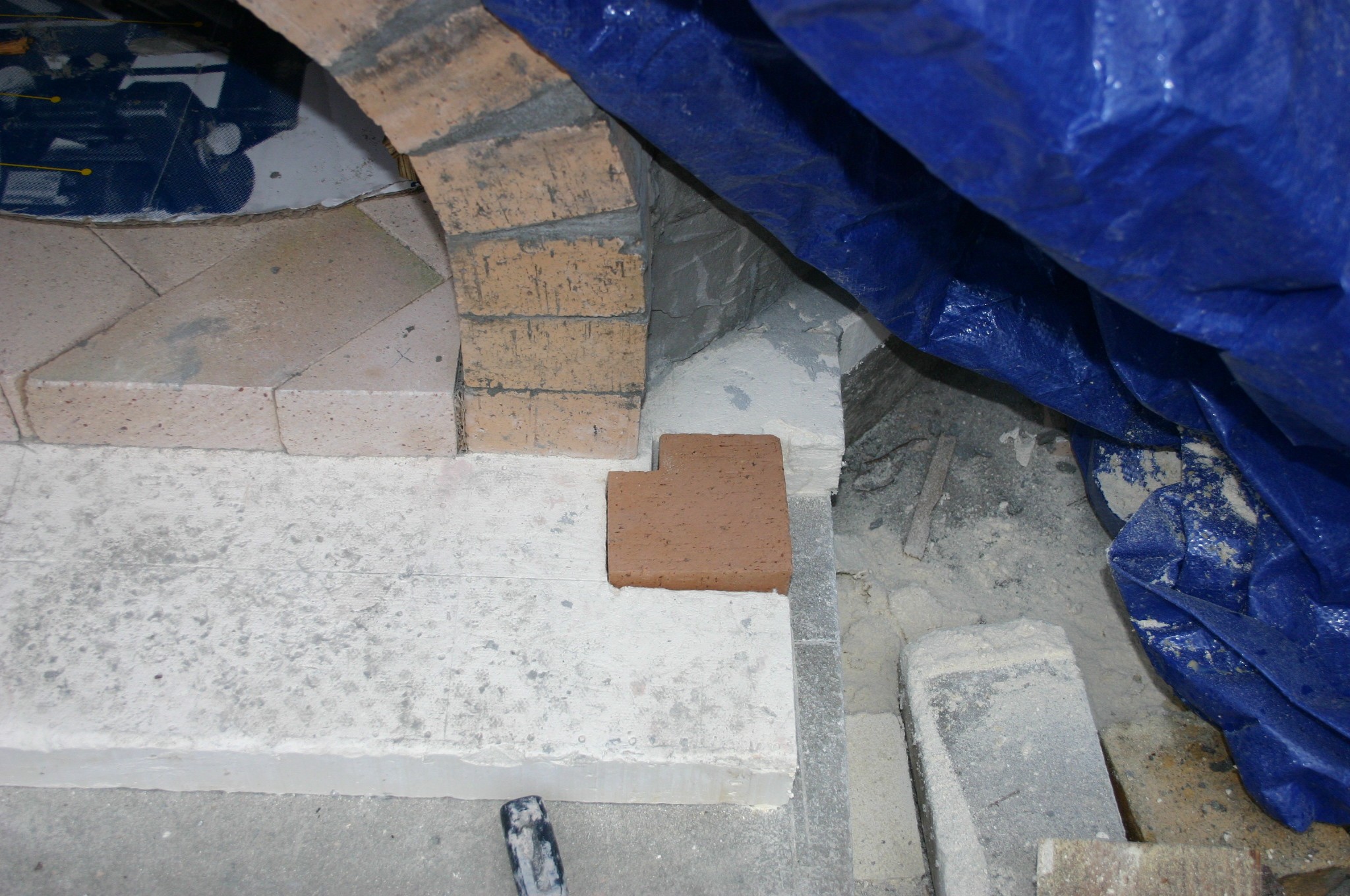

    replied
    Be careful with, what they now call "L shaped brick". If you cut too much meat out of a brick it will be very brittle and prone to breakage. Either before or after they are in service. This is my early addition to heat breaks. Not the final placement. It was placed a little tighter before the actual placement but the bricks were cut the same as the pic. The wider reveal was chosen to accommodate the wider opening that the "flared" entries offered at the time without the intimidations

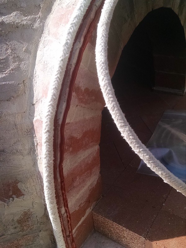

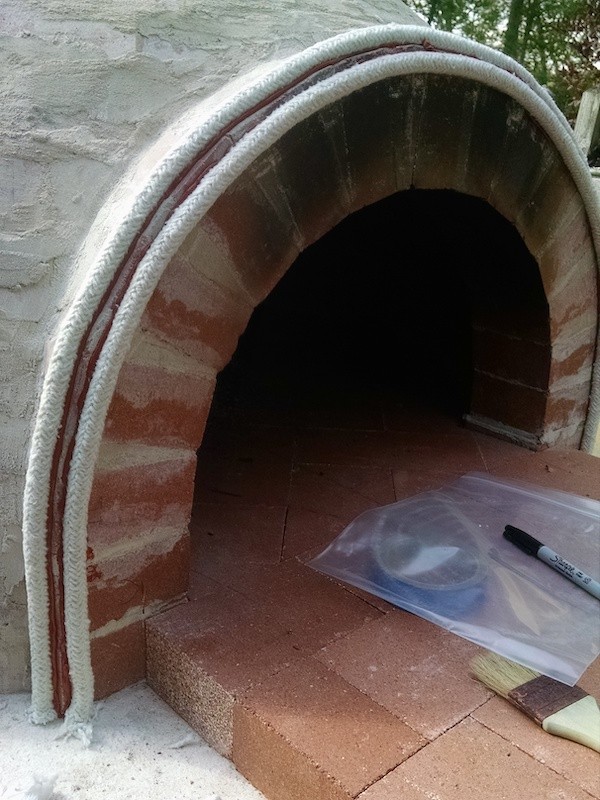

  • mongota
    replied
    I used 1/2" ceramic fiber rope to fill the gap in my break. Two lengths of CF rope to be exact. I adhered it to the brick with a thin bead of high temp silicone. It was fast and easy. I cut the "L" cutout on my tile saw to get repetitive cuts, but used an angle grinder to shape the groove in the faces of the cutout to accept the rope. Also fast and easy.
