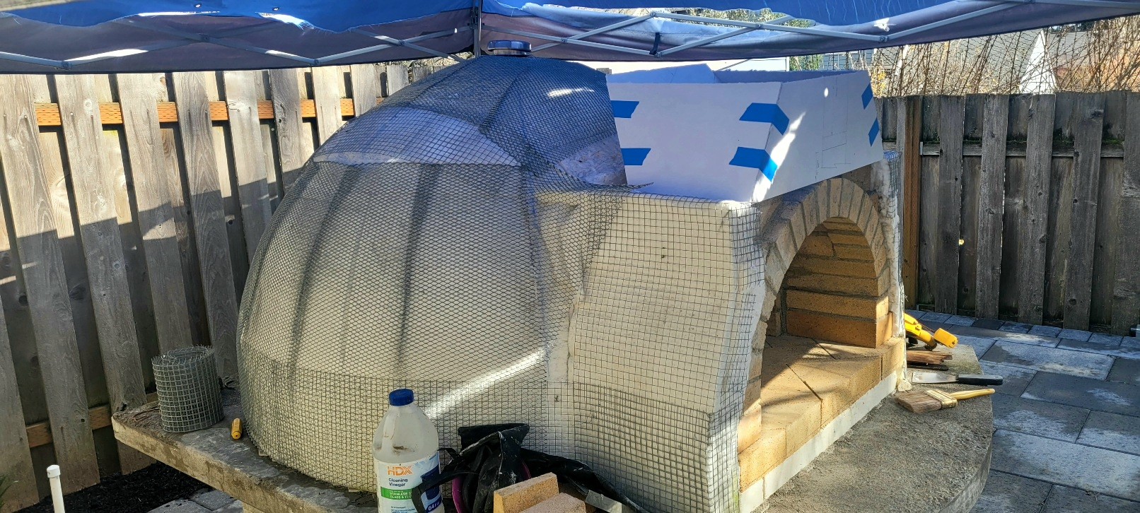

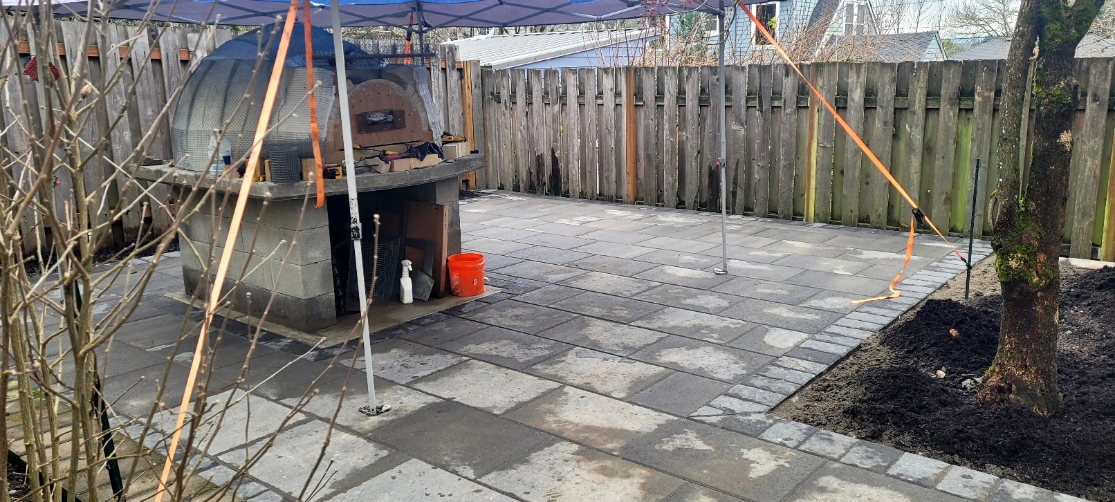

      Hello Fellow Oven builders - long time no chat. I have actually been locked out of my account for months, that password recovery email is not working for me. I decided to try again and luckily was able to guess my password with 5 attempts, so Mac is back!
      I am also not finished with my oven. Here is where things stand:
      1. The dome is finished
      2. The opening arches are completed
      3. I have wrapped the dome and arches with insulation and covered the entire structure with stucco wire lath.
      4. The landscape crew build a beautiful patio around the oven
      Items to do:
      1. Smoke Chamber construction
      2. Curing
      3. Stucco
      4. Chimney
      5. Food prep/service area and permanent cover.

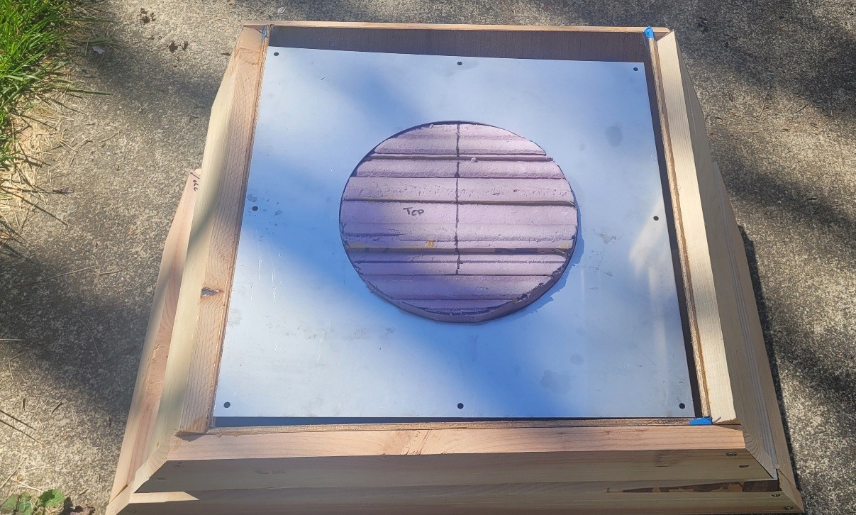

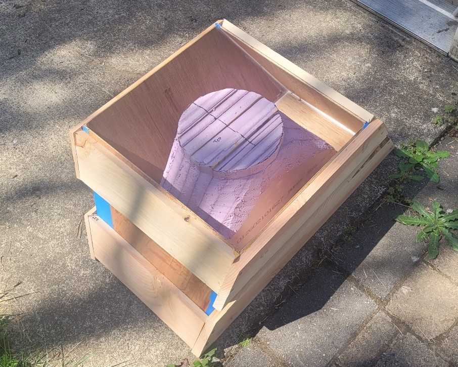

      I couple of questions for the pros:
      1. Should I do the oven curing after adding the smoke box and before applying stucco?
      2. Any special considerations in curing if the build is taking years instead of weeks/months?
      3. My smoke chamber is going to be cast. What are the recommended ratios for a cast smoke chamber?
      Attaching some recent photos. Show, the new patio, a model of the smoke chamber, and the the cast I am building.

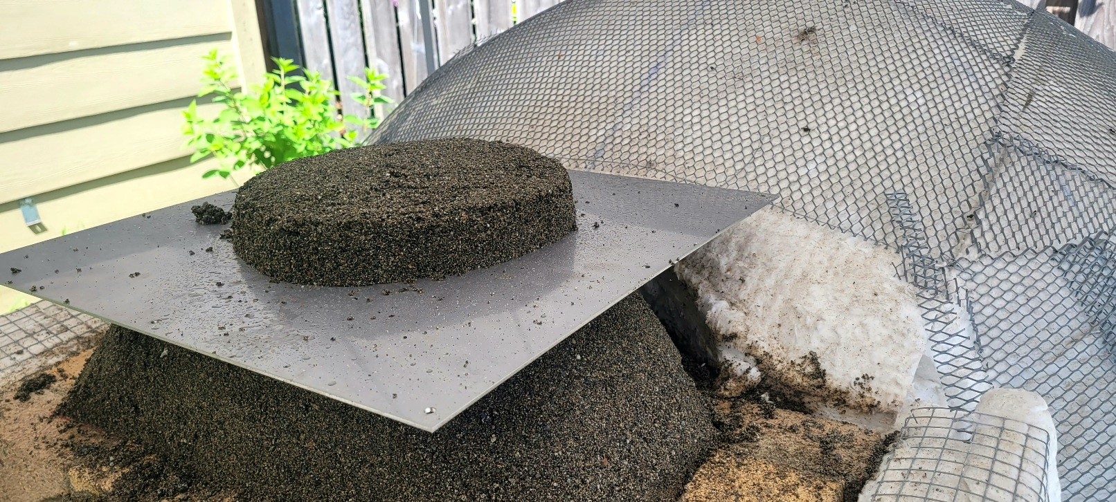

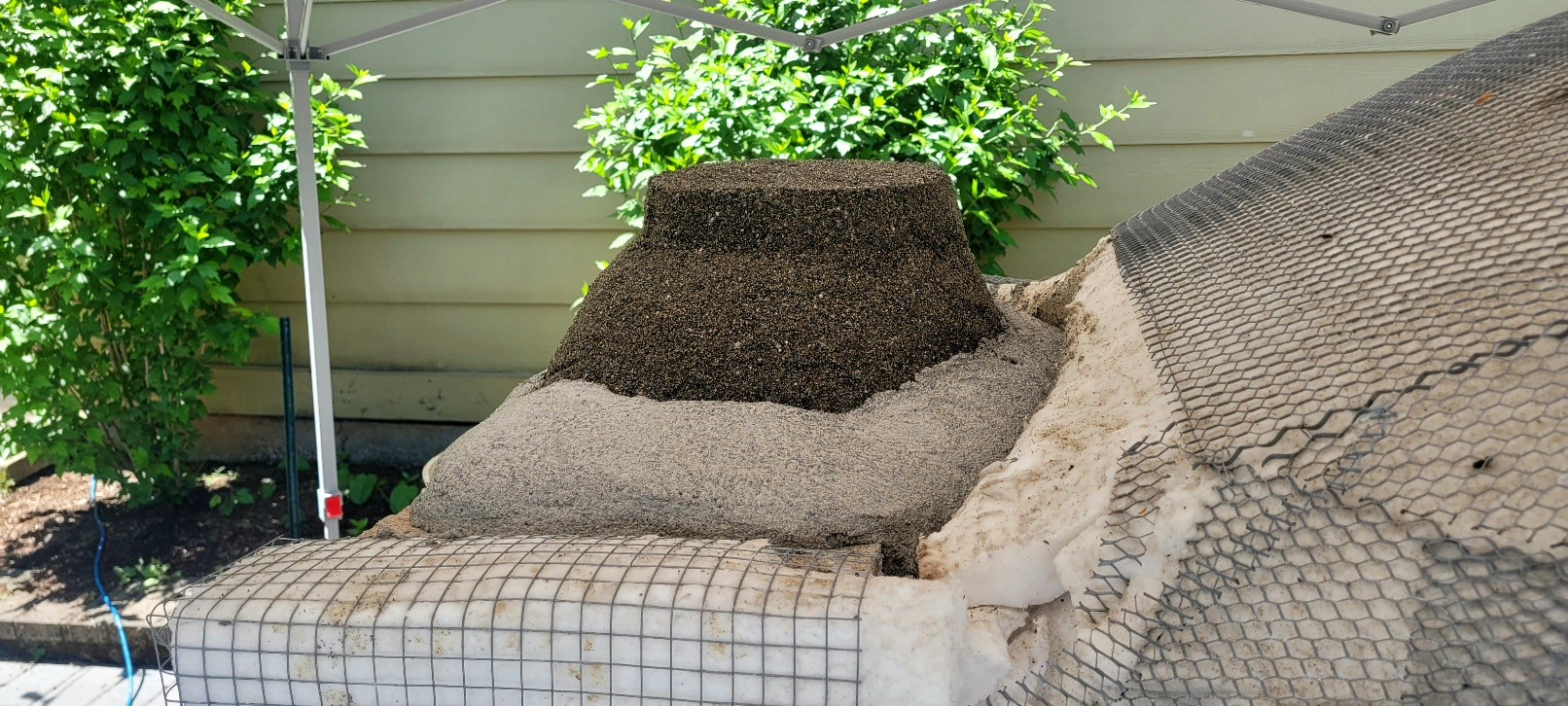

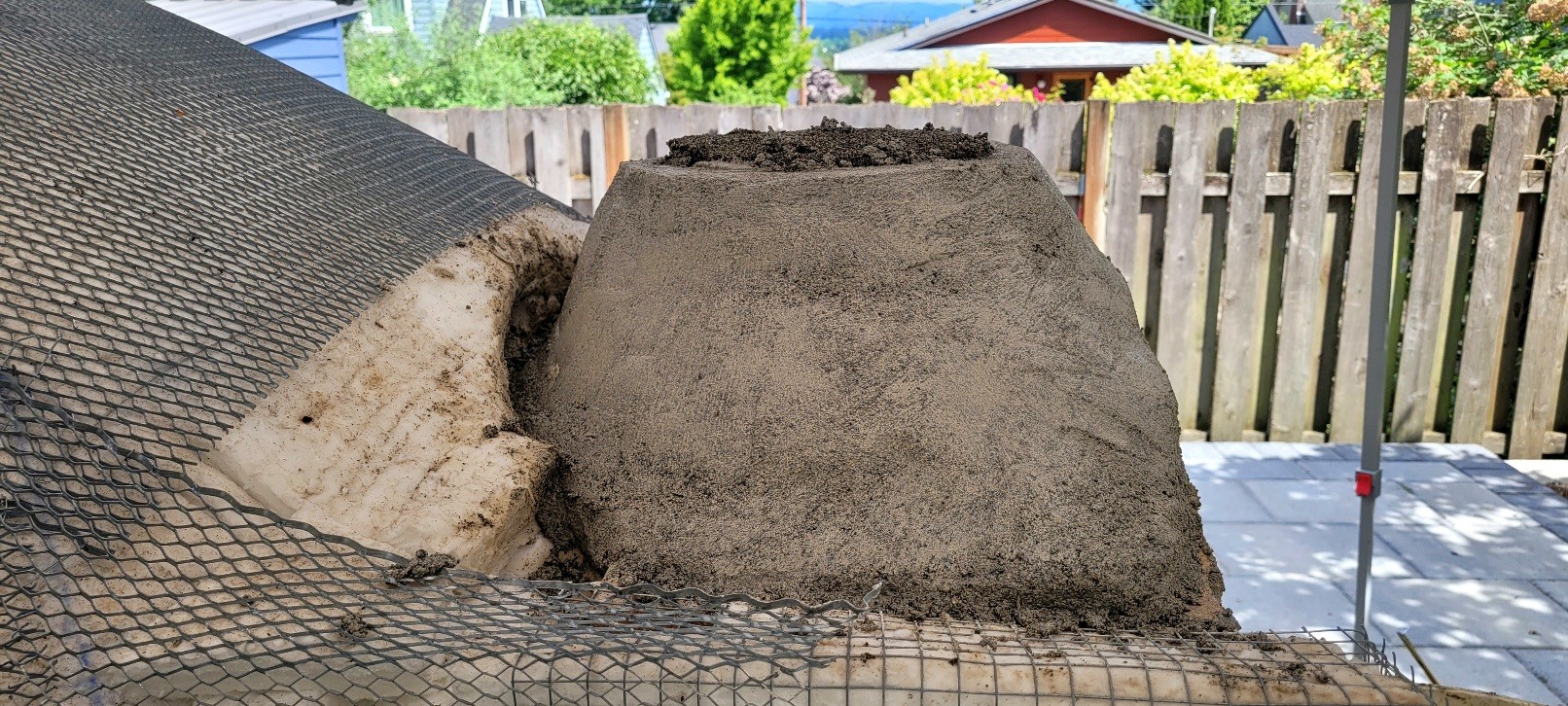

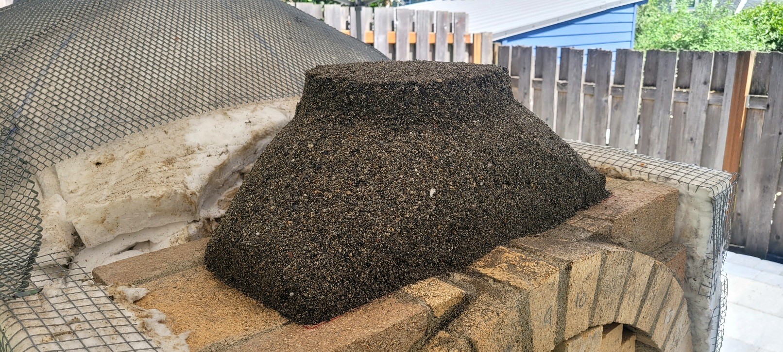

          After reading several posts on castable ovens and the smoke chamber I decided to change directions and use sand to create a mold for the smoke chamber. One of the benefits of changing my mind after starting down a path is I have extra unused materials that find there way into usefulness. In this case a piece of stainless steel that was left over from a prior abandoned effort found usefulness as almost perfectly blocking the underside of the opening for my chimney.
          From there I sculped the sand to roughly match the shape of a Styrofoam model I'd built for the just abandoned form. And then the anchor plate I purchased became a guide for sizing and positioning the base of the chimney. Considering comments on shrinkage I used the anchor plate to provide rough opening size and then added about an 1/8" - 1/4" to the radius.
          Finally, I mixed up some home brew using a ration of 3:.5:1:1 of sand, clay, lime, and concrete. It was pretty warm today, so throughout the process I was misting my work area keep things damp. Built up the concrete around my mold all in one shot. It seems to have gone pretty well! Everything is covered with damp towels now.
          Based on my reading, I will be letting this cure for a couple of days, and then removing the supports under the sand to allow for shrinkage during drying. It's cooling off to the mid-60s for the next few days, should be pretty good weather for slow curing.
          My build thread: https://community.fornobravo.com/for...-pdx-42-update
            • 9211
            #290
            Great job. Because of the very high clay proportion in home-brew I think it is better to halve the amount because clay will impart shrinkage. It is generally recommended not to exceed 7% if added to a standard mortar. This is because of the shrinkage problem. If removed from the mould too early you do risk damaging the cast. If you wait too long the shrinkage becomes more of a problem. The setting and curing is highly temperature dependent so it's difficult to advise when to demoed. For my climate it's about two days, you'll have to be the judge in your situation. You may be able to very carefully remove most of the sand mould from the top to allow free shrinkage of the cast. However, having easily done it a repeat go is simple and cheap and you'll certainly do a better job the second time anyway. Make sure you damp cure it for at least a minimum of a week before proceeding. Good luck.

              #291
              Thanks david s. I recall reading ingredients your post on another thread about the homebrew ratio and based on that I reduced the clay ratio by half (3:1:1:1 down to 3:.5:1:1). I guess that puts me at about 9%. I'm not extremely precise on the mixing so it could be a bit higher or lower. I had to mix a couple batchs and ran out of sand with just a hair less that 3 parts on the final batch.
              Yesterday I was working in relatively warm temps - about 80F, but today we're forecasting a high of 68F with rain, with overcast but dry weather and highs from mid 60s to mid 70s and lows in the mid 40s to mid 50s for the balance of the week. pretty moderate.
              I'll be sure to dampen those towels daily.

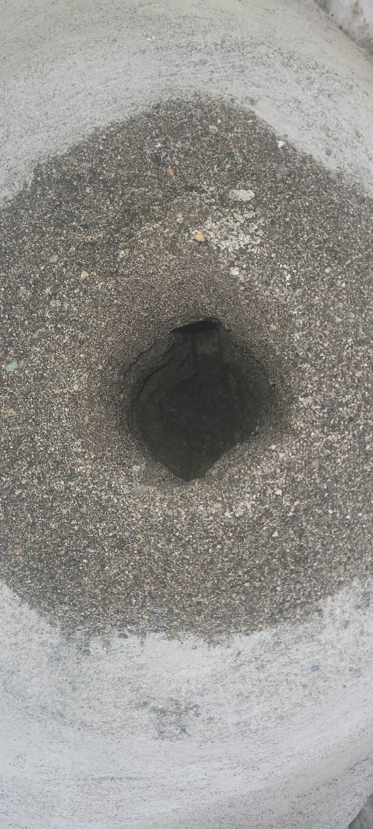

                #292
                I think after a couple days I will use my shop vac to clean out a hollow in the center of the sand mold and a coulple of channels to either side. Perhaps that will continue to provide some support while allowing for compression as the material shrinks.
                • Macrinehart
                  • Jan 2022
                  • 175
                  #293
                  Here's an update - today I used the shop vac to remove mold sand down to the bottom of the sand form, and then created a couple of shallow side channels along the shoulders of the form (no more that 3" on either side).
                  I can tell this is reducing pressure - for instance some small cracks were formed in the sand around the top opening. I think this is having some desired effect, allowing some shrinkage while also maintaining support.
                  I think I will gradually continue to remove material over the next few days.

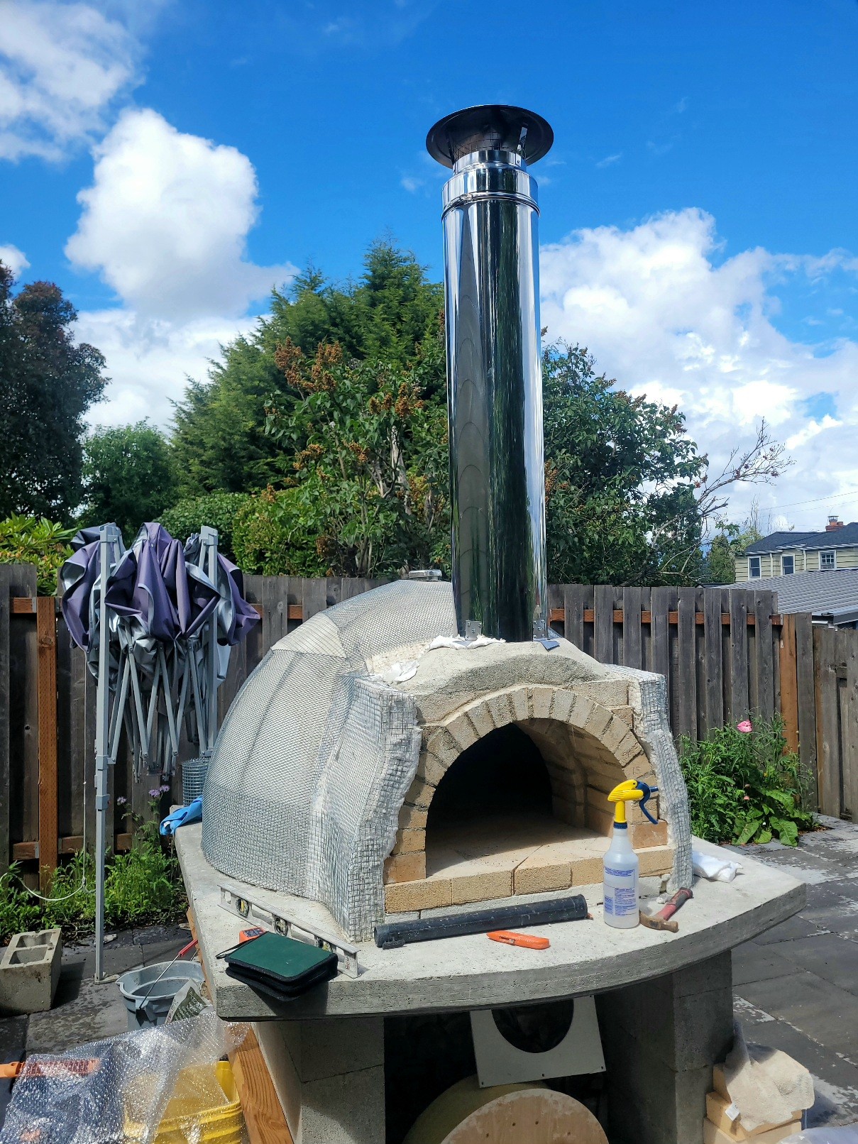

                    #294
                    Today a section of my chimney arrived. I purchased a 4 foot section, double-walled SS pipe, which I understand is recommended size for the oven size I'm building. However, I was surprised at the weight, and realize now that this chimney will be pretty heavy when fully constructed. Given that, I'm having doubts that smoke chamber I built will be strong enough to support it.
                    My plan was to seat the chimney through the opening at the top of the flue gallary, and to fashion a collar around the outside that will rest on top of the smoke chamber. I was then going to use a vermiculite mortar to build up additional support around the base of the chimney, perhaps until about 1-foot is secured. Does this seem like a reasonable approach?
                    david s - my approach follows the drawing you posted, with exception that your drawing appears to be based on a single wall pipe, cutting tabs on the bottom. My plan is to fabricate a collar or tabs from an extra piece of SS Sheet metal I have and screw those into the outer walk of the pipe with sheet metal screws.
                    Considering the weight I will give the castable material another week to dry before I start. Seems like 2 weeks of dry time should do. Thoughts?

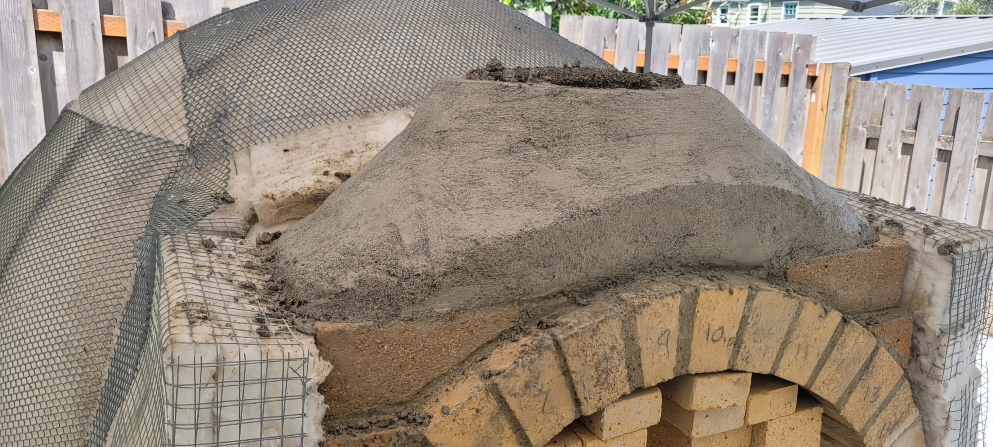

                              #299
                              Hi fellow oven builders!
                              Once again, today, I find myself questions whether to move forward or backward and am seeking advice.
                              I've encountered some issues with the smoke chamber. I built this chamber with a slightly over 10 inch opening in top to accommodate my double walled pipe. Unfortunately, the pipe I purchased has an o.d. of 10.5". So after some thought, I decided, no problem, I will cut down the smoke chamber with my angle grinder to get the right sized opening. This was not a perfect solution.
                              While the new opening is adequate, due to unevenness of the material used to build the chamber, I now have some rather significant gaps between the outer wall of the chimney and the top of the chamber. I think the largest is about 1inch.
                              Perhaps I could mix another batch of cast material and patch this, but I'm not sure about that; I'm concerned that it won't bond well and lead to cracks. I don't need the patch material to support weight, but it will not have any structural support below, so frankly I'm just not sure it will work or even last that long if it does work initially.
                              Another complication is that the double wall chimney pipe is not sealed at the bottom. To seal the pipe, I have to purchase an adapter that converts from 8" double wall to 8" single wall, and this adapter has a tongue that will extend down into the smoke chamber by about 3". I could just cut off the tongue portion, but the manufacturer advises not to as it could impact the seal and allow creosote into interior of the double wall pipe.
                              So, if I go backward, then the plan is to demo the smoke chamber and rebuild it with a slightly over 8" rough opening on top. Then I attach the adapter to the pipe and it can sit on top with just the tongue extending through the opening. What I don't like about this is the lost time.
                              Will the first approach work? Are there other options?

                                • 9211

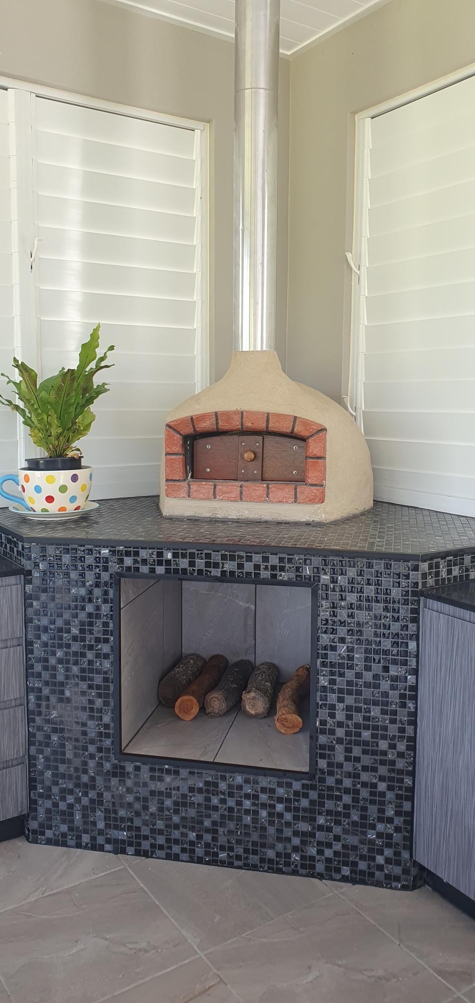

                                #300
                                I don't think I can help you apart from explaining how I do it. My ovens are way smaller and with a double flue setup with inner 5'" and outer 6” pipes. Rather than installing the double flue pipes as one unit, I install the inner pipe as normal first, then slide the outer one over the inner one from the top, then tucking some blanket between inner and outer pipes at the top. Then securing the outer pipe with a custom made bracket to the roof supports and a Dektite seal between outer pipe and roofing.
                                Click image for larger version  Name:	Jason Tsoumbris .jpg Views:	0 Size:	301.8 KB ID:	471451
