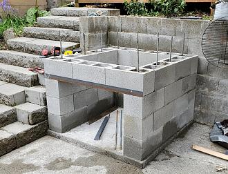

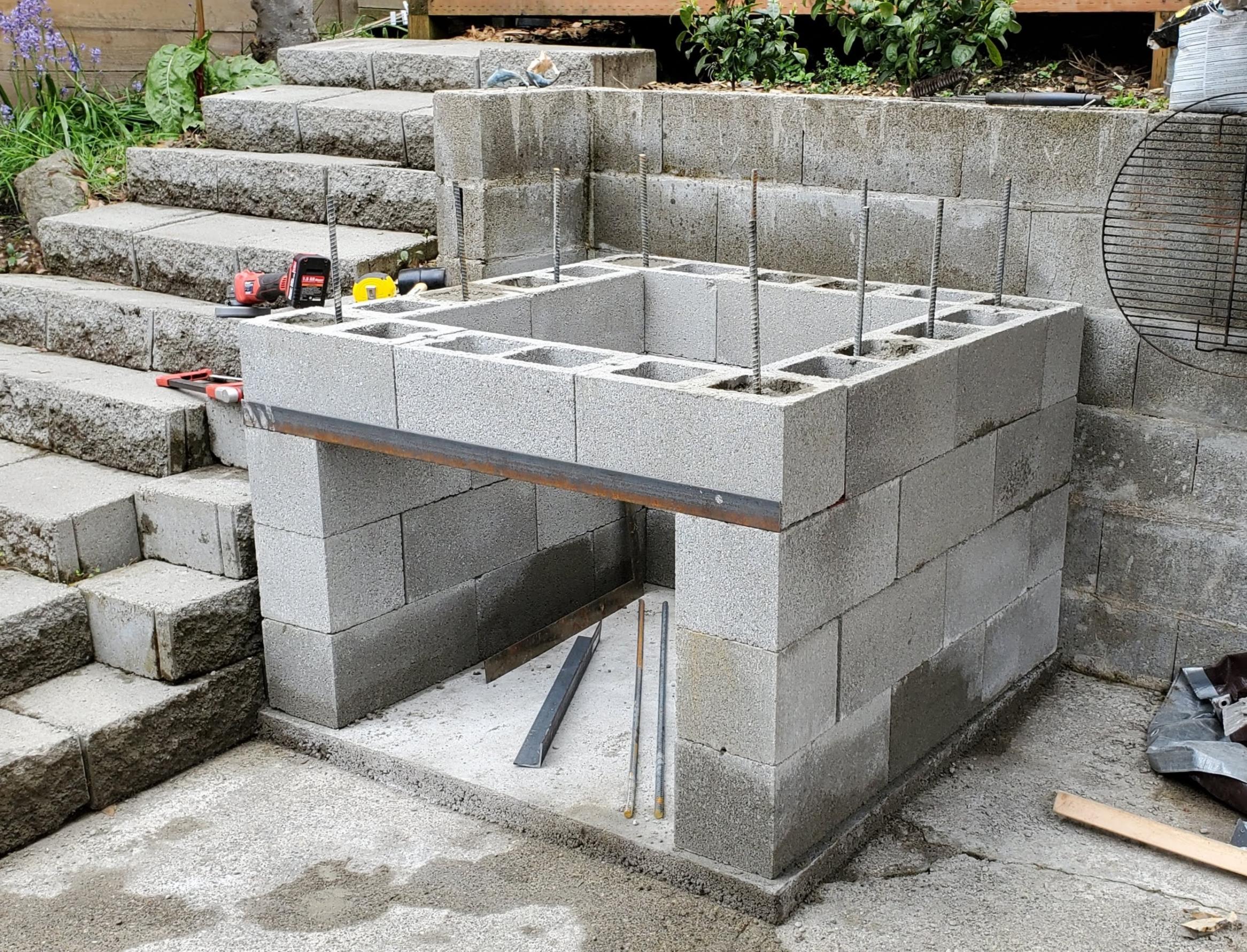

      Building of the stand is underway!
      I already have a concrete slab where I want the oven but decided to pour another 2-3" of reinforced concrete to make it level. On top of that I have dry stacked concrete blocks. Still need another angle iron - Lowe's only had one left near me.
      Looking forward to pouring concrete into the blocks this weekend if weather permits.

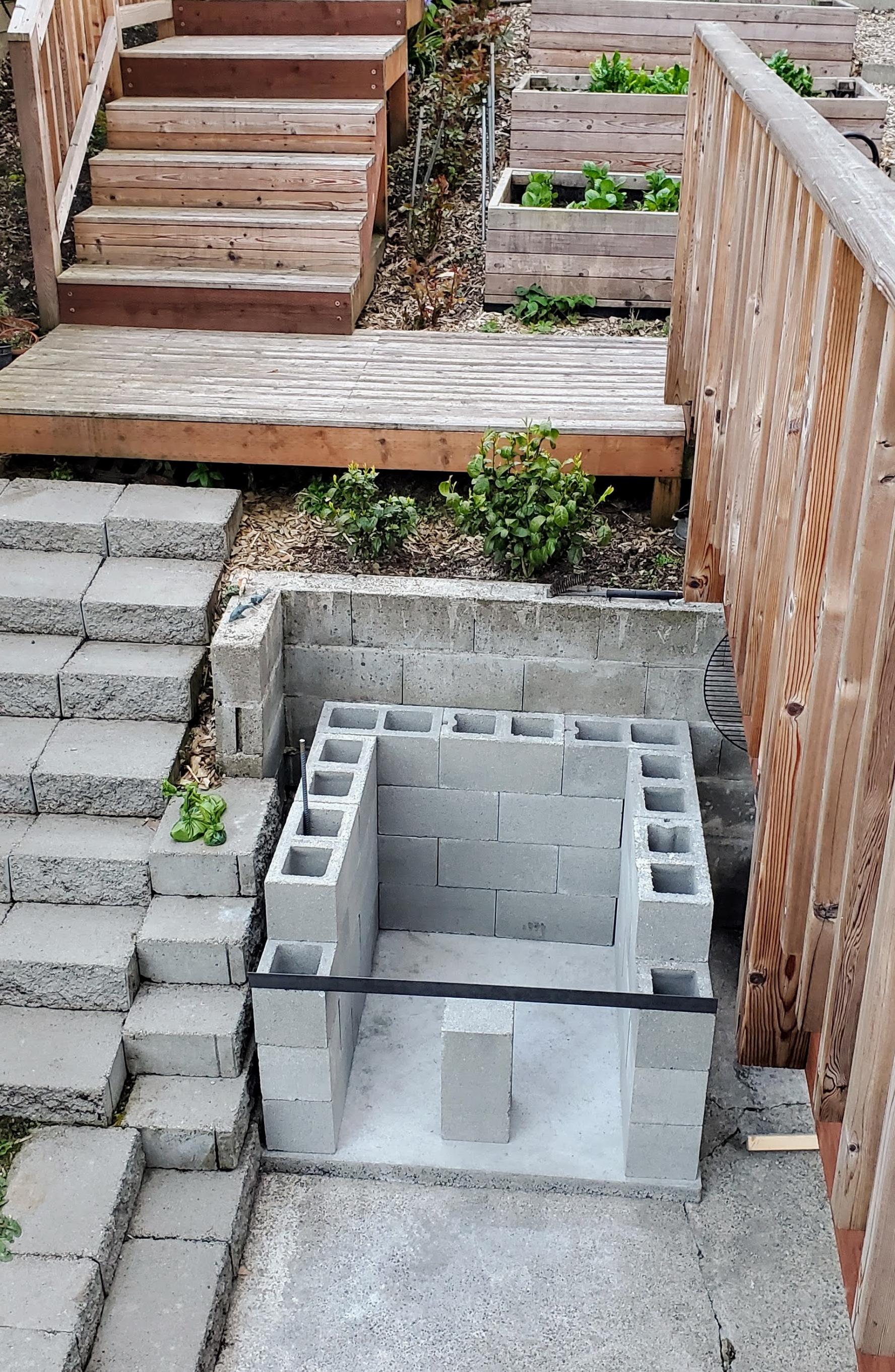

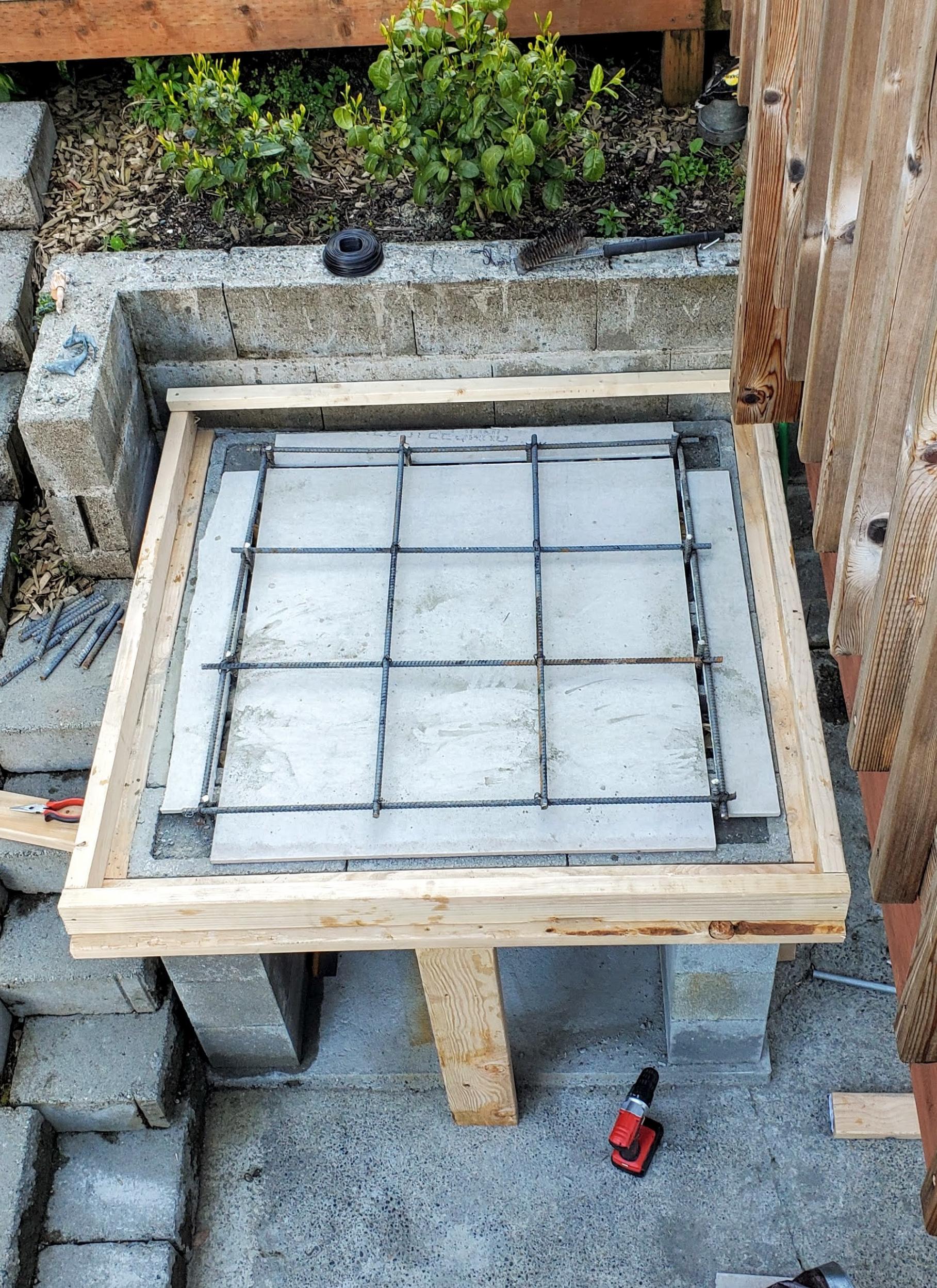

            More progress on the oven from the past two weekends.
            Stand is complete and the mold for the hearth has been completed. Awaiting a nice day without rain to mix and pour the concrete for the hearth. After that the fun part of building the actual oven component can begin!

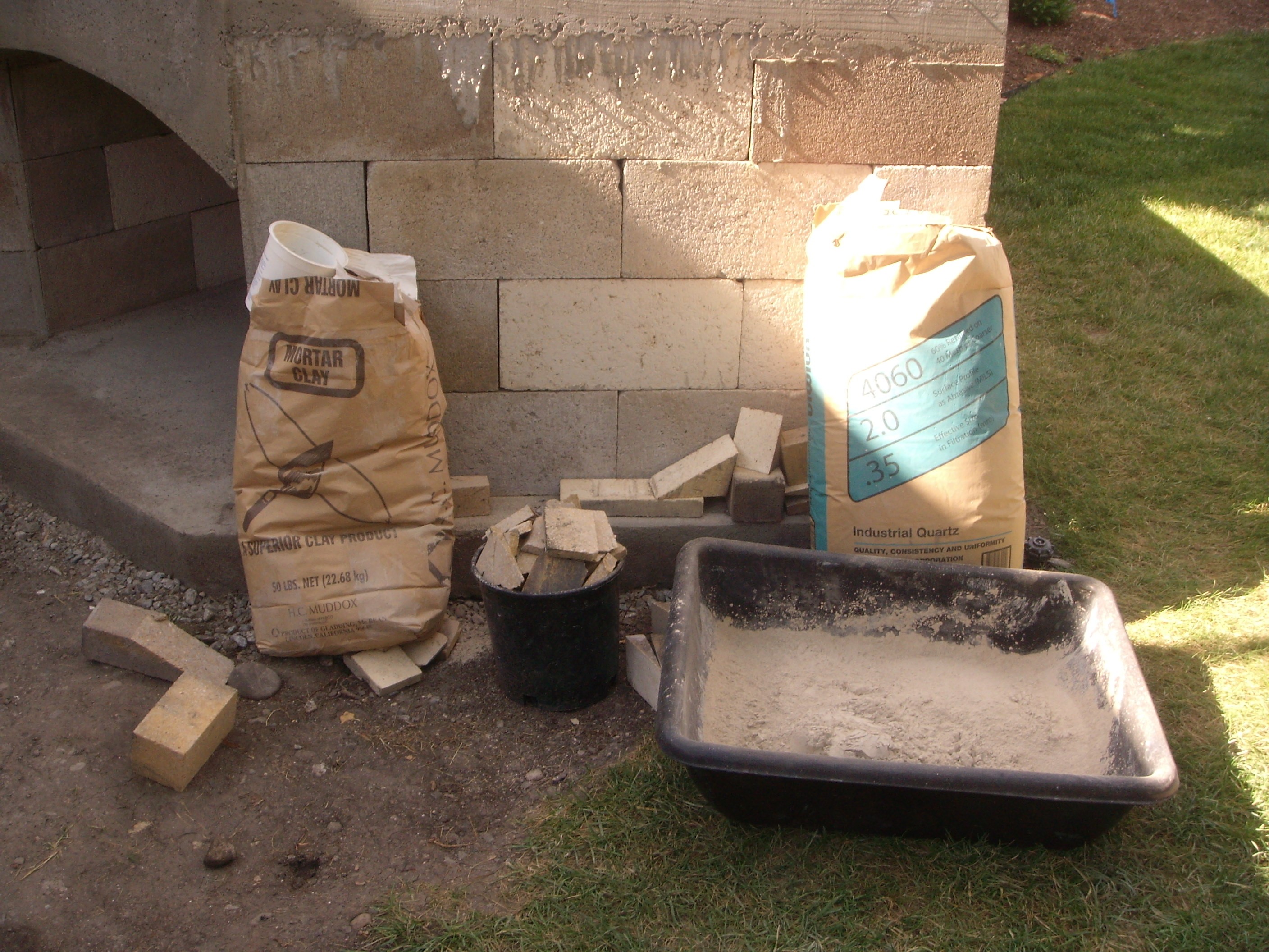

              On the topic of fire clay - does it go by any other name? I am unable to find any at the big box stores (Lowe's and Home Depot) in Seattle. Worst case, I might have to settle for refractory mortar mix which is more expensive.
              When setting the floor of the oven on top of the CalSil insulation board the Forno Bravo guide suggests using a mix of sand and fire clay under the floor bricks. Is there any other combination of materials that would work in the absence of fire clay?

                You can search also for Bricklayers Clay. If that draws a blank try Ball Clay from pottery or ceramics suppliers. Some folk have just used fine sand as a leveller. I think the clay/ sand mix produces less movement under the bricks because the clay, being finer , fills the spaces between the grains of sand.

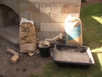

                  You need to go to a masonary/brick supplier for brickie clay. HC Muddox is a brand available in the US and inexpensive.
Name:	30 Fireclay and Sand Bed 5.30.12.JPG

                    I got my fireclay at Mutual Materials - they have a store in South Seattle. Got my bricks from them too.

                      JRPizza: I called Mutual Materials and they had fireclay! Thanks for the tip.

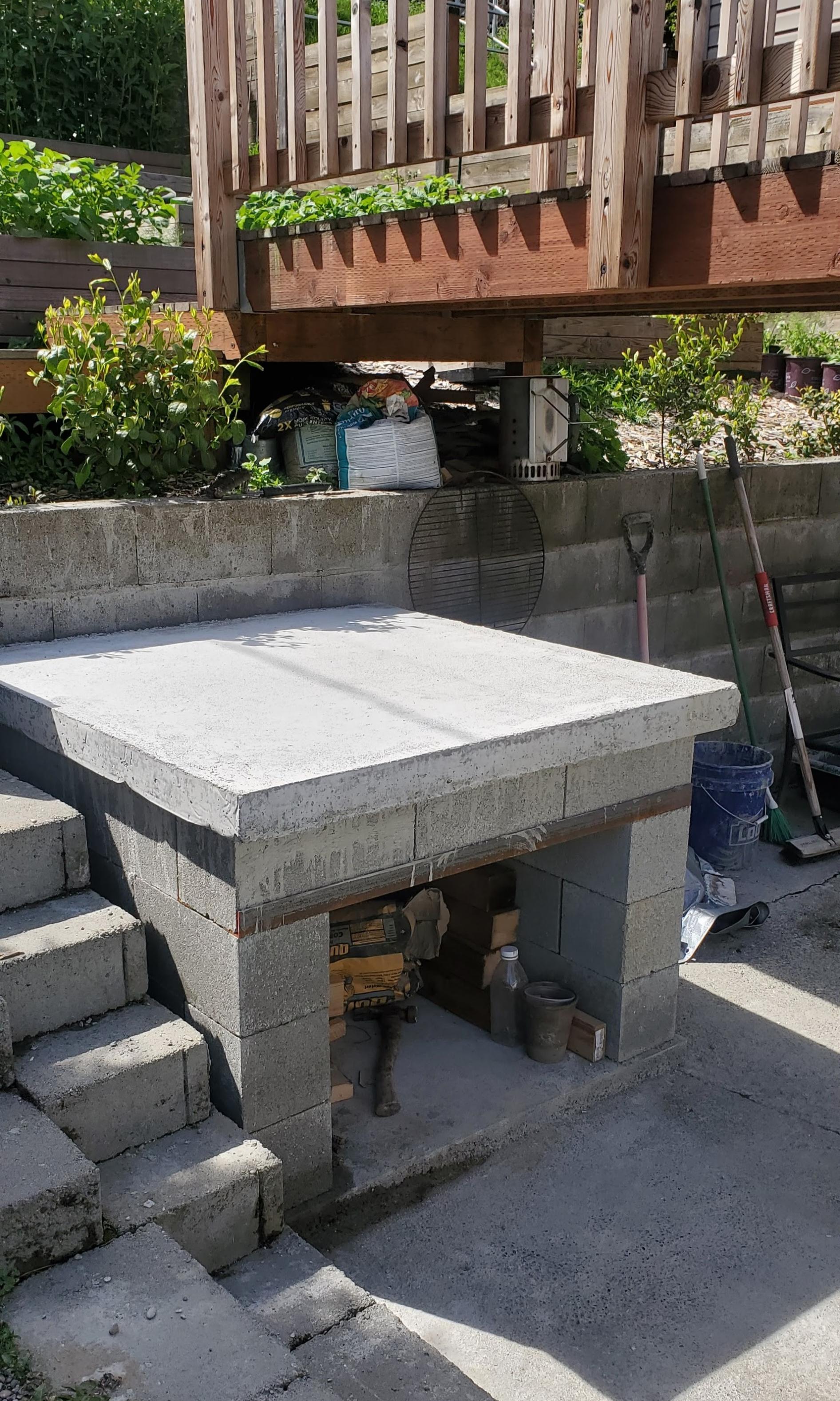

                      Latest progress includes the hearth being finished. Came out pretty good I think considering this is the first project I've worked on that includes pouring concrete. Next up I will revisit my oven design with a few minor updates and prep for building the dome starting second half of June I hope.
